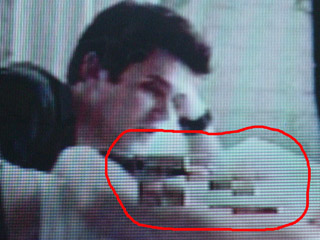

    This is a sample of the artifacts:
    I get it using a Vitec DCM MPEG2 Capture Board connected to a VHS.
    Regards,
    Jose Febus
  7. I've had that problem!
    GOP is irrelivant.
    Your are suffering from a combination of jitter, video level and sync problems.
    VHS is a pig to author from!
    You can cure this with a TBC (Time Base Corrector), expensive.
    I overcame it cheaply with a Video Tape Copy Box!
    Get a LEK-CPDVD2 under £40 UK

    I am getting the error when capturing TV using the VCR connected to my Capture Card! Do you think it's a bad idea?
    I will try using a DVD player as a source!
    Thanks a lot!
    Jose Febus

  11. Great idea that will prove if it is VHS problem.
    Make sure you use a non copy/macro protected disc though!
    Feb 2001
    Macondo, Puerto Rico
    The previous picture was capturing from cable tv using my VCR as a passtrought device to get the video to my Capture Card. Do you think that I need another piece of hardware between the VCR and Capture Card so the Cable Signal can be captured perfectly?
    Thanks,
    Jose
    Jose Febus
  13. Your idea of trying a capture from DVD is excellent, try that first.
    You need to prove if it is a signal problem or capture problem first.
