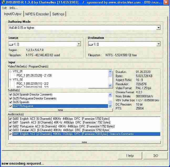

    PART 5-DVD2DVDr
    There are a few settings in DVD2DVDr which you must change, but not many. But lets start with the first page.
    Right in the input selection choose your route drive as the input drive,then choose the main film vts, in the case of Shrek its vts_1. If you get a box about mutiangles choose the first angle. As for everything else, leave it as in the picture.
    Right I aint going to bother explaining all of this, just one or two things. Go to your VIDEO_TS folder and select all the files apart from the main movie files, right click and see what size they are. Take note of this, add about 10megs and put this in the MB reserved box in DVD2DVDr. Also while you can change the max and min bitrates, the avg birate will be calcualted automatically for you.
