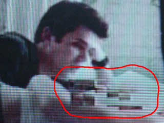

Hi Nelson37,
This is a photo I took from the TV showing the artifacts.
Both capture and encoding processes were using the same settings.
Regards,Jose Febus -
This looks more like data loss on the disk rather than an encoding problem. Since one player does play correctly, I would guess the other player is more media sensitive.
Note that using the same settings on two different programs DOES NOT guarantee the same output, different progs will use different methods to arrive at something close to what you specify. For real-time capture, this is especially important. -
