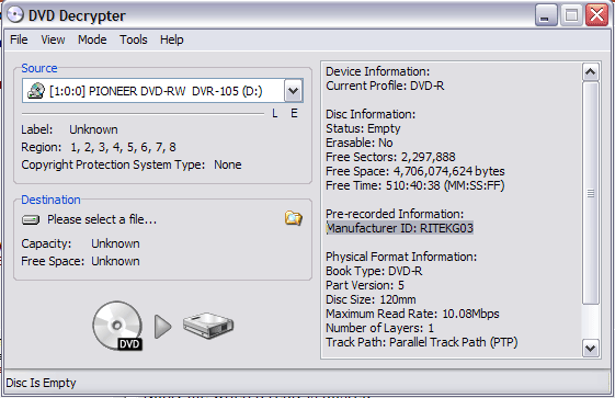

    Interesting Topic here. I am not too sure how Nero CDspeed recognize the manufacture ID on the media. But I have been using DVDdecrypter to do verification on the manufacture code. So far all the disc i purchase from http://www.supermediastore.com & Http://www.shop4thech.com has been perfect. No problem at all.
    I have pretty good experience with both store and have been purchasing from them since last christmas So far all the RitekG03 are coming out of of the dvddecrypter as the following
    Manufacturer ID: RITEKG03
    I really don't think they would want to do anything like that to really cheat off the customer. They even advertise on their site that their media are "authentic RitekG03"
