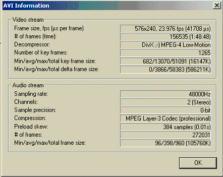

Open your video in virtualdub
Under file file information youll see sg. like this:
Video:
Framesize: x:Y ( lenght:height ) aspect ratio= x/y
Fps: frames per second : read more under standards here in vcdhelp.com
decompressor: video codec used for compressing the pictures in a movie to .avi file
keyframes: every 100-300 frame should be one. Much=> big size, few=>impossible to forward ( or play at all) if it's not like that => get another source
Audio:
Sampling rate 44.1 or 48 kHz ( standards )
Channels: selfexplainitory
compression: in my case mpeg layer 3
If: " uknown tag id 2000" than you have ac3 sound. more later

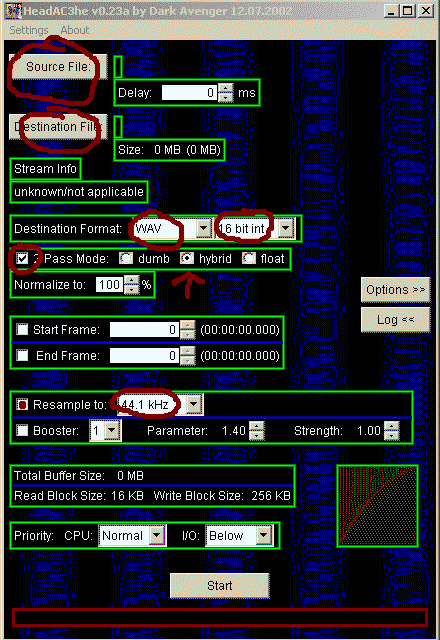

Open file in headac3he ( source file )
destination format wav 16 bit
2 pass hybrid mode
resample to 44.1 kHz
What I didn't mention doesn't need to be touched
go to end of step2

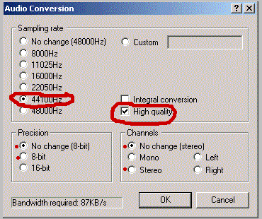

"improper vbr sound......." ( Vdub prompts this )
sound: full process mode
compression: none ( PCM )
check high quality as well
In some cases this causes problems, so U might skip high quality
save wav as moviesound.wav

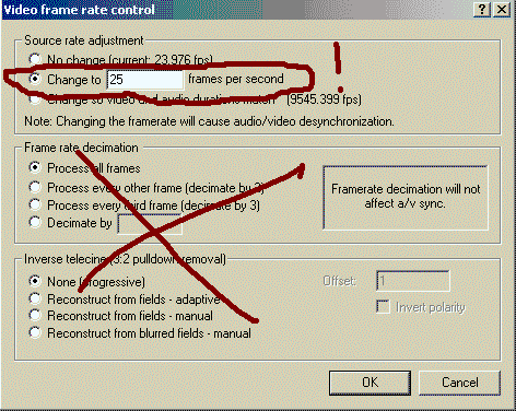

PAL video is 25 frames per sec. If your video is 25 fps then skip this step
if not then....
under video in vdub do this
audio: no sound
video: direct stream copy
file/save avi
save as movie25.avi

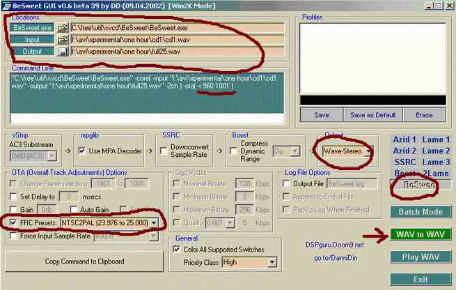

for the audio:
open the .wav audio ( extracted beforhand as mentioned in step 2) in the beesweet GUI
There's a setting for both US/JP NTSC, but you can also enter manually the OTA settings for bogus framerates
save the "25 fps " wav as moviesound.wav
now open the movie25.avi in vdub under audio select wav audio and add the moviesound25.wav
Now you have yourself a fully PAL avi
A video converted this way will have some frames inserted to have a 25 fps speed. 23.976=>25 fps conversion will not result in jerky high motion scenes especially when vdub+cce frameserving is involved.
However certain movies might have a special way of encoding resulting in jerky scenes. 29.97=> 25 fps conversions can be done this way, but the quality of the movie will gradually decrease, so I dont recommend this.
If you are interested more in this topic then read about telecining and pulldown. I will not try to xplain theese here.

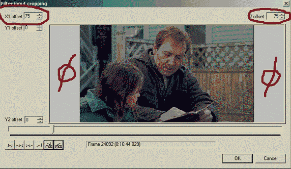

Set the video/ full process mode in vdub

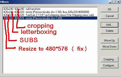

Under video/filters/add add a nulltransform filter, select "cropping"
This filter cuts some part off from the picture. By setting the X offset (see picture) adjust the picture to a 16:9 ( x:y ) format.
xample:
source: 576*240 (x:y). For 16:9 cutting do some maths: 240*16/9=427, (576-427)/2=75
So by cutting 75-75 by both left right edges you'll get a 427*240 (16:9) picture.
As you will see you wont miss the action, instead you'll have a movie and not some black bars with something happening inside them.
A way of skipping this all is to buy a 16:9 TV set. Sure....
Step 4A,
Letterboxing
translation: Addig the black borders ( top and bottom )
It comes handy when addig the subs but also necessary without adding subs.

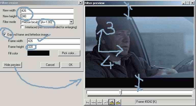

In Vdub under video/filters add filter resize
Do the maths: in my expamle
(426/4)*3=319,5=320 for the new height
In the upper fields ( resize ) just enter the dimensions you got after cropping
Fill color should be black

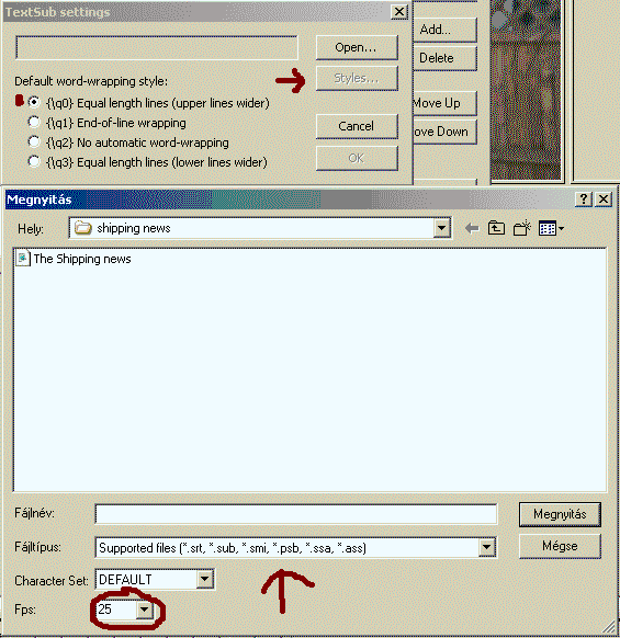

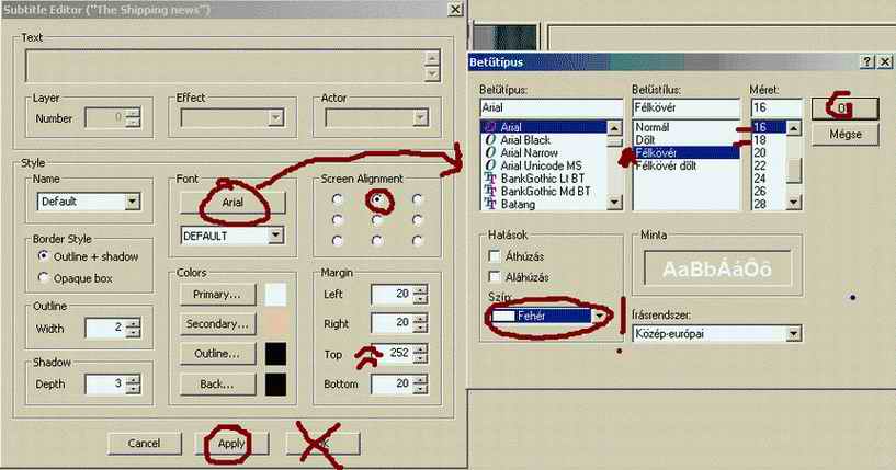

In vdub under video/filters/add add the textsub filter
under styles do the following:
So, adjust the lines to the top, so they stay in the lower letterbox field.
Play with the top margin number until the text is right under the picture.
Use 16-18 White ( yellow) wide arial chars ( 16 is enough ).
Press apply.

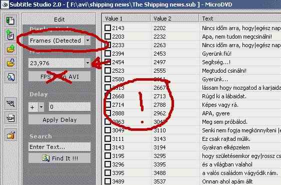

Mind that by speeding up the NTSC format film to PAL the sub will desyncronize.
With subtitle studio you can correct this.
open the sub file in substudio
It will display frames.
1, Adjust the fps to the original avi's fps.
2, Switch to time display
3, Adjust the FPS to 25 ( PAL )
4, Switch back to frame mode.
5, Save
This trick works most of the time. But you can use any other sub tools to do this job.

In vdub add another resize filter resize the letterboxed avi to 480*576 with the precise bicubic mode (A=1.00)

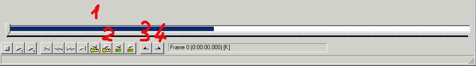

Cutting the movie in half for better quality
Around 50-70 mins of video will fit on one disc. If your movie is bigger then cut it in half.
with button "3" set the start of the first half ( third ) of the film
with buttons '1' and '2' select the end of the first disc
If you've seen the movie than mind that this cut should be in a proper place!
With button "4" set the end of the first half
Write down the end frame on a piece of paper
When doing the second part do the same as above, but with the second part

If you've done everything right in the vdub filter window you should get something like this. Its important that the filters are in this order.

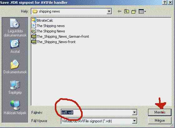

Under file/start frame server
frameserver setup: enter something.avi then start
Save a file forxp: cd1. vdf ( !! .vdf !! )
Start Cinema craft encoder ( later cce )
right click in the main window "add"
Go to the dir where cd1.vdf is, select all files, then click on cd1.vdf
right click on the file and select edit

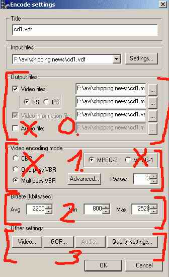

Open the official VCDhelp. com bitrate calculator ())
Enter the length of the first cd , the used disc type ( Use '80 ) and set the audio to 192 kbps
Enter the calculated max, and avg rate in the edit windows "2" field
Min rate should be sg. between 800 and 1200 ( I use 800 )
Be sure to keep at least 300 kbps between max and avg
Max rate is 2528 kbps with 1 channel 192 kbps audio ( that's fine )
In section "0" you can adjust file settings
If you dont have much space then the name of the first two files should be the same.
Dont check audio, it will be done later

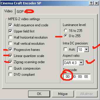

In section " 1" set multipass vbr, Mpeg2, You can choose 1-2-3-4-5 anything above 5 is a waste of time. 3 is the best for the time it takes. ! This will take the longest to finish! 3 pass approx 4 hours on a 2k athlon! so .........
In section "3" under video and quality
Check progressive, linear, zigzag, Luma level 0-255 (!), aspect ratio 4:3, timecode 000000000. Dont touch GOP unless you know what it is.

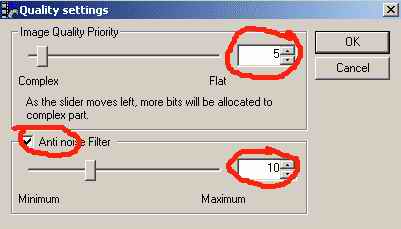

Under quality select the motion detection to around 5-15. You can also add some noise reduction.
Hit OK then encode

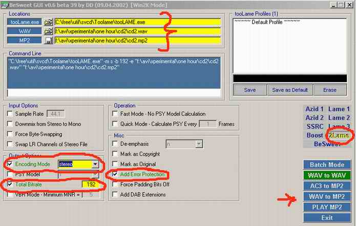

open Beesweet, select the 2lame codec
adjust the GUI as seen on the picture: enc mode: stereo, bitrate 192 kbps, add error
prot.
Set the input and output files.
If somehow your sample rate isn't 44.1 kHz than youll have to convert that also
push the wav to mp2 button and wait a few minutes

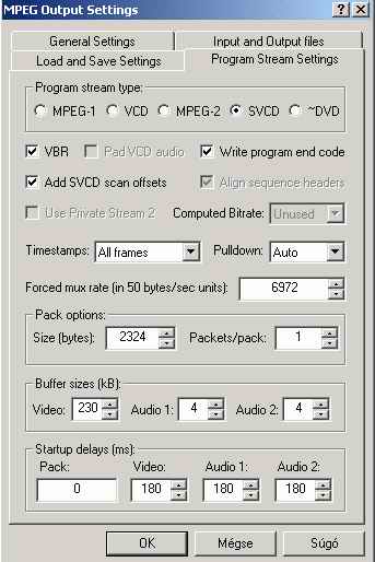

Now open avi2mpeg
Hit start encoding, hit seetings
Under input/output files add the .Mpv file ( VS ) and the .mp2 file ( AS )
If you have 2 audios than you can add it here. ( mind that you calculated the bitrate of the SVCD that it has only 1 audio!!!! So it wont fit on a cd this way!)
You need to click on the advanced tab in the bitrate calculator to make a second audio!
this is I think the default ( good )
You will end up with an mpeg file. If you aren't into design too much than you can burn this mpeg with nero SVCD but I think you should keep going ......

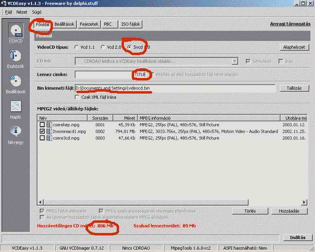

Start VCDeasy
Download the cover of the movie your working on from
www.cdcovers.cc or www.imdb.com
There are good guides for VCDeasy on this site, I'll write down my version to complete the guide

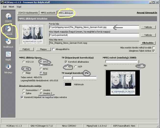

Convert the downloaded .jpg files to .mpeg with the VCDeasy/ ttols/mpeg stills tool
For my set of tv/dvd 5% correction is needed for small Pal images.
Try out each setting, its pretty selfexplainitory
Mind the best input file size/resolution!
Make some kind of change disc picture in for example paint
Here's mine:
Do the conversion for this also

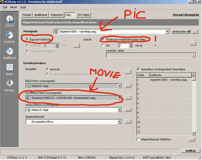

In VCDeasy's main window add the movie.mpg and the created pictures.mpg files
Mind the order : cover.mpeg, movie.mpg, change disc. mpeg!
Enter the title of the movie and the output file path, also check svcd
Under settings mark the two options in PBC ( this is a common source for errors!!)
In older versions there is only one option under PBC!

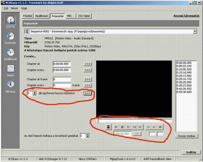

On the third page set the chapters
I usually add 9 automaticly generated chapters
You can also manually add chapters of your desire or at key momonts of the movie. Play a bit.
The fourth is PBC
For the first and the last pictures do the same
Play once then wait infinite
For the "next" button the movie should start
Hit start
A few minutes later you'll have a Cue/Bin to burn. Hopefully It will be the right size to fit on a '80 CD ( note that 808 M of SVCD will fit on a 700 M disc)
Before burning you should check that everything is in order.
With Daemon tools ( phantom cd drive ) mount your cue/bin image file.
Open the virtual disc in forxp windvd . The movie should start with the cover , the picture is paused untik you push the next button. When the first cd is over a change disc still will pop in and pause until you eject the disc.
Hopefully this covers everything. Do the same procedures with the further discs also.
If you feel that something is messed up or needs more xplanation than post your messages freely.

I think you could reduce the number of resizes in VDub. You can reduce with one resize and use cropping of that filter. I didn't understant why you made a resize to 320 x 240 and another to 480 x 576. I think it will decrease the overall speed and degrade the quality. The real resolution of your video will be 320 x 240, despite you resize to 480 x 576. The quality was lost when reducing to 320 x 240 and you cannot recover it by enlarging to 480 x 576.
Congratulations for your job and your idea of sharing it with us. -
Thanx for your grats
Sorry the picture was wrong, I do only one resize and that's the last. the first resize is only for letterboxing!
Standard pal svcd resolution is 480*576. By adding the last resize filter the produced mpeg will bare this resolution, and the picture on your television wont be anamorphic, blocky or someway bad cause tough the precise bicubic A=1 filter takes the most out of your machine, it will produce the highest qaulity resized image.
Exercise a bit in photoshop to try different resize methods!
Sometimes I also sharpen the image a bit cause enlarging is done by interpolation which causes the picture to be a bit smudgy ( unsharp )
Of course you can add the first resize ( letterbox ) and the crop at once, but this way, I think, its easyer to understand what you're doing. -

There has been a few comments about subs in my guide, so now I will pass them over here
Oh and
What size screen are you using, default is 800 X 600 try to fit those images in, crop out what you don't need... All the scrolling
Edited again according to KingJohn's advice.
Please dont pass the sub topic totally on this guide cause I'd gladly see some CVD sub on SVCD guide out there. That's much more "DVD style".
I'll try to correct the picture problem ( next week ), but I'm running on 1600*1200 and the whole thing fits for me fine.

There is no need to use CCE 2.50 anymore. As of version 2.66 CCE now accepts all AVIsynth and Virtualdub project files.
ASHY -
Hi Mategal,
Nice job, indeed but I found some things too complicated.
For example for the same task I use only 2 filters in vdub.
Not 4, not 3, just 2. The first one is resize, and the second one is TextSub.
In my method, there is no need to make corrections in the subtitles file.
(i.e. one program less)
What I do is serving from vdub with the original framerate and encode with tmpgenc with the new framerate and "no framerate conversion" checked.
I don't know about the way you describe but it sounds very strange to me that vdub inserts frames.
The way I use - no frames are inserted - just the same frames are played faster or slower (depending on which direction you convert). So it simply cannot be jerky. I can even convert a movie with 10fps from my still camera to 29.97 and it will not be jerky ! It will run just 3 times faster
Best wishes,
UP -
I was trying to explain how to convert sg. to a standard SVCD disc. This standard requires 25 fps.Originally Posted by Umen Pich
However I mentioned, that if you dont want PAL you can skip framreate conversions.
I'd be interested to hear how you sqeeze all those filters into 2?
I can imagine 4, maybe 3 but 2?????
Mind that in cce you dont have templates like in tmpeg. So there is no "fairy" who converts your picture to 480*576 at the end. You have to do it manually here.
If your method suit your needs, than I think you'd stick to that.
If you have time maybe you could share it with others on vcdhelp?! -
I know that it requires 25fpsOriginally Posted by mategal
I have a PAL camera.
What I said is that you don't need to convert the subtitles. For example - subtitles are for 23.976. Then I open them in Vdub, choosing 23.976 for in textsub, and without changing the framerate of the video. Then frameserve. So both the video and the subtitles are at 23.976 and what is served will be sinchronized. Then in TMPGENC I choose 25fps for the mpeg and in settings - "no frame rate conversion". The name of this checkbox is a little bit confusing - actually it means - change the framerate by using the same frames but for different time. In this case the conversion is smooth, you convert the audio separately, than multiplex and everything is OK. If that box is not checked, it will convert the framerate but the overall time of the movie will remain unchanged. In this case the video is a little bit jerky, because of putting or dropping some frames.
scroll downOriginally Posted by mategal
No need of fairiesOriginally Posted by mategal
vdub will resize it.
I don't have CCE, because I am not a millionaire, but the method will work for any mpg encoder which can read the frameserved file from vdub.
Here it comes (the simple method of Umen Pich)
1) Open the movie in vdub
2) look at the information - what is the pixel size - in my case 624x272
3) start the program "roco" (http://poco.topcities.com/download/poco.zip)
4) enter 624x272 in roco. For the output choose PAL 480x576 (since your guide is about PAL). Roco gives 480x384 as a result.
5) goto vdub video-->filters-->add-->resize-->480x334
/* note - I strongly believe that using multiples of 16 will improve the quality of the final mpeg. So if there is a close multiple of 16, such that the aspect ratio will not be changed significantly, I always put that value. In our example 336 is the closest to 334.
So, better put 480x336 in the filter! */
6) check "expand frame and letterbox image"
7) put 480x576 there and press "OK"
8) add-->TextSub
9) the remaining is easy - choose the subtitles, their position in the black stripe, fontsize and so on... What is important -- if you use a normal font, your text will be too expanded in the final 4:3 screen of your TV.
To avoid this, use a Double Condensed fonts. Any double condensed font will look as its normal version in 4:3.
If you cannot find such a font, please let me know, I will upload one somewhere. BTW, the popular Arial Narrow gives pretty good results.Best wishes,

1 Virtualdub...extracted the audio converting to 41000Hz, full processing wav file.
...extracted video converting to 25fps.
2 Converted wav to 25fps using Beesweet.

Adjusting audio speed like this will change the pitch of the sound. Try the new audio time scaling utility that preserves audio pitch. More info at http://forum.doom9.org/showthread.php?s=&threadid=49800.
Xesdeeni -
Thanxx fpr the tip.
I'am concerned with quality, but NTSC video=>PAL conversion only produse 4% of pitch change and that's almoast un-audible to an average ear, ( at least for mine it is)
However this conversion you mentioned prooved to be a bit faster.
Try to contact the beesweet team for a new button in their upcoming GUI!Anyone tired of his old DVD burner? Why put it into the trash? Contact me! :)))) -
I've been telling everyone that the pitch shift wouldn't be very noticable, but I just can't stand it myself. The professionals adjust the pitch when they go from 24fps film to PAL:
