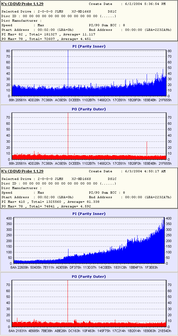

Well I did a test to hopefully try and get to the bottom of this. I burnt a DVD movie at 4x onto a RitekG04 DVD-R disc. Ran Kprobe and did a PI/PO error scan on the disc. Then I put a sticky label onto the same DVD-R (using a CDStomper) and ran the test again to see the difference. The graphs are below so people can draw there own conclusions if they don't agree with my assessment. The top graphs from the disc before the label and the bottom disc after the label is put on.
Firstly for the people who doesn't understand what PI/PO errors are you can google it and find out. The important thing though to know is that the standard for DVD media is that the PI error should not exceed 280 and the PO error should not exceed 32 (ignoring single spikes). Also note that the error rate is dependent on the device that's reading it (in my graphs it's a Liteon DVD-ROM) and of course the speed at which the disc is being read, with a slower speed resulting in less errors obviously. For my tests to conserve time I just read the disc at max speed of the DVD-ROM since I'm not really interested in the 'real' amount of errors when played back at 1x (like on a DVD player) but to see if the label makes a difference.
As you can see from the graphs, it can be safely concluded that "YES" sticky labels can screwup playback. As you can see from the first graphs (disc without label) the error rates are steady throughout the scan, and are well below the standards. It should have no problems on any player. Now if you look at the second graphs (disc with label) you can see that the error rates start off the same but gradually climbs higher and higher (towards the end of disc) and near the end of the disc the error rate is higher then the standards allow. This disc would probably play fine until near the end of the disc where some players will start having problems... this is consistant with people's experience with pixilating near the end of the movie. In the real world test of this disc I burnt it played fine on both DVD players I tried them on, a Phillips and a Panasonic. You maybe wondering why if the error was above 280 on the graph it didn't cause any problems on playback in the realworld. Remember the error rate is device and speed dependent, a setup DVD player reads at only 1x speed my graphs are for the max speed and even then only the end of the disc shows error rate above the standards.
CONCLUSION:
Can labels screwup the playback of DVDR's?
Yes
Why do some people experience playback problems and others don't?
Some players are more sensitive to bad media. Also the media you put the label on makes a difference. Although the label does cause more errors the error rate can still be below the ECMA standards.
Why do labels increase the error rate?
This is debateable and everyone has there own theories. My person opinion is the label is 'warping' the disc and causing focusing problems for the dvd player. Have you ever noticed when you peel off a label from it's sheet it has a tendency to curl up? Now if the label has this 'curl up' tendency when you place it on your disc this would act as a small force pulling the edge of the disc up. This is what I mean by 'warping' the disc. It might just be warping the disc enough to cause the errors. This would explain why the error rate increases near the end of the disc, because the disc would be warped the most at the outter edge.
I hope that helps... time to get a CD printer

Great bit of detective work! I can't rule out your "warp" theory but I have an alternative suggestion:
Adding a label increases the mass of the disk and can create an uneven distribution of mass (an unbalanced condition). There's no way to perfectly place a label on a disk. Even if it looks perfect to the naked eye the label will be slightly off center. Even if you could place it exactly on center you can't be sure that the thickness of the paper and glue is perfectly uniform. In short adding a label will usually slightly unbalance a DVD. Sometimes more, sometimes less.
Why would this cause problems on the outer edge of the disk but not the inner? Because DVD players use constant linear velocity, not constant angular velocity. The disk spins faster when reading near the center, slower when reading near the edge. If you listen closely you can probably hear the difference in pitch when the heads seek across a disk.
The wobble caused by an unbalanced disk would vary with frequency. It's not as simple as "the faster it spins, the more it wobbles". There is a resonant frequency at which the wobble will be at its worst.
Have you ever been in a car where one of the balance weights has fallen off a tire? At slow speeds you don't notice any problems. As you speed up the tire starts to wobble. It gets worse and worse until you reach a certain speed. Above that speed the wobble weakens and eventually disappears.
Tire manufacturers try to make their tires as balanced as possible. But they're always a little bit off. When new tires are mounted on you rims small metal weights are usually added to more fully balance them. Go out and look at your car -- you'll can usually see the weights mounted where the tire meets the rim.
I postulate that the resonant frequency of a DVD with label is somewhere near the speed the disk spins when the DVD players is reading from the outer edges.
There are two factors at work here. Adding a label increases the total mass. This would decrease the resonant frequency. But adding a label will slightly unbalance the disk.
It might be an interesting experiment to run your tests again with the DVD spinning at a lower frequencies. It won't be definitive because most DVD drives have some wobble reduction mechanism. The mechanism may be better able to cope with the lower frequency wobble. Or it may not.
In any case, thanks for running your test and posting the results.
