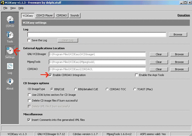

Select Settings
Select Enable CDRDAO
And then restart VCDEasy (close it and start it again)

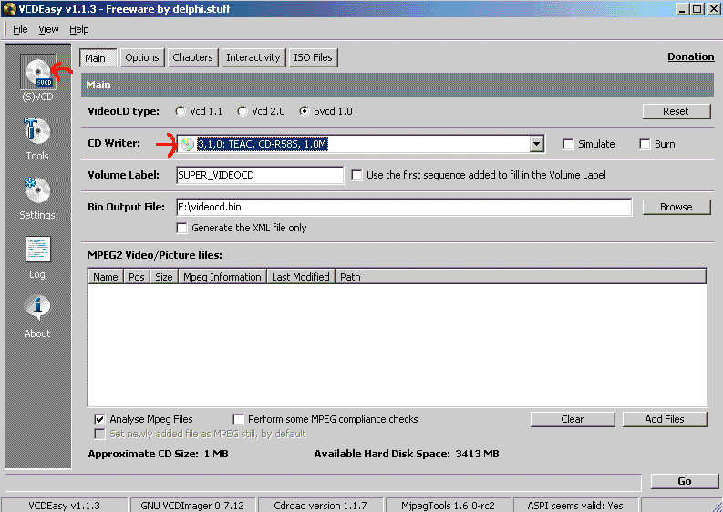

Select (S)VCD
Choose your CD Writer under the CD Writer tab

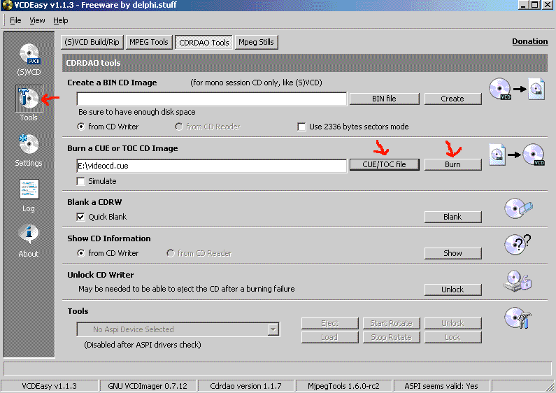

Select Tools
Open the CUE file that comes with the BIN file by clicking on the CUE/TOC-button.
And last hit BURN to burn the BIN/CUE file. You could select Simulate if you want to test if it work the first time you burn.
Done.
