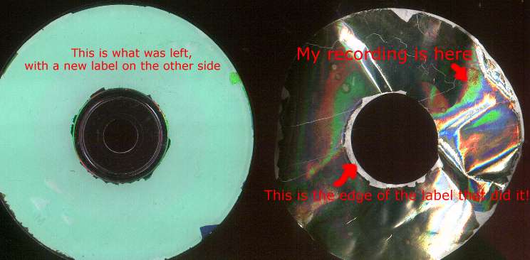

    NOTE on how easy it is to destroy a CD:
    I put a Sticky label (AVREY) on a CD and it was sorta off center enough
    to worry me..So I tried to peel it up...
    and VOILA the entire contents of the cd were on the reverse of my label in my hand..only the silvery edges of the DATA remained on the now clear transparent remainder of the disc
    PLEASE don't try this AT HOME

  20. Member dcsos's Avatar
    Jan 2003
    Y No Werk (anagram)
    And as to peeling off the working media, I am not sure I believe the reports of peeling off a lable and destroying a disk
    Well I urge you to believe it!
    You're the one telling ME...I'm serious
    You are correct in that regard

  22. Member dcsos's Avatar
    Jan 2003
    Y No Werk (anagram)
    Well all I can say is when the label was peeled fully,
    The CD was transparent and had only a tiny residue of silver foil around its outside perimeter. It was like those packing blanks they give you
    i think IT WAS A MEMOREX 32x certified CD-R
    Like an Idiot, I put the clear disc in the drive..
    suffice to say it was reeboot time

    Took a few hrs to find the sucker (I kept it)
    HERE is the cd whoose label peeled off..taking the recorded data along with it!

    And as to peeling off the working media, I am not sure I believe the reports of peeling off a lable and destroying a disk. I do not think any of my disks, dating to about 7 years ago, have a minute, leveling layer of "plastic" on top of the die-struck recording layer, which could be peeled off by removing a lable. It may be possible. Glues do become better with every problem encountered .
    You perhaps need to guess less and actually believe people's experiences (and learn how a CD is actually constructed!). A CD has only a laquer layer on top of the data. There is NO POLYCARBONTE LAYER ON TOP OF THE DATA LAYER. From top to bottom:
    TOP
    - Additional protective layer (optional)
    - Lacquer layer
    - Data layer (thin layer of aluminium or organic dye)
    - Polycarbonate substrate
    BOTTOM
    Better CD-R discs have an additional protective coating while cheaper ones do not. You can well peal off the lacquer layer by trying to take off an attached sticky label and the lacquer layer will take the data layer with it.
    For more on how a CD is made, I suggest reading the excellent CD FAQ and CD-R FAQ.

  27. Member dcsos's Avatar
    Jan 2003
    Y No Werk (anagram)
    Thank you for the EDUCATED response..
    NOW I UNDERSTAND

    Dcsos,
    I guess you sure showed me, huh?
    Actually, that's the first time I have seen that. Thanks for the pic.
    Hey, if you want to destroy a disk to keep one from "data recovery" of incriminating evidence, don't try to snap it in half. I did, once, as much to see how tough they are, and wound up with a bunch of shards on the floor. It literally shattered.
    Now I gotta go tear one apart to see if they're all like the one you posted.
  30. Member Cornucopia's Avatar
    TRUE STORY:
    Year and a half ago did a job for a client that required mini-CD's. They were wanting to rush so I couldn't order nice ones. Went to Staples and got a coupla packs of Memorex CD-3s.
    Then my sales rep says they want labels. At that time I had no label template for minis, so I fudged with cutting down full-sized ones. Kinda halfway worked, but some would be slightly off center.
    Made the discs, put the labels on. Sent them off.
    Later, they want to get custom printed correctly-sized labels, so they send back the discs.
    Without my knowing, sales rep and co-worker start taking off the old labels...
    Looked just like what you showed in that picture.
    Needles to say™, I had to start over from scratch with better stock.
    Its better to learn the easy way (this forum) than the hard way.
