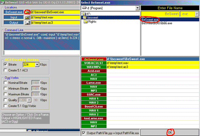

Select where the Besweet.exe is located by clickin on the Besweet open icon

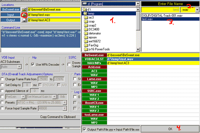

Select your audio source by clickin on the Input open icon
1. Select where the audio file is
2. Select file format, WAV,MPA/MP2 or MP3
3. Double click on the file to select it
4. Hit OK

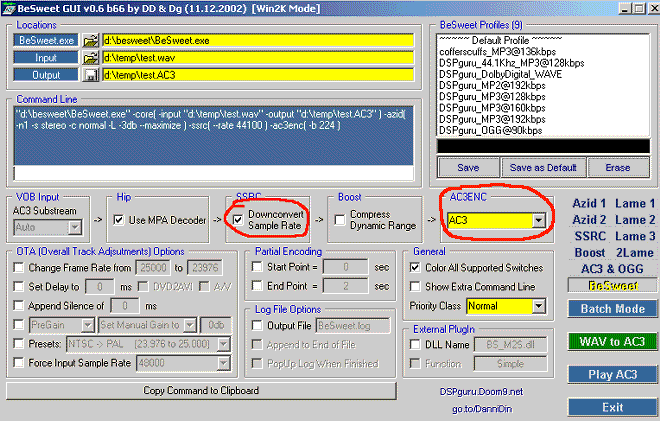

Select under AC3ENC -> AC3
Select under SSRC -> Downconvert Sample Rate

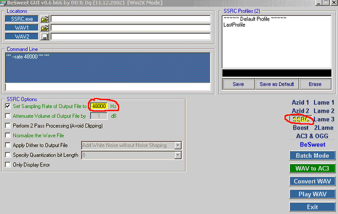

Click on SSRC in the menu to the right.
Change the Sampling rate to 48000. (DVD requires 48khz audio)

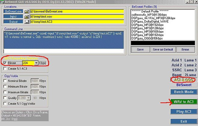

Click on AC3 & OGG
Change the bitrate to 224 kbit/s or 192 kbit/s. It should be enough for stereo audio. If making Dolby Digital 5.1 you should use higher bitrates, but if your source is not 5.1 audio(6 channels) it is no use to make DD 5.1 audio.
Last click on the WAV to AC3 and besweet will convert the audio to AC3
