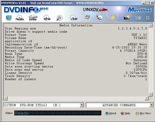

    How can you check?, If I burn a DVD with Nero and then burn exactly the same files with say RNM or Prassi how can I compare the two DVD's and their formats?
    this is the info I get from one of my backups which shows it's UDF 1.02 and these playback on anything I try them in, even fussy SOB players. The tests I run on the DVD are also fine but it doesn't go into exact format detail as it just says it's UDF 1.02
