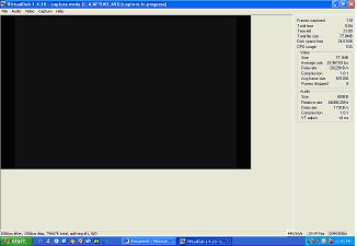

    Capture

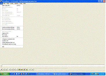

    First, connect your device(camcorder, vcr, etc.) and Open VirtualDub.
    In Virtualdub, click File, Capture AVI

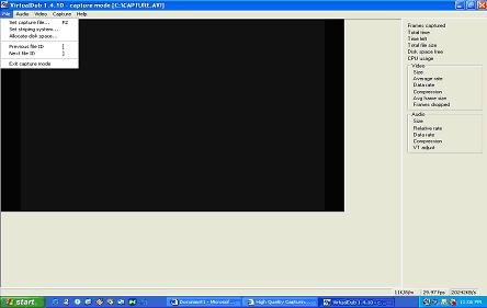

    This will open a capture window. If the screen is flickering BLACK, you probably do not have your device on or connected. If it is on, the capture screen will be BLUE. If you have TV tuner capture card, you may see a TV channel displayed instead of a blue screen. Don’t worry about that for now, we will cover that under Setting the source.
    On this screen click FILE and then SET Capture file
    When the folder comes up, designate the destination for your capture. Make sure you give A LOT of room as an AVI capture as described will use approx. 1.22 GIG per minute. The size per minute will be displayed in the lower right corner of the screen in Kilobytes.

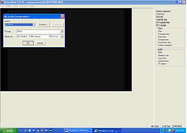

    Now you have set the capture file, you want to set the audio. There is much debate on this but I always set for CD quality audio. Again, if space is an issue, you can set for a lower quality.
    To set the Audio Click AUDIO and then Compression
    A box will come up like this
    Use the Pulldown under NAME and you can select the audio (in my case CD quality). The settings will change automatically. Click okay and it is set.

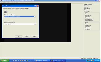

    Now click Video and then Source. This is where you would change the input if you are seeing a TV picture (TV Tuner card owners)
    The screen will look like this
    Select your device (In my case my ATI TV Tuner capture card) and the video source of composite.

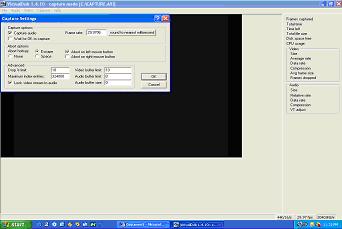

    Now go to the screen and click Capture and then Settings.
    You will see:
    Make sure you set the following:
    Capture Audio – Checked
    Frame rate – 29.9706
    Drop % limit – 10
    Video Buffer Limit – 10
    Max index entries – 324000
    Audio buffer limit – 0
    Audio buffer size 0
    Lock video stream to audio – checked (VERY IMPORTANT!)

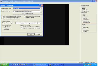

    Click okay and these are set. Now click Capture and then Preferences. You will see:
    On this screen leave capture driver as is. You can set the default capture file Virtualdub will use at start (but you already set that under FILE). The driver should be the Microsoft driver and the only box checked is OVERLAY. You are now ready to capture. Start your device (camcorder, vcr, etc) and press F6 on your keyboard. The capture begins and you will see the statistics on the right start to update real-time. Below is an example.
    To stop capturing just LEFT mouse click.
    Please note, if you start capturing again, you will OVERLAY the same file and lose what you first captured. If you wish to capture a second file, click the File and SET capture file again to designate a new file.
