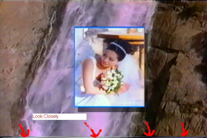

Please look at this picture:
http://ekindvd0.tripod.com/lines.JPG
And then tell me how can I get rid of those lines at the bottome of the screen in my captured avi files using Virtual Dub Huffuv@720*480 44Khz. Is there a filter I can use ? or it will go away when I encode it into mpeg and put on a DVD to watch on my TV ?

I don't see an image when I go to that url. (except the "hosted by tripod" image)
If you are capturing from an analogue tape, that is normal and if you are planning on playing it on a TV you wont see it due to overscan. If you really want to get rid of it you can crop it off using virtualdub.

Craigtucker: yes you were right about those lines. They were gone when I am watching it on my TV I guess it was out of scan on the TV or something. I can still see it on my computer when i play my DVD-R. Ok but i have some questions to ask.

Hey Craigtucker, I have a question....according to my last post those lines were gone when I watch on my TV because they were out of scan or out of range of the TV. But my question is ...How do I get rid of it ?? I don't like those ugly lines at the bottom of the video. Is there a way or a filter that I can use to get rid of those line ??
You can use virtualdub to crop the image, or the way I do it (assuming you are using TMPGEnc to encode to mpeg), is to use the clip frame option under settings->advanced in TMPGEnc.

If you use tmpgenc's clip frame option you can check the "mask" box to replace the cropped area with solid black, preserving the original resolution.Originally Posted by Ekin
There is no need to recapture, tmpgenc resizes after cropping so that the video is within spec.Originally Posted by Ekin
