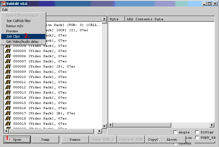

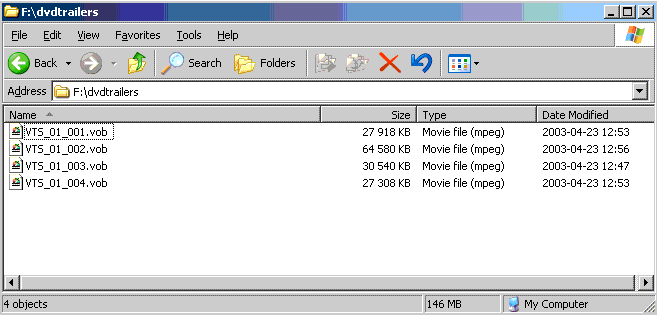

    First you have to put all your vob trailers/files in a folder.
    And then rename all files to VTS_01_001.vob...VTS_01_002.vob...VTS_01_003.vob and so on. Each vob will be a separate chapter.
    Now start Vobedit to fix the vobs so it will play okey on your player.
    1. Click open and open the first VTS_01_001.vob
    2. Select File->Join Clips

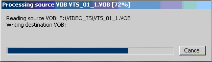

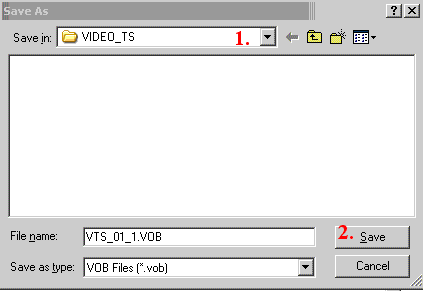

    1. Choose a new folder and name it VIDEO_TS
    2. Save the new VOB_01_1.vob file.

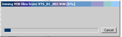

    A dialog popups
    1. Check so it says 1
    2. Click OK.

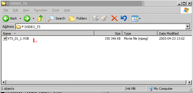

    Vobedit will make the new working vob.
    You should now have one vob or some vob file(s).

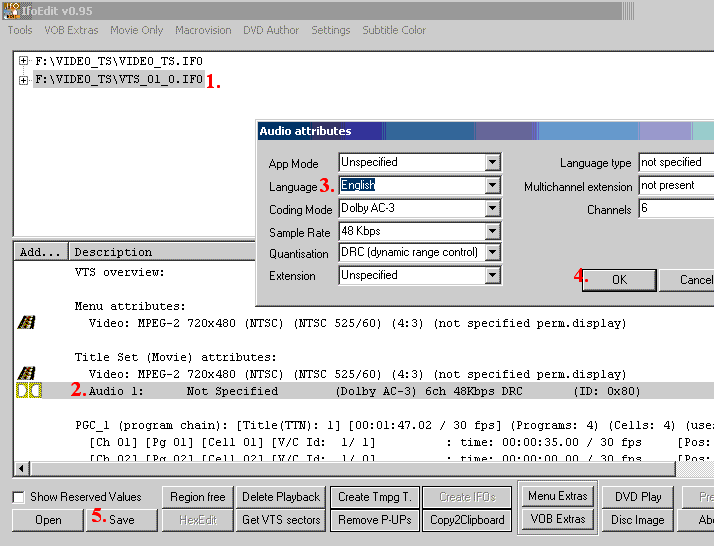

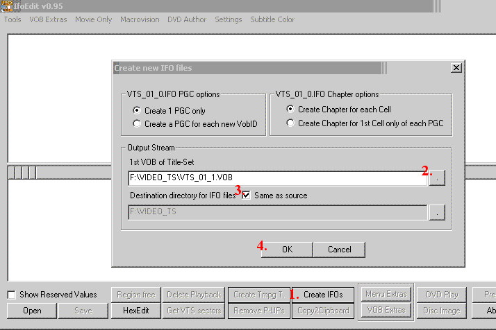

    Now start Ifoedit
    1. Click on the Create IFOs button.
    2. Open the first VTS_01_1.vob
    3. Select use same as source
    4. And hit OK
    Ifoedit will make the new .ifo files.

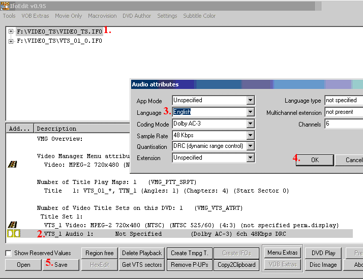

    You must now set the default language. First for the VIDEO_TS.ifo
    1. Click on VIDEO_TS
    2. Double click on the audio
    3. Set the languague to english
    4. Hit Ok
    5. Click save and owerwrite the VIDEO_TS.IFO
    Do the same for the VTS_01_1.IFO
    1. Click on VTS_01_1.IFO
    4. Hit Ok
    5. Click save and owerwrite the VTS01_1.IFO

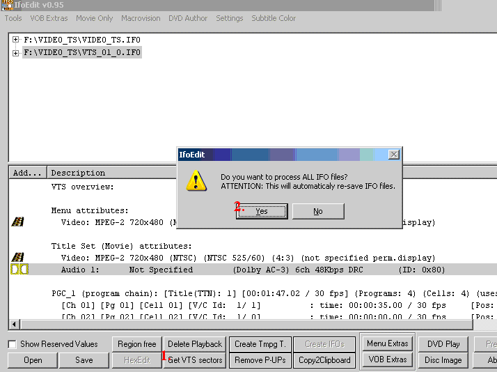

    Last fix the VTS sectors
    1. Click on Get VTS Sectors
    2. Select YES to process all IFO files
    Close ifoedit.

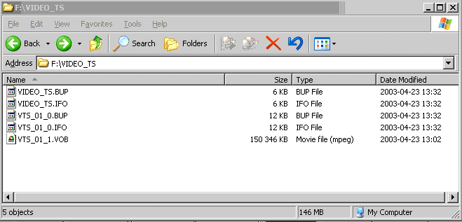

    You should now have some ifo and bup files and the vob file.
    You have now a (hopefully) a working DVD on your HD. To burn it using ifoedit and dvddecrypter(freeware), read here how. Or burn the created VIDEO_TS folder with InstantDVD or some other DVD Burning app and your are done, read more here how to burn to DVD-Video standard.
