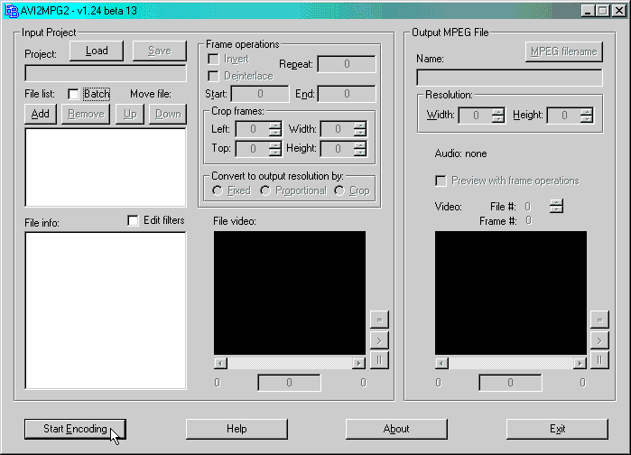

open up bbmpeg(avi2mpeg2) and click "start encodeing" (nothing will be encoded,we are just going to cut)
then you click "settings" and this screen will appear.

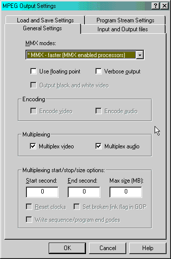

now click "general settings"

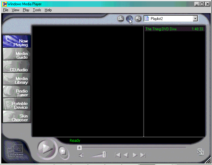

open up windows media player and load your mpeg.(not the mv2 file)
make sure the playlist window is open.
wmp shows the movie as 1hour 48 min.,which in total is 108 min.
108 min/2 =54 min.
54 min multiplied by 60 seconds gives us 3240 seconds.we are done with wmp.
now under "general settings" the "start seconds" =0
the "end seconds" =3240
max size in (mb) =800
then click ok.
