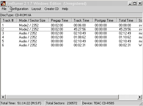

    How to make a VCD/SVCD with CD Audio using VCDEasy and Fireburner
    First make the VCD/SVCD with www.vcdhelp.com/vcdeasyhowto.htm , be sure to select no CD-Writer and VCDEasy will instead of burning make a BIN and CUE file.
    Launch www.fireburner.com and select File->Import track from cuesheet and open the CUE you created with VCDEasy. Select File->Load tracks to add your wav files, each wav file will be a track. Last burn it, Create CD->Burn.
    Done. You should now be able to play it in both your DVD Player and CD Player but of course will you only hear the CD Audio in the CD Player.

  10. Well, I was using Fireburner 2.17. The programme just keeps "Test Burning" without actually burning the CDR. Even unchecking "Test Burn" in the "rEcording options" won't help at all. It will still give me a message "Continue with Test Burning..." thing. Hence the CDR went through Test Burning without actual burning. This is why I kept ending up with and empty CDR and got the message "Disc Not Finalised" on my CD player.
    Another point to note is that if I check "Disc-at-Once 96" (as I always do for CD Creator), the recording with hang at one point and I have to restart my PC.
    With all these frustration, I have finally made one AVCD with Fireburner ver 1.06. I won't say it is 100% successful. This is because it is not the commercial "Audio Video CD" format that I have wanted to make.
    I still have to skip track to the audio part on my CD player. Example, if track 1 and 2 are videos and 3,4 are audio, I will have to manually skip to track 3 in order to listen to the audio part. Commercial AVCD do not have such shorcomings.
    I do own about 15 commercial AVCDs and have explored the structure and will explain in my next message. It has something to do with the difference in folder architecture between AVCD and a normal VCD. What Fireburner 1.06 do is to convert audio tracks from .WAV to . DAT. And then it throws all the video and audio tracks in the same "MPEGAV" folder. This made the CD player reading the audio tracks (first few tracks before audio) as well. Thus, one would have to skip track to the audio part.... That's from my understanding.
    I would be happy if someone can help solve the Fireburner 2.17 "Test Burn" thing.

  24. Yes, the method with Fireburner works. But it throw all audio and video tracks into the same folder, making the user having to skip the video tracks to the audio tracks when being played in normal audio player.
    I am unable to fnd out why FireBurner 2.17 couldn't work on my PC while FireBurner 1.06 could.
    Oh yes, forgot to mention.... Am I stupid or what.. you have to run Splitter.exe using the DOS PROMPT.
