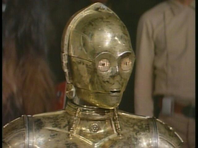

  1. "my AverTV Stereo PCI TV tuner capture card."
    This is the 2nd set of captures I've seen made with a $30 capture card, and I can't get over how good they look. Are cheap capture cards really doing that well of a job?

    Well I have posted a sample CLIP of my STAR WARS capture.
    Here is the link: CLICK HERE TO DOWNLOAD
    *** UPDATE ***
    Link changed to reflect the fact that I rename the file from STARWARS.MPG to STARWARS.TXT so when you download this file be sure to rename it back to STARWARS.MPG
    See my next post in this thread for more clarification
    This file is approximately 89.3 MB in size. It is a MPEG file with muxed 2.0 AC-3 audio and is 16x9 widescreen NTSC format.
    I used the AviSynth script I reported back on the page before this. So this was processed in total with AviSynth and CCE MPEG encoder.
    I use PICVideo MJPEG to capture because my computer is a bit on the slow side and with HuffyUV I will sometimes drop a frame here or there which seems to be related to the slowness of my computer (I only have a P3 650Mhz with 256MB RAM running WinXP Pro). I drop frames like MAD with the 20 setting so I use the 19 setting. I capture at Full D1 resolution which for my capture card is 688x480 for NTSC (you pad 16 on either side to get your standard 720 width thus giving a proper DVD aspect ratio).
    I've explored a lot of options with my capture card (an AverTV Stereo which I paid $50.00 USD at CompUSA) and it seems to work best with the Avermedia drivers as opposed to the BTwincap drivers. Also I use PICVideo MJPEG because I think there is something "odd" about the colorspace conversion when using HuffyUV and AviSynth ... I'm not sure if this is an AviSynth issue or a HuffyUV issue. I know of a few other people (people who know what they are doing) that use PICVideo MJPEG on the 20 setting RATHER than use HuffyUV because of colorspace issues. Again I haven't tested HuffyUV all that much since my computer can barely keep up with it but my point is this: something is "goofy" with either HuffyUV or the combination of HuffyUV and AviSynth in terms of colorspace. No such colorspace issue exists when using PICVideo MJPEG with AviSynth and CCE.
    As for the Avermedia drivers I used the standard default settings (I'm talking about contrast/brightness and saturation etc.) for this capture (see my second set of pics on the page before this). Those pics come from my first MPEG encode which I did incorrectly (the resize from 4:3 WS to 16x9 WS) which caused interlacing issues (only visible when playing the clip back on a TV). This new second encode, of which the sample CLIP comes from, is using the AviSynth scrip I posted (see page before this) and does not have the interlacing issues, although there is an "odd" thing going on at the very top and bottom of the picture, i.e., where the actual image "meets" the black border. It is not very noticeable and I'm not sure why it is there but it is definately an "artifact" of the 4:3 WS to 16x9 WS conversion.
    Please feel free to download this clip (it is about 1 minute and 34 seconds) and let me know what you think of it in terms of quality. If possible use an authoring program to burn it to a DVD-RW or DVD+RW and view on a standard DVD player using a standard NTSC TV for proper testing since NTSC looks "odd" i.e., a bit dark, on a computer monitor.

  7. Okay, I finally got a chance to view your sample, fulci. It really helps to see it in motion. I noticed right away the anomaly at the top and bottom of the frame. That is a side-effect of the convolution filter. Since the convolution filter takes surrounding pixels into consideration, the ones on the edge get the black involved in the equation. You might try cropping up to the edge of the frame before the filter and then generating the black bars (and left & right edges) afterward. Although that might introduce yet another anomaly depending on how well the filter is written and if it has special processing for the edges.
    Color looks brilliant. Very nice. That gray haired guy always looks too red anyways. However, I noticed the stars at the beginning were hard to make out.
    All that being said, I viewed it on my PC, not a TV (yet). I did notice interlacing artifacts on the PC monitor. Or perhaps it was resizing artifacts. I tried to ignore that. I will have more to say about that if I notice it on the TV.
    Thanks for posting the sample, fulci.

    I've previewed your clip on my PC. I noticed some diagonal jittering lines, especially on Artoo and two small transparent lines near the top and bottom black bars. However, it may be just a codec limitation on my PC. I checked properties and Intervideo's audio and video codecs were being used to decode the clip on my PC, so that may be the source of those problems.
    I really liked how stable your top and bottom black bars where compared to mine. My bottom one jumps a little during the opening when the ships are hitting each other and later when the rebels and troopers are having their shootout. I'll have to investigate to see what is causing that.
    I also thought your colors looked nice.

    The "wierdness" at the top and bottom of the frame (where the image meets the black border) is definately there because of the 4:3 WS to 16x9 WS conversion.
    When I convert it to MPEG-2 but just leave it 4:3 WS it does not have any of that "wierdness". This is why I think the "wierdness" has to do with the 4:3 WS to 16x9 WS conversion and not a Convolution3D problem.
    As for there being any "interlaced" artifacts:
    1.) I captured interlaced 29.970fps and left it that way ... I did not do IVTC
    2.) Resize from 4:3 WS to 16x9 WS will actually "lower" the resolution a bit but I did it that way since that is all the rage. I don't personally have a 16x9 TV but I guess I will one day.
    All in all I am happy but when I finally get around to doing the whole movie for myself I think I will probably just leave it at 4:3 WS rather than convert to 16x9 WS

  26. "Keep in mind, though, that you can't edit out things like, say, disc flips/swaps, which can take several seconds each.
    "Completely false. Editing MPEG2 without any re-encoding (quality loss) is done all the time with several different popular applications. For example, Womble MPEG Video Wizard and MPEG-VCR. There are also some full-blown editing programs (Ulead, Vegas) that can handle MPEG2 and only re-encode at the edit and transition points."
    Well, what I meant was, you can't do it on the DVD recorder. You'd have to do extra work on the computer anyways. I was under the impression Paris wanted a simply copy straight off the recorder, and that's not a good idea in and of itself.
    "3. If you know what you're doing, a $30 cap card with a good 9- or 10-bit chipset and a decent lossless (or nearly lossless) codec will always do a better job of capping than a standalone DVD recorder. ALWAYS. Having a hardware recorder convert to MPEG-2 on the fly is convenient, but it's not as good as capping to a 4:2:2 codec, doing your editing (and IVTC, etc.), and then rendering variable-bitrate 4:2:0 DVD-spec MPEG-2. Also, adjusting colour levels, etc., is way cheaper with (free) tools like AviSynth and VirtualDub than any hardware solution upstream of a DVD recorder!"
    Agreed.
    I want the Star Wars O-OT on DVD, dammit!
  27. You can do some simple I frame editing on DVD recorders before finalizing. This works pretty well especially on the built-in HDD models. Yes, and I also agree that software capturing, filtering, encoding, etc. is ultimately a better, higher quality method (if you know what you are doing, of course).... but, for simple transfers of good quality VHS, home video tapes, or laserdiscs it is a terribly time consuming process for a relatively small difference in quality. DVD recorders offer speed, ease of use and pretty decent output. Just my opinion based on personal experience. YMMV
  28. I've been experimenting with a hardware video sharpening/noise reduction processor, the Vidicraft Detailer III... it's a really nice unit. The best of it's type I've tried so far. Got it off of eBay cheap, too.
    Here is a clip from the Star Wars full frame CAV laserdisc, composite output recorded with the JVC DR-M10SL DVD recorder:
    On this one I am using the Vidicraft Detailer III. Detail at 1/3, Sharpness at 1/4, VNX at 1/2, Black at 1/2 (last two are noise reduction):
