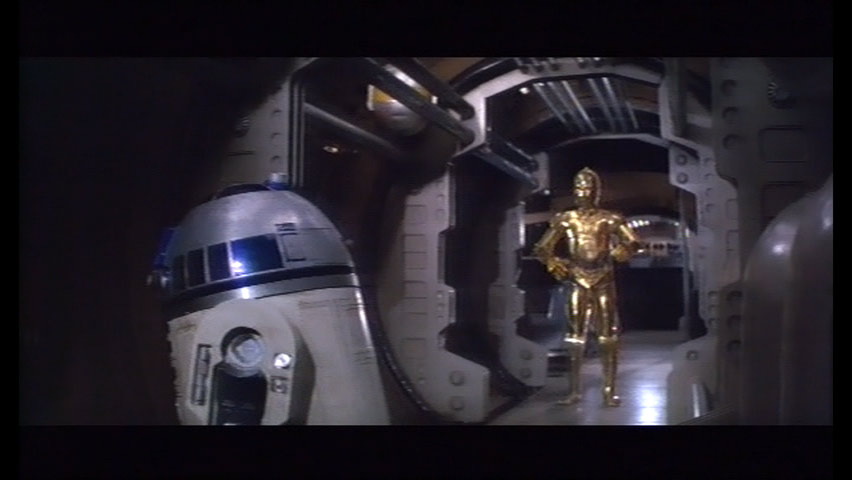

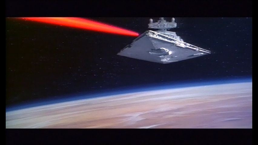

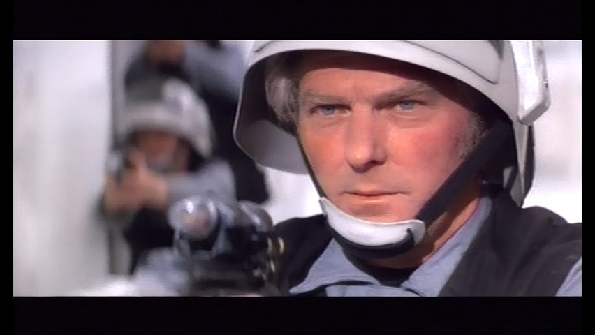

Okay, here are some screen caps. One admission: The captures were very dark for some reason (both as BMP's and JPG's), so I lightened them back to normal in Photoshop.

Eandtc, it looks like you are using the analog-to-DV pass-through feature on a digital camcorder... is that right? Those blocks and lines look very similar to some test captures I've done using that method.

"Eandtc, it looks like you are using the analog-to-DV pass-through feature on a digital camcorder... is that right?"
Yes. Until I am able to afford a high-quality vid-capture board, this'll have to do. I doubt I'll ever get a standalone DVD recorder, since I have no other need for it. (Though this didn't stop me from buying an LD player solely for Star Wars.

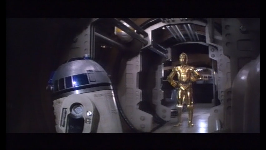

Here are some some screen caps I took from my LD captures. As a little exercise in benchmarking, I grabbed the exact same frames as Eandtc did, above. Unlike Eandtc, I didn't mess with the colour at all. I just resized (Photoshop "bicubic") to the same 1024 x 576 pixels Eandtc used. Enjoy!
Neither, actually: they're from the PAL release equivalent to "Faces".
Don't forget that your TV (if you're in North America) has some IRE funny business going on, and will display only 15-235, effectively. PAL and Japanese NTSC will do the full 0-255. That might be part of the explanation for why your caps look darker? -
Not quite, since I'm comparing the vidcaps of my computer to the playback of my computer.
I want the Star Wars O-OT on DVD, dammit! -
Video (especially NTSC) will look overly dark on a computer monitor but chances are if you don't **** around with the birghtness/contrast it will look fine on a TV.
At least that has been my experiences.
