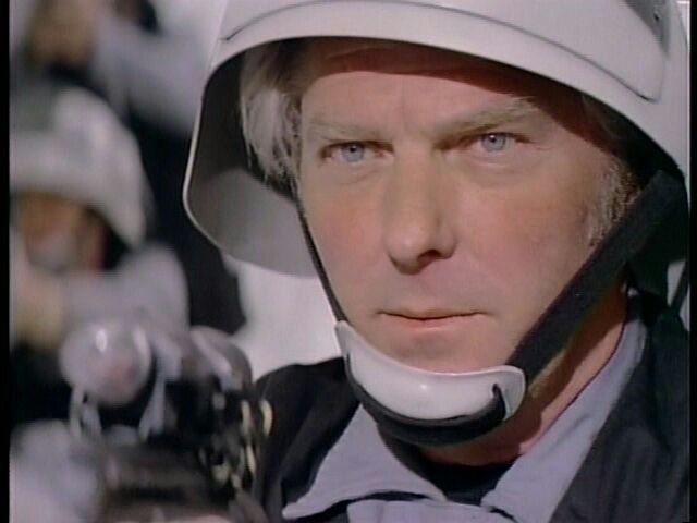

On the other hand, I seem to be getting some decent captures with what I have...
(Winfast TV2000 expert @ 720x480, cropped & resized) :PLiberate te ex Inferis -
not bad at all.
APART FROM THE BIG WHITE ROT SPOT!!
Seriously though, looks pretty good we'll have to put up a compendium of that paticular frame from different users.
That would be awesome! I'd love to see what sort of quality everyone else is getting. Compared to yours, mine is a bit less colorful. Mine's not a SE capture though.
