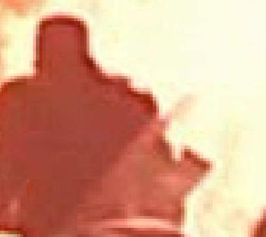

    VHelp,
    The thing that bugs me about the crosshatching is that I actually FOUND an explanation of it, and can't find it again....
    I've been able to repeat that darn crosshatching on both my capture devices AND my big TV. I've dropped back to using composite wherever I can't go component video... Frustrating!
    I *believe* it has something to do with the Luminance (Y) signal bleeding on to the Chrominance (C) signal. However, I don't know this for certain. Surely, though, major capture devices like Canopus and ATI would not systemically have issues with SVideo without there being a HUGE swell of commentary on this.
    I did just have a thought, though -- while writing this... Do you have both SVideo and Composite connected at the same time on EITHER end of the circuit? If the output signals are not properly isolated from one another, this could be the path by which Y is meeting C before it should... I might try a few experiments with this idea....
    I'm going to see if I can post some clips somewhere. I'm presently working on Return of the Jedi. I also have some max bitrate clips done with my Panasonic set-top box.

    Well, here is more for the mystery...
    This is captured from LD using SVideo (the same source and LD player that produced my checkerboard example earlier). The difference is that this time I ran it through the DV Passthrough option on my Sony Camcorder instead of the Canopus box...
    No checkerboard...
    ADDENDUM: I just captured via the Canopus box w/SVideo and had no checkboard pattern. ARGH! Now I'm REALLY confused! The only difference between then and now is the computer/firewire card for tonight's test is different (my main capture computer is busy). But if it is somehow related to the computer or the firewire card, why does composite video work perfectly?
    Sheesh -- the more I dig into this problem, the less I understand it...
  21. I believe this is a decent description of dot crawl.
    http://www.cybertheater.com/Tech_Reports/Comb_Filter_Tut/guide_comb_filters.html
    Darryl
