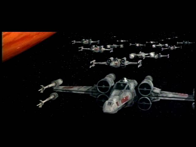

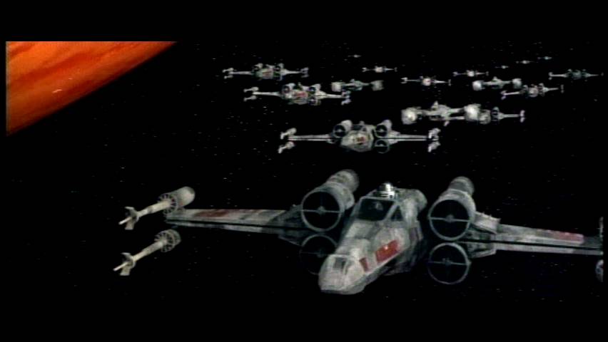

I'm going to recapture all of the LD's and preserve my LD Player. Below are a few pictures that I wanted your opinions on. I DVD's were captured in IRE0 using S-Video, but I captured using IRE7.5 and composite video. I know S-Video is supposed to be better, but I don't get the dot crawl with composite. I experimented with 16:9 and 4:3 as well as the setting in TMPNGEnc (Output YUV data as Basic YCbCR.....) checked and unchecked.
The pictures labelled a have the Output YUV data as Basic YCbCR..... setting checked and the ones labelled b have that setting unchecked.
This one is 16x9 Output YUV data as Basic YCbCR..... turned on.
This one is 16x9 Output YUV data as Basic YCbCR..... turned off.
This one is 4x3 Output YUV data as Basic YCbCR..... turned on.
This one is 4x3 Output YUV data as Basic YCbCR..... turned off.
Let me know which one looks best. Thanks.

The bottom 3 pictures don't appear, but I'll tell you what settings I used - I captured via composite too btw.
I tick the 'output yuv data as basicYCbCr' in order to get the full range of black to white - 255 levels. The other method uses 235 IIRC and you get grey blacks and reduced contrast.
I then use the colour controls (I'm using TMPGenc) to increase the gamma by 30. I do this so that the brightness matches the same brightness the player gives on my tv when playing straight from the laserdisc. Otherwise the dark scenes hide too much detail.
I also increased the brightness and contrast by 10, and reduced the red by 25. I used a little noise reduction too - 20 1 20.
0 ire is 0milivolts from your player to depict black, and is the PAL standard. 7.5ire is 0.49mv IIRC, and is the NTSC standard. Using 0 for NTSC means blacker than black and then calibrating your display for white and black levels might be an idea if you want to see all the shadow detail etc as anything below 0.49mv will be black, instead of grey shades down to 0 which should be black. The PC seems to do something diferent again, so maybe you should capture as NTSC and 7.5 ire with the settings above. I haven't fully read what others have said or done with that, so I'm just giving my opinion.
If you can get the other pics up, that would be handy, and also try my settings and see what you think. Let me know how you get on.
Gary. -
Thanks Gary. I'll have to try those settings. I think my IRE 7.5 captures look better than my IRE 0 ones, but I haven't tried any color correction yet. I like how my composite captures don't have dot crawl. I believe dphirschler is right about the LD's being stored composite as I didn't notice a loss of detail. Do you notice any loss of detail in my 16:9 pictures?

The pictures labeled "Output YUV data as Basic YCbCR..... turned on" definately look better than the other pics were you did NOT turn on that option.
This makes sense since most DV codecs (including the Canopus DV codec) should have that option checked on.
I think the 16x9 image looks good. I would go that way. Even if you don't have a 16x9 TV now you might eventually.
Although since this whole SW thing is so ummm obsessive based ... you might want to do one 4:3 and one 16x9 if you only have a 4:3 TV at the moment
Thanks for the advice. The only thing I worry about with that Output Basic YUV option turned on is that you can't see quite as many stars in the background. The color looks better though.

Back to the colors. I'm having a tough time deciding. IRE0 with Output YUV.... to my eye on the TV are the settings that are the closest match to the colors on the LD's. However, I've also read somewhere that color reproduction on these LD's wasn't the greatest. Even though the colors are a little different, I actually prefer the way IRE7.5 with Output YUV.... unchecked looks. If I check Output YUV...., most of the stars in the background are not visible during the space scenes. Maybe there is a happy medium with Gary's settings, IRE7.5 and Output YUV... checked.
