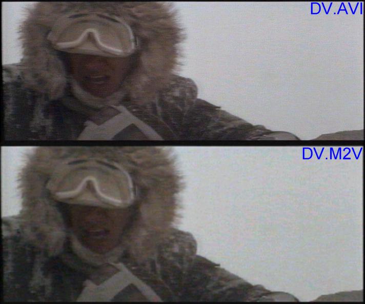

Mythos2002:
Here's your Empire frames for comparison!
Frame 1 is the .avi captured as follows: LD Player (S-Video + RCA Audio) Sony DV Camcorder (Firewire) WinDV.
Frame 1 is 720x480 @ 29.97 fps as Uncompressed RGB24.
(I used the Panasonic DV Codec to capture from the DV Cam, but VirtualDub reports no compression on the .avi file.)
Frame 2 is the .m2v coded as follows: TMPGEnc 720x480 @ 29.97 fps, 2-Pass VBR 0/5000/8000 with no filters and no additional processing.
This frame was the worst frame I could find in the sequence. Hope this helps, but I don't see any frames where the face is obscured enough to match your description.

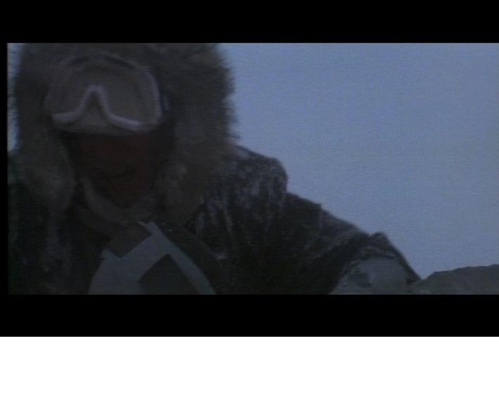

Thanks indolikka
Here is my image. I didn't use any noise filters on mine. I've pretty much scrapted noise reduction all together because it tends to make things worse. This image came from the source range filter inside TMPENG. I can't figure out how to get a picture from Windows Media Player.
I'm still trying to work on the Aspect Ratio and GOP picture settings. My image doesn't look good, but it is an improvement over what it would be with noise reduction.
