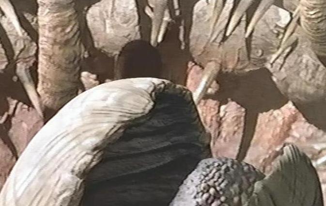

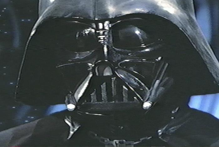

Hi peoples.. TGIF all 8)
@ all..
Actually, that looks a lot like VHS (fullscreen I presume)
Looks like those shots are from his .AVI (see interlaced lines)
Still, even on VHS, I wish I had the Widescreen version - it would be so
much fun converting to CD/DVD :P
-vhelp -
im confused. looks noisy, its been 3 years doing this and that could be the only thing i've never heard of.Originally Posted by DivXExpert
