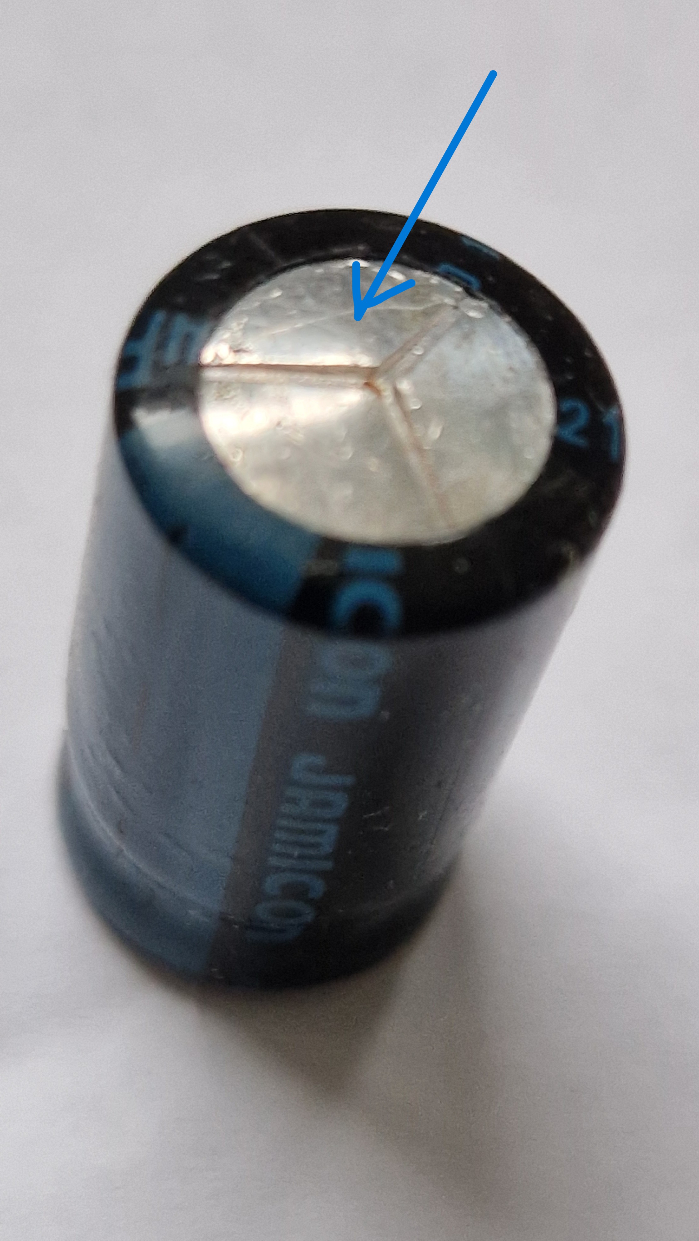

  2. Cold (unless extreme cold) is usually less harmful than heat and high humidity and pollution. Also, you can't expect that 2 VCRs - even of the same model - will play the tape exactly the same ("analog" tolerances, different age and wear). I don't think dirty heads are the problem either - but we have not seen a sample capture and assume that the VCR settings (TBC, DNR) are identical for your comparison.
    As a first step I would remove the cover and visually check for bulged or leaking electrolytic capacitors.
    [Attachment 94067 - Click to enlarge]
    Last edited by Sharc; 17th Oct 2026 at 04:14. Reason: Picture of a bulged defective capacitor attached
