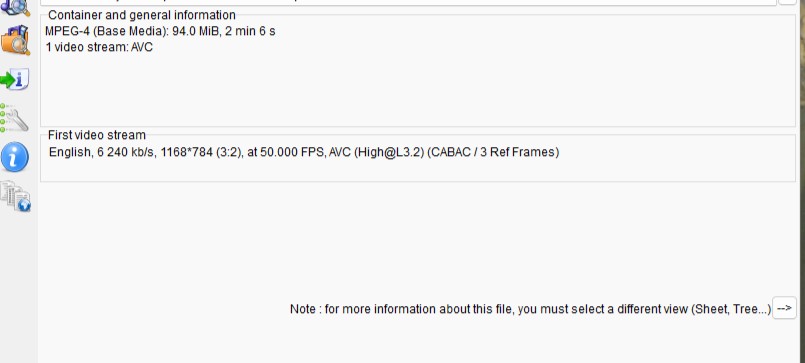

Is there a way I can change how Vegas reads/interprets the frame rate of a video file without re-encoding it (eg: with some type of file editor)? VLC plays it perfectly. Vegas is not so forgiving (or intuitive). It's supposed to be 50 fps....Vegas is reading it as 12,800!! And obviously, it won't let me adjust (otherwise I wouldn't be asking).
Thanks,
Joe
[Attachment 93974 - Click to enlarge]

The dialog you posted is from the video itself. Did Vegas match the video properties when you dropped it on the timeline and, if so, what does the Project Properties dialog show? If it is also 12,800 fps, what happens when you press Alt-Right Arrow to advance one frame at a time? I suspect you might not see any movement because it will take 12,000+ presses before you actually get to a new frame. Knowing the answer to that may help craft a solution.

What does MediaInfo say about the file's frame rate?

Look in the extended details, to see if it might have an incorrect "Original frame rate" flag, or a variable frame rate.
