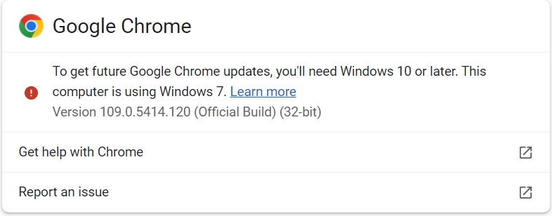

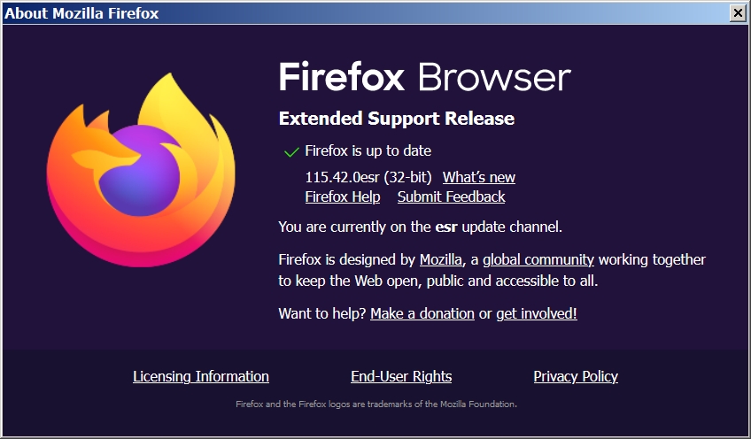

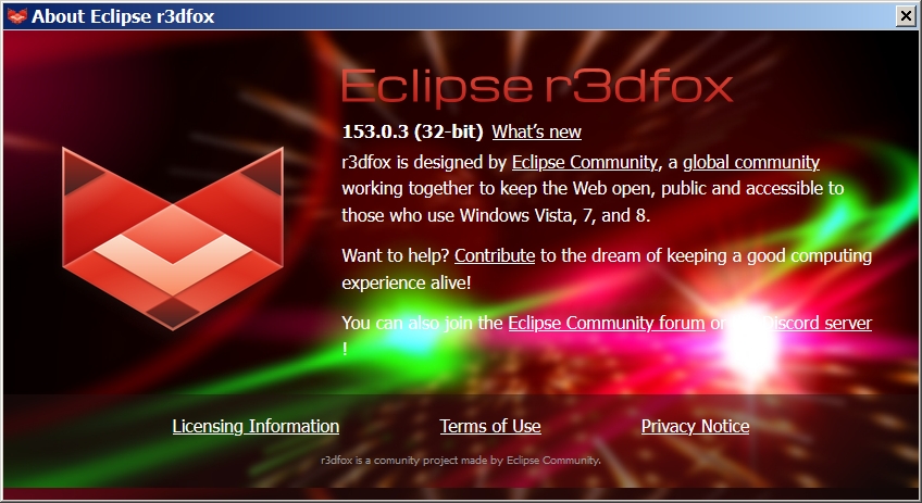

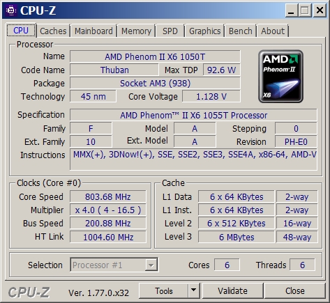

    1. Do you know what processor you are using? From Win 7 recollection It should be somewhere in computer properties on control panel (or a quick search on how should get you there)
    2. Your browser version - e.g. if its firefox - what version of firefox.
    Thanks!
  28. @cholla - give it a go again. The issue was the processor - the code claude wrote assumed that processor would support some fancy math module - which the AMD above just missed out on. 'I' re-wrote it so it should work on an older PC now. It should be live - all you need to do is reload the page.
