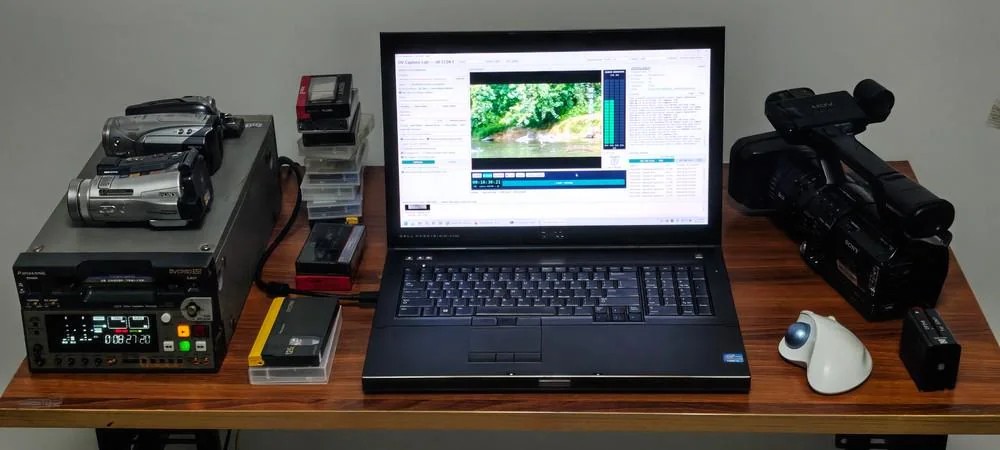

  1. I am working on a free, modern WinDV-style app for capturing DV/HDV, etc. via Firewire to a Windows laptop/PC.
    It's coming along nicely. So far these all work (from a select few decks/cams):
    DV, DVCAM, DVCPRO25, DVCPRO50 (incl. 4-channel audio), HDV (incl. 4-channel audio), Digital8 (and Hi8/Video8 if run through a suitable Firewire equipped cam).
    Still in the works is: MicroMV
    It does scene splitting after capturing an uninterrupted native master file.
    It has a ton of features but is hopefully not too cluttered, and simple enough to use.
    Main goal is to preserve/archive the tapes' footage, so there's no transcoding or recompressing.
    [Attachment 93611 - Click to enlarge]
