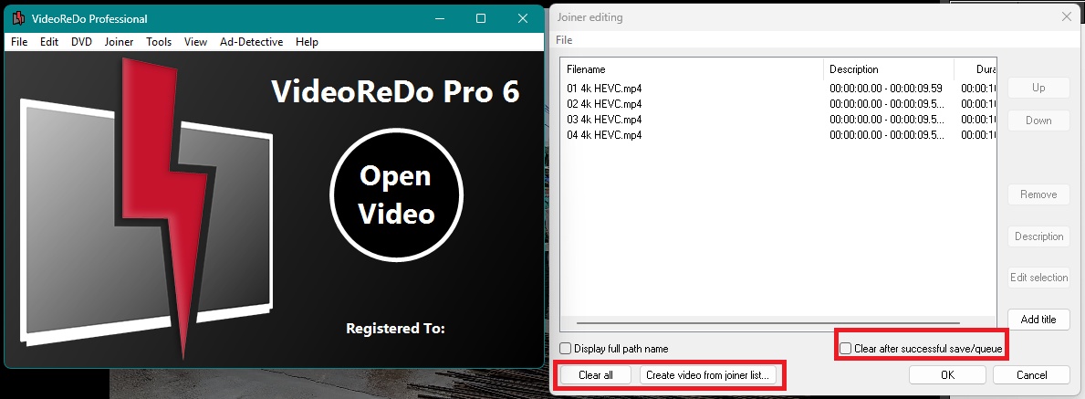

    Your Joiner Tool
    This feature works, but very differently to the way it does in VRD (see my 2 video Links below for comparison)
    I opened the Joiner tool and loaded up 8x 10sec clips (all were 4k/60p HEVC) and when i click OK the joiner box closes (it needs to stay open) so when it closes i need to then click on the Create a File from the Joiner list, i need to add an Export file name, and i need to select an export format from the 8 export formats in the drop down list, BUT there is no option to select an Export destination, the Joined Export file automatically goes to the Source File folder, which i am not so fussed about, but i am just used to having all of my source files stored on a 500gb Crucial T500 Pro NVMe drive, and i send all of my exports to a 1gb T500 Pro NVMe drive.
    Issue 1: The Joiner list box needs to stay open after files are added, and the Create Video from Joiner List button should be at the bottom of the Joiner list box so i don't need to exit the Joiner box to run the export, not a deal breaker, but it would be nice to see it work as it does in VRD.
    Issue 2: Allow us to select a different export location if we want to do it that way, again it isn't a deal breaker, but it would be nice to have this option.
    Issue 3: I don't get my profiles list shown when saving my Joined file, which i do get in VRD, so it seems like your Joiner tool is set up to only export back to the same format as the Source Files, in VRD we can select a different format using any of the built in presets, or one of our own custom presets, but i am not so fussed about this to be honest, i can simply join my files and export to Same As Source, and then export the joined file to another format if needed.
    Issue 4: When i start the export the SC64 Interface just stays on my screen and i can't see the progress of my Export, and i don't know when it has completed, i basically need to go to the Source File folder to check that the export actually worked.
    Issue 5: I tried to join 42x 15 second files, they were 720x480 HEVC files, i repeated the same process as per the video below, and it did not work at all, not with these files at least, but i will keep testing with this.
    https://streamable.com/aly73t
    VRD Joiner Tool
    Below is a link to a video recorded using Bandicam showing VRD running a Joiner List export (intelligent recode)
    These were the same 8x 4k/60p HEVC clips as per above, each one 10 seconds duration (80 seconds total) and i exported them to 1080p HEVC (intelligent recode) and the export took 205 seconds to complete (approx 2.5 times the file duration)
    I exported these to 1080p just to show that VRD lets me export back to original format (Smart Render) or export to other resolutions using one of my own custom profiles.
    I cut most of the export segment out of the video to keep the file duration shorter.
    https://streamable.com/t2b62t

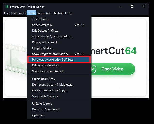

    Hi again, well i had a very dramatic thing happen at 2am this morning, i was running one of my tests, i think it might have been the Batch Tool test, and for some reason i decided to check if i had hardware acceleration or software acceleration turned on, and i stupidly clicked on the Tools Tab at the top of the Interface and then clicked on the Hardware Acceleration Self-Test option thinking that this was where we can select or change it, and when the Self-Test tool opened on the screen it began the test, and just after that my Computer froze and locked up, and it sat there for 20 minutes thinking it might fix itself.
    After waiting, i just decided to shut down using the power button, but on restart, i was taken straight to the System Diagnostics screen saying that my encrypted Windows drive had suffered an issue with the Veracrypt Bootloader (it was damaged) and normally this can be fixed very easily by using the Veracrypt Recovery Files that are copied to a USB drive during the Encryption process, BUT in my case, i selected the option to bypass the USB Recovery part of the Encryption as i already had the Recovery USB from a previous Encryption.
    That was a big mistake on my part because i found out today from Veracrypt that each time you Encrypt a System Drive, Veracrypt creates a completely new set of Recovery files, so i need to make sure that i don't make the same mistake again.
    The Good Bit: Luckily for me, the very same day i had run a Clone of my System Drive onto my spare Crutial T500 Pro NVMe drive using my Hasleo Disk Clone Pro software (i usually do it once a week) so i just opened up the Dell Pro Max PC and installed the Cloned drive and booted from that.
    I still can't work out why the Hardware Acceleration Self-Test option caused this issue, and nor does Veracrypt when i contacted them.
    [Attachment 93984 - Click to enlarge]

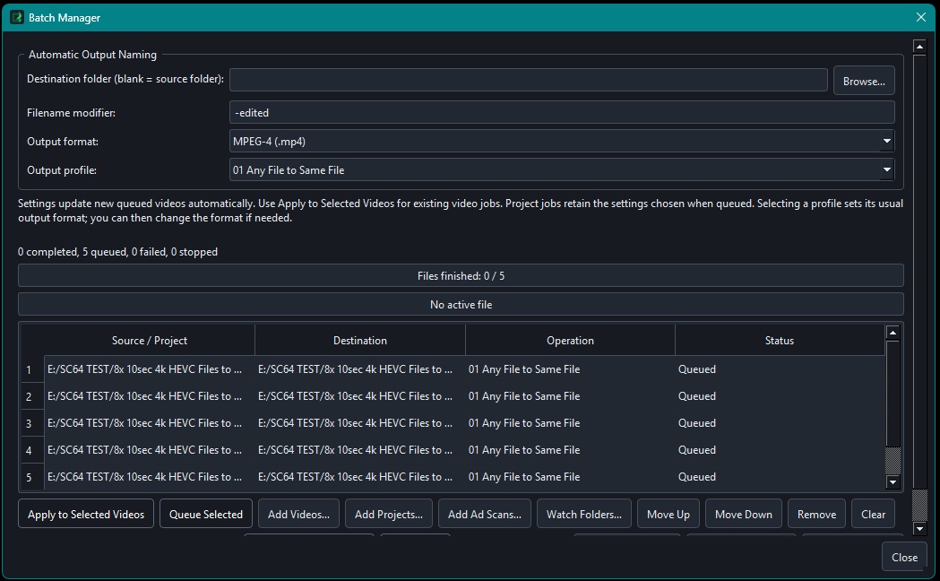

    Batch Conversion Tool - I posted about the Batch Tool in a previous post, but i just found an issue that i had not noticed before.
    The Batch Tool works, i loaded up 10 short (4min to 10min) 720x480 AVC files and exported them all to 720x480 HEVC and the conversions completed as they should have, same results as i got doing the same Batch Job in my VRD Pro, except for a vast difference in the HEVC video Bitrates between both tools (see notes at bottom of this post)
    Issue 1: Once i open the SM64 Interface and select the Batch Tool, it opens up on my screen, i load up the files, select the profile and destination, and then click the RUN button, but the Batch Tool closes and i am left with the SM64 Interface on my screen, i saw the CPU and ram usage go up so i knew the files were being processed, but i had no way to check the progress unless i went to my Destination Folder to see the progress, so this seemed a bit odd to me, so i opened the Tool Menu at the top of the User Interface and clicked on the Batch Tool again and the Batch Tool came back up and showed the progress of the Batch conversions.
    In VRD the Batch Tool stays open once you start the Batch process, and you can see your files at the top being processed, and when each file is completed it drops from the file list at the top down to the completed list at the bottom.
    Issue 2: There is no way to Pause or Stop the Batch Conversion process, least not that i can find, this is a must have feature inside the Batch tool itself.
    Issue 3: Even tho there is an option to select your Export destination, the batch conversion files are going back to the same folder where the Source files are located, just as what happens in the Joiner tool as i mentioned in a previous post.
    I will do a screen recording of the Batch Tool in my VRD Pro when i get time.

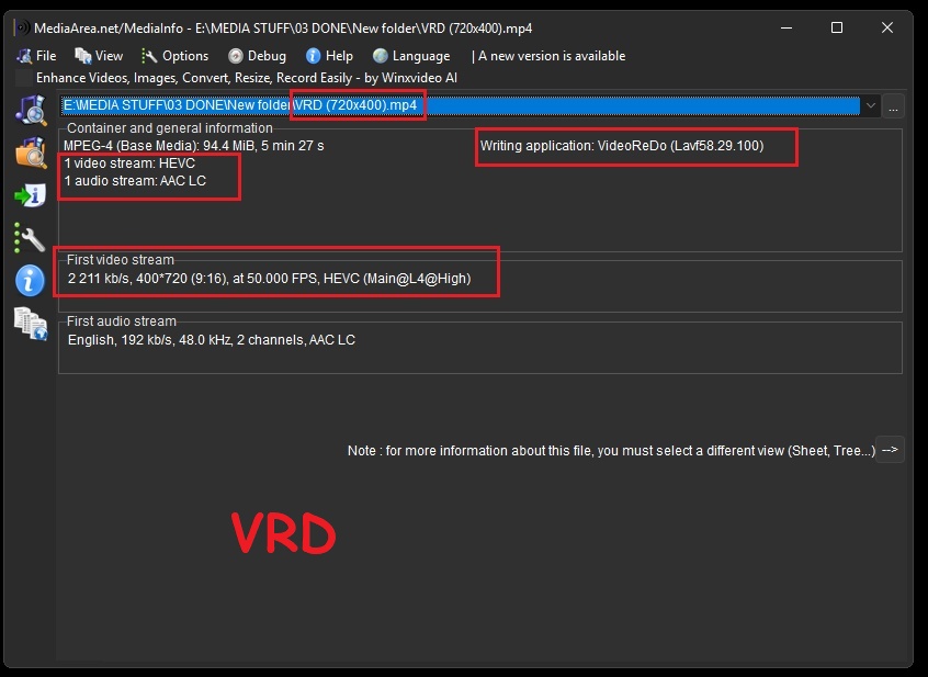

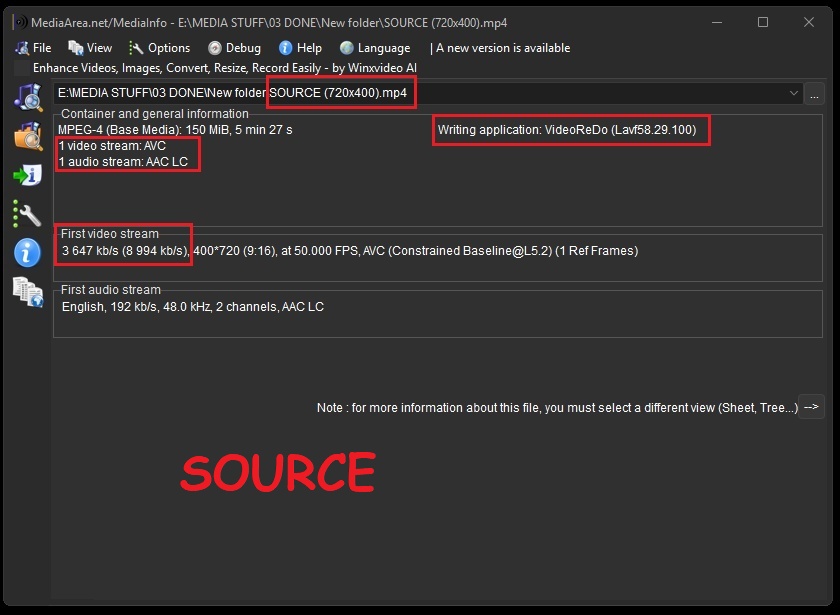

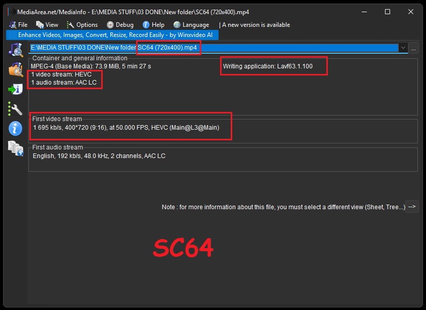

    Video Bitrate for Encoded files. I have tested some 720x480 AVC files and converted them to HEVC using the same export profile in VRD and SC64, and i am getting a very big difference in the video Bitrate of both tools.
    The VRD HEVC exports are around 35% lower than the AVC source files, but SC64 the Bitrates are between 50 and 60% lower, which to me is way too low, and i am using the exact same VRD Profile for both tests.
    Have attached 3 screenshots with the sorce file, the VRD export, and the SC64 export, i have no clue what all of the info in red means, but there is a difference between them.
    [Attachment 93994 - Click to enlarge]
    [Attachment 93995 - Click to enlarge]
    [Attachment 93996 - Click to enlarge]

  9. Thanks Bridgy, great feedback as always! Going through it all now
  10. Right then! SmartCut64 1.0.27 is now available on the website, with several changes prompted by your reports.
    The Batch window stays open and shows progress and completed jobs. Changing the profile and destination applies those settings to untouched queued videos. There are also controls to pause after the current file, resume and stop.

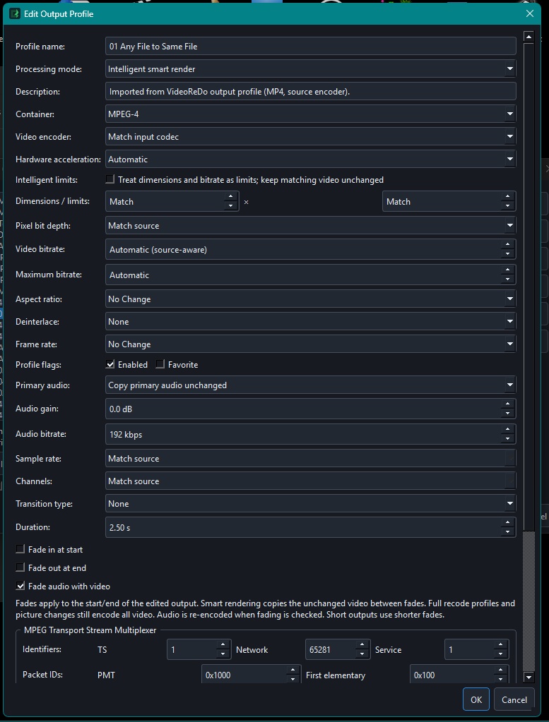

    Joiner Tool
    I used my VRD Custom Profile shown in the Screenshot at the bottom of this Post.
    1- 8x 20sec 4k HEVC Smart Render to 4k HEVC = Works immediate export
    2- 8x 30sec 960x540 HEVC Smart Render to 960x540 HEVC = Works immediate export
    3- 10x 2min 4k AV1 Files Smart Render to 4k AVI = Works 10 to 15 sec export time
    4- 10x 15sec 720x480 HEVC Files Smart Render to 720x480 HEVC = Output Header Failed VRD can Export these Files in Joiner tool.

    The Not so Good but would be an easy fix.
    - Needs an option to add Chapter Marks at Join points, i set the Chapter markers in the Tools menu in the main Interface but it did not apply to the Joiner export, so adding a Chapter tool option in the Joiner tool might be better.
    - I was going to request an option (tick box) to clear the Joiner List on Closing it, however this is not critical as the Joiner list can be cleared manually before closing it, or cleared when opening it again the next time.
    I have had times in VRD where i had this box checked, and upon checking the exported joined file, there was an error, went back to the joiner list and they were all gone, i just had to load them back up again, no big deal.
    Now i can see just how old VRD really was/is with it's User Interface and how the Joiner and Batch Tool boxes are laid out compared to SC-64, and i am loving this tool more and more every day.

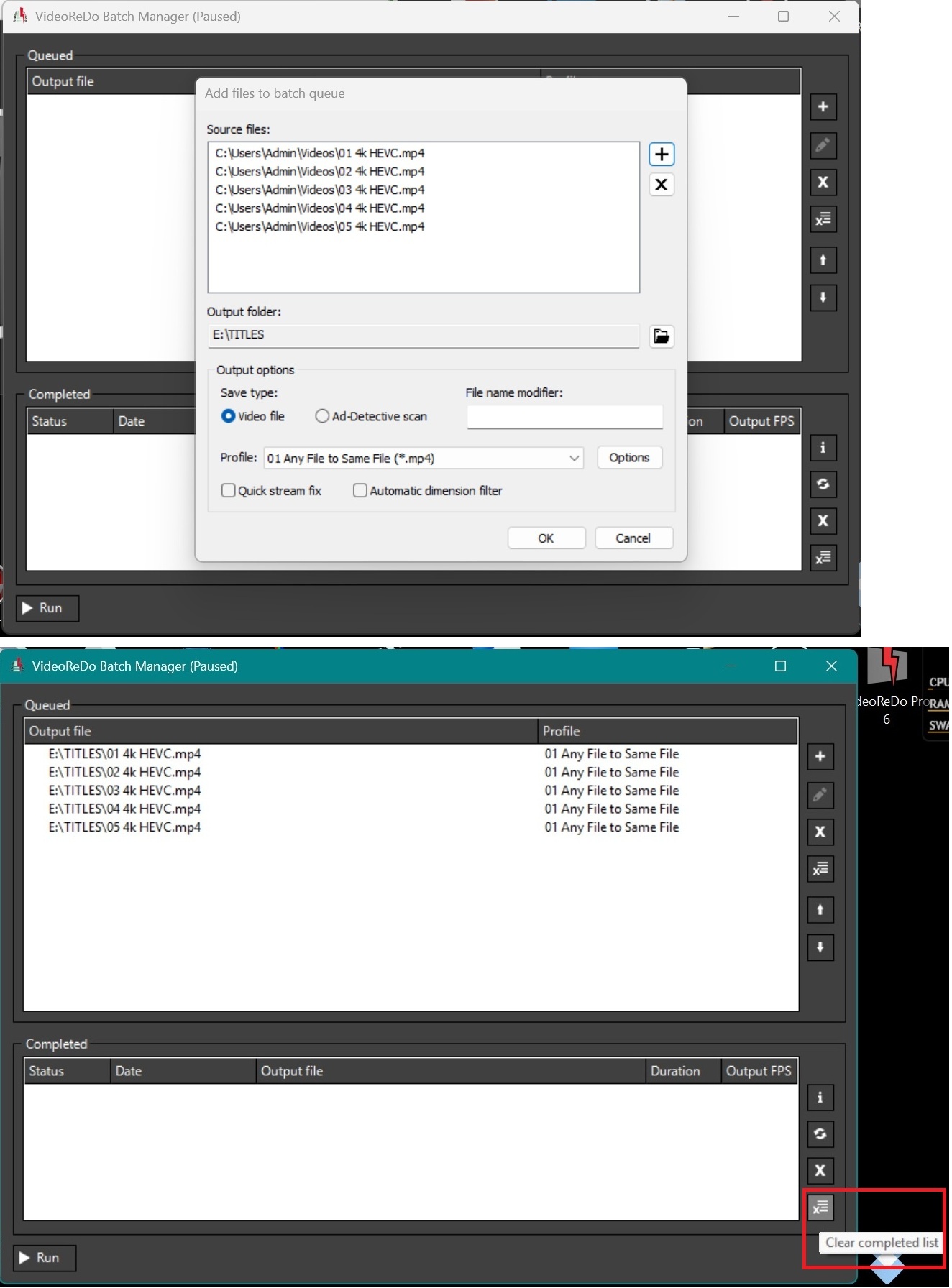

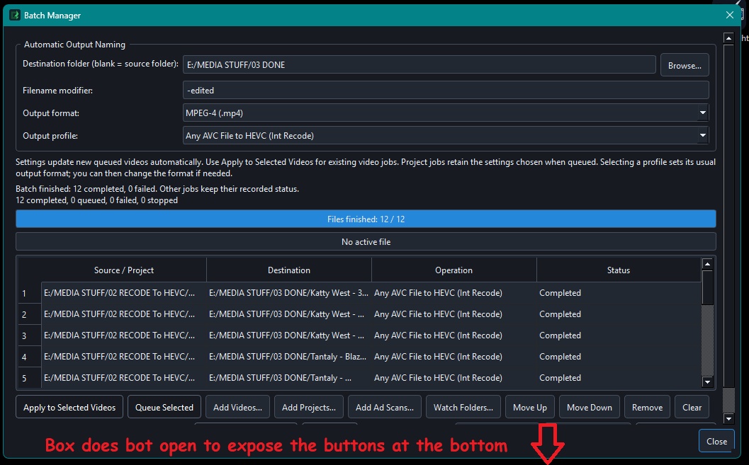

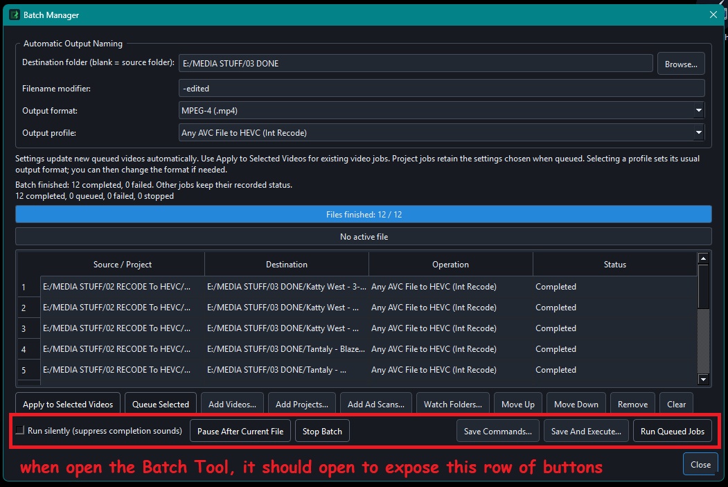

    Just curious if anyone has been testing TV Broadcast Files with SC-64 as it would be nice to have someone testing these to see how SC-64 is going for them.
    Batch Tool Testing is done I used my VRD Custom Profiles
    1- 8x 20sec 4k HEVC Files Smart Render to 4k AVC = Works
    2- 8x 30sec 960x540 AVC Files Smart Render to 960x540 HEVC = Works
    3-10x 2min 4k AV1 Files Smart Render to 4k HEVC = Works
    4- 10x 15sec 720x480 HEVC Files Smart Render to 720x480 AVC = Works
    The Good: Everything seems to work as it should, happy with the layout
    The Minor Issue: When opening the Batch Tool, it should open fully to expose everything in the Tool box, but when it opens, the Buttons along the very bottom are hidden and one needs to drag the box open from the bottom to expose it (see screenshots below)
    I love this SC-64 tool so far, and i definitely will be using it full time within the next month, after i finish testing the Titles Tool
    [Attachment 94016 - Click to enlarge]
    [Attachment 94017 - Click to enlarge]
    Below are the comparisons between the SC-64 and VRD Batch Tools, very different beasts, and SC-64 shows just how old VRD really is now days, yet back in the day when VRD was created it was touted as being breakthru, and i certainly thought the user interface (dark mode) was really nice.
    SC-64 Batch Tool
    [Attachment 94009 - Click to enlarge]
    VRD Batch Tool
    [Attachment 94012 - Click to enlarge]

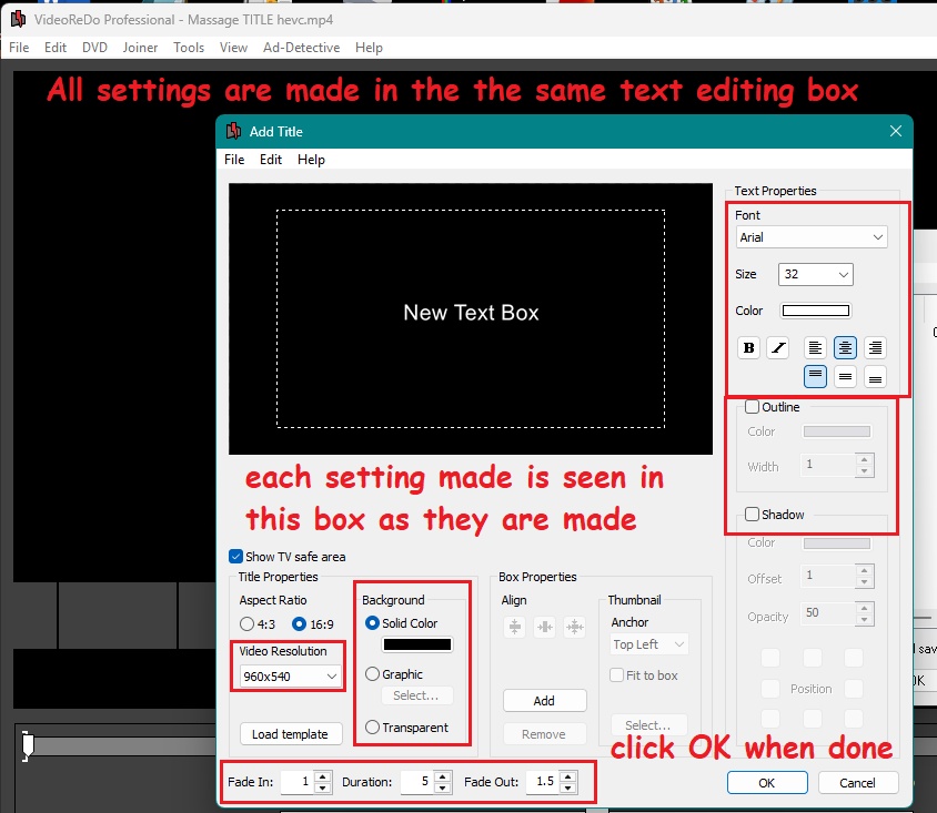

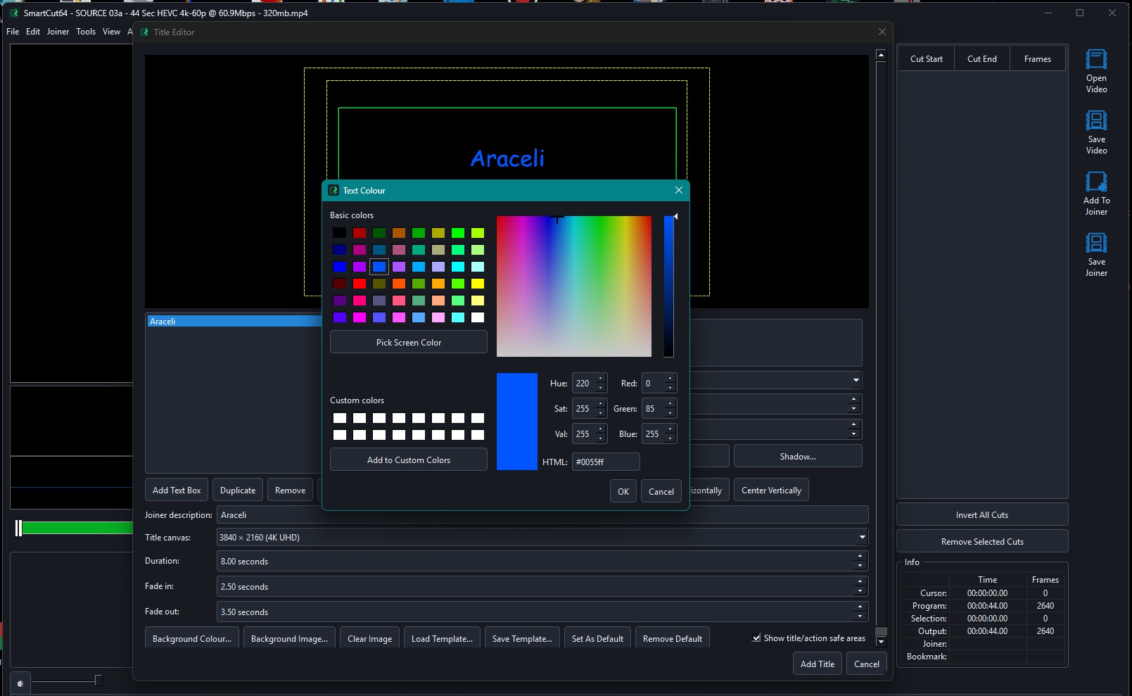

  14. Member Bridgy's Avatar
    Aug 2024
    Sydney

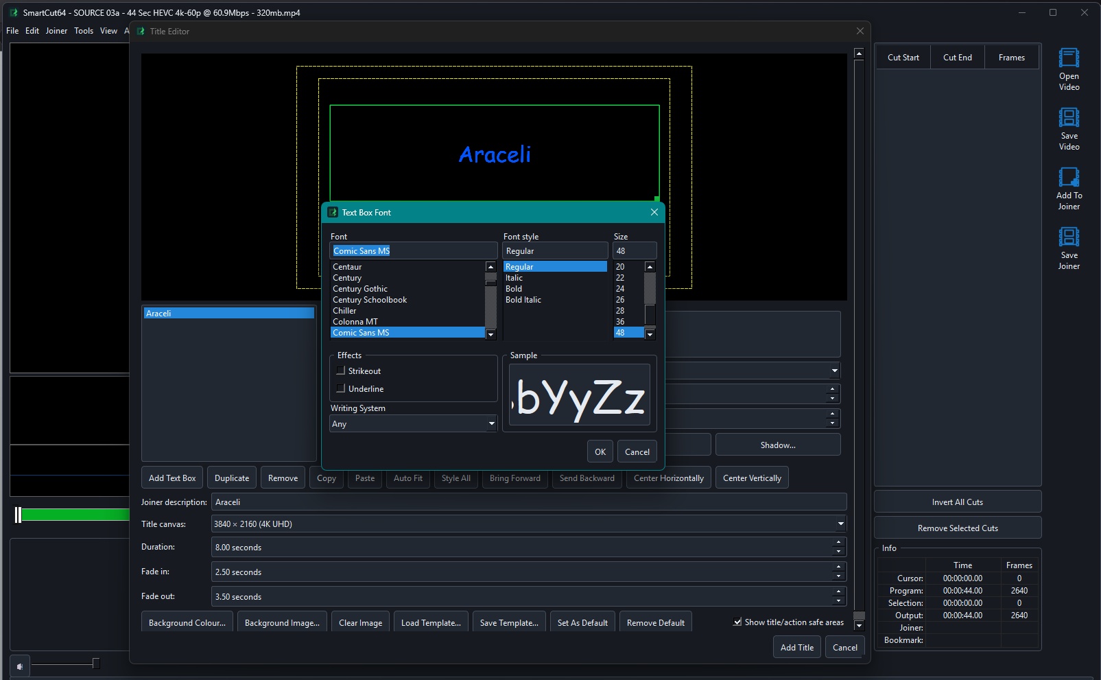

    Title Tool Testing
    The Text Box Color, Font, Outline, and Shadow boxes are separated as opposed to VRD where they are all in the one Title Editing box (see image below)
    I personally don't mind this, however i only need the Text/Font box and the Color boxes, so i have no need for the other 2.
    The issue that i see is that in the Text and Color boxes, when i make my selections, i don't see them until i click the OK button and and i am returned to the main title editing box to see the changes made, i like to see the changes made within each box before i close them and get back to the main Title box.
    In VRD these settings are made and i see them before closing the Editing box.
    I will have 2 videos of the VRD and SC-64 Title editing tools tomorrow.
    There are other issues as well from my testing tonight.
    SC-64 Text Font and Color Editing Boxes
    [Attachment 94019 - Click to enlarge]
    [Attachment 94020 - Click to enlarge]
    VRD Text Editing Box
    [Attachment 94021 - Click to enlarge]

    Testing the Titles Editing Tool continued
    This is a link to the SC-64 Title creation of a cut 4k HEVC file.
    https://streamable.com/gwp40r
    This is a link to the VRD Title creation of the same cut 4k HEVC file.
    https://streamable.com/ij8e6r
    Now to the Nitty Gritty of the SC-64 Titles.
    The Text creation tool works, but there are issues, and they can be seen in the Video if you watch it carefully, more importantly, you would need to know precisely what to look for, so i will try to explain the issues below.
    1. Add my file to SC-64 and do the cuts, i add the cut file to the Joiner List.
    2. I open the Joiner List and nothing was there, i closed it and add the cut file again.
    3. I open the Joiner List again and nothing was there, i closed it and added the file again.
    4. Open the Joiner List for the 3rd time and the cut file was there.
    Note: after testing this several times, it took 1, 2, or 3 attempts to get the cut file into the Joiner list.
    5. I click the Add Title button and create my Title in the text box.
    6. Set the Title duration and fades.
    7. Open the Text color box to change the color.
    8. Open the Font edit box and set the font style and size.
    9. Click to Add Title button at the bottom which closes the Title editor box and opens the Joiner List again, but there is no Title.
    10. I waited a few moments, then i clicked the Add Title button inside the Joiner List, and wait for the Title to appear.
    11. I move the Title File up above the Video file, select the export format and destination.
    12. I click the Create Video button at the bottom of the Joiner List.
    13. Go to the export destination folder and check to see if the export completed.
    Without wanting to compare too much to VRD, there is an issue with loading the Cut Video file into the Joiner list, and the same goes for the Title being added to the Joiner List as well, both should appear in the Joiner List pretty much straight away.
    I also need to see the Text Font settings and the Color appearing in the Title Editor box in real time as i am making these settings, as it works in VRD.
    I hope the Videos and explanation above helps resolve these issues.

    Now using Build 1.0.30
    I have been using my profiles from VRD so far with my testing, they seem to work ok, but i just decided to delete them, and create my own custom profiles in SC-64, but where does the saved Profile list reside in the software folder.
    Just completed a recode of a 44sec 4k HEVC file to 4k AVC using SC-64 and VRD, this time SC-64 was faster by 37 seconds, and the source file was only 44sec duration, in the previous Batch Tool export test of 8 various Files (see results at bottom of my previous Post) VRD was faster by 10 minutes.
    SC-64
    Encode time = 76sec
    Bitrate = 93Mbps
    File Size = 488mb
    VRD
    Encode time = 113sec
    Bitrate = 100Mbps
    File Size = 523mb
    SC-64 Profile
    [Attachment 94036 - Click to enlarge]
    VRD Profile
    [Attachment 94037 - Click to enlarge]
    [Attachment 94038 - Click to enlarge]

    Edit: I hate when software decides on its own to just add a context menu entry without any option and then you wind up with a HUGE number of entries when you right-click on a folder or file. Ever had a context menu window open up where it actually takes up the entire height of the screen? I have. I don't like it. So I disable the entries for software that I don't need entries for and it results in a far nicer experience. When software allows, I disable MOST entries. With respect to SmartCut64 I can just use drag-and-drop when the program is open or I can add my own shortcut to the Send To menu which works just fine for sending a file to the SC64.
