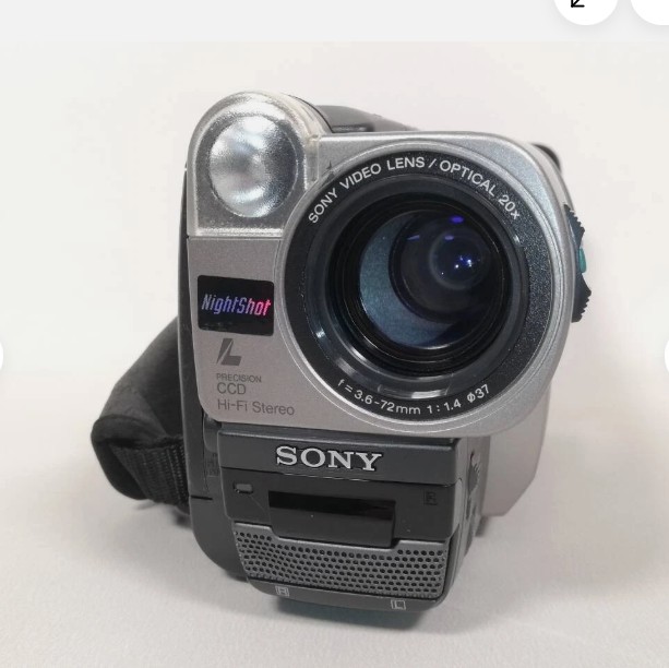

  11. I’m looking at this one, no built in tbc though. Will the es-10 work in the same way as it does with vhs?

  12. Even though es-10 will work with that camera, I would not recommend to purchase it because it doesn't have S-Video out.

    And it only has mono audio by the looks.
  14. Shouldn’t s-video connection with a pal es-10 be avoided? I can’t find the posts about it now but maybe something to do with whites being clipped on pal es-10’s being used as a pass through with s-video.
    Will mono audio be a problem?

    Not really a "problem" but you'll miss one side if your tapes are in stereo. I don't know a lot about Hi8, but some Hi8 camcorders recorded in Stereo and had S-Video Out and Stereo Out ports.
    It should work/stabilize the same as with any other analog tape source.
    As mentioned, it is mono and composite only, which is a bummer, of course.
    But if it is cheap and works well, maybe?
    And the ES-10 can help a lot with its comb filter to feed S-Video to your capture card.
    Not at all.
    The entire concept of "stereo camcorder" is rather silly, as it's just a single-sited microphone on the camera. It's more gimmick than actual stereo audio that was recorded on home tapes.
    I very much doubt Sony went to all that trouble (and menu programming as well, and the two audio jacks) for a gimmick.

  22. Capturing Memories dellsam34's Avatar
    Jan 2016
    Video8 format uses frequency modulation where the audio signals are modulated directly into the video carrier frequency and read by the video heads, The left channel is multiplexed into the right channel, If the camcorder picks the main right channel and ignore the secondary one then he will miss one channel, So people standing on the left side of the camcorder their voices may sound low, Being a low end camcorder, it could be designed to playback its own mono recordings only, so as a cost cutting measure, demultiplexing is not required to playback the main audio channel, That's how early camcorders were designed, only one audio channel.
    But if it process both channels and down mix into mono then that shouldn't be a problem at all being a single point shoot camcorder, The angle of stereo on consumer camcorders is very narrow.
    The other thing is some Hi8 camcorders did have PCM audio capability, So if his tapes have digital audio he will be missing out on a great audio quality.

  23. Originally Posted by dellsam34 View Post
    Sorry, but you're not correct about how camcorders record audio.
    They don't record left and right channel. They mixed them the same way as FM Stereo. So there're 2 channels: mix of left+right and mix of left-right.
    So, if you read "mono" channel left+right then you get mono. If you read both channels, then you can restore original left and right channels by applying the second mix as is and as inverted phase right-left.

    Yes, something like that, I don't remember exactly how it is multiplexed but I know there is multiplexing/demultiplexing going on, My point was that depends on how the mono camcorder is processing the audio channels, One has to look up its service manual to see exactly how those L and R channels get demultiplexed and downmixed to a mono channel or is it just picking one audio channel from the get go.
    It's hardly a gimmick when I record my videos using stereo camcorders and often get complaints about my voice being louder in one channel than the other, depending on which side of the camera I happened to be on when I was recording.
    And playing a stereo tape in a mono camcorder/VCR is not "missing one side". It combines the left and right channels together.
