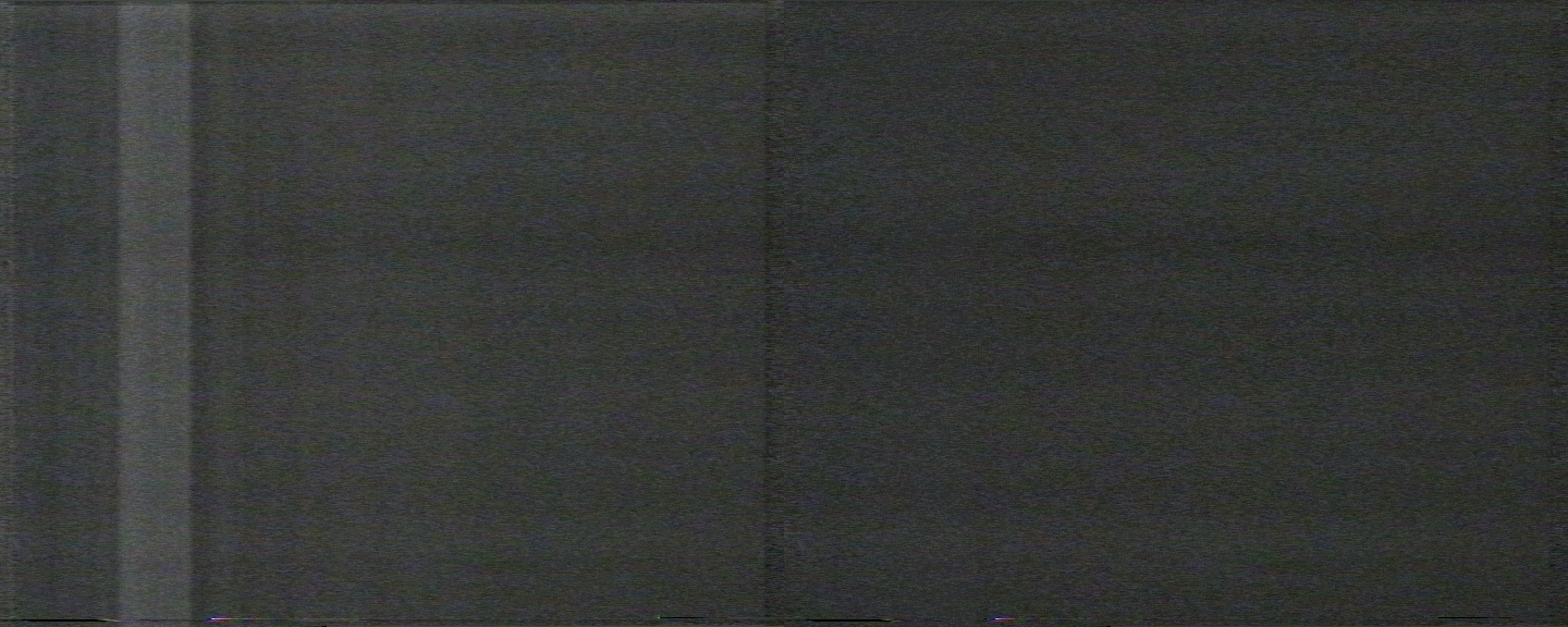

    Does anyone know if there is an existing function for Avisynth that can be used to adjust the brightness of a specific vertical section of the frame?
    One option that came to mind is to try using ColorYUV(off_y = XXX) on a specific part of the frame, but perhaps there is already a ready-made implementation for this?
    I’ve attached a screenshot and a short AVI clip showing the problem I’m trying to fix.
    [Attachment 93471 - Click to enlarge]
  2. Code:
    LWLibavVideoSource("example-1.avi")
    left = Crop(0,0,112,-0)
    mid = Crop(110,0,64,-0).ColorYUV(off_y=-3)
    right = Crop(174,0,-0,-0)
    StackHorizontal(left, mid, right)
    Using Overlay() and an alpha mask you could smooth out the edges.

  4. Originally Posted by jagabo View Post
    Thanks! I have to study overlay & masking (Crop-approach was something I was familiar with, but using only that alone leaves visible lines)

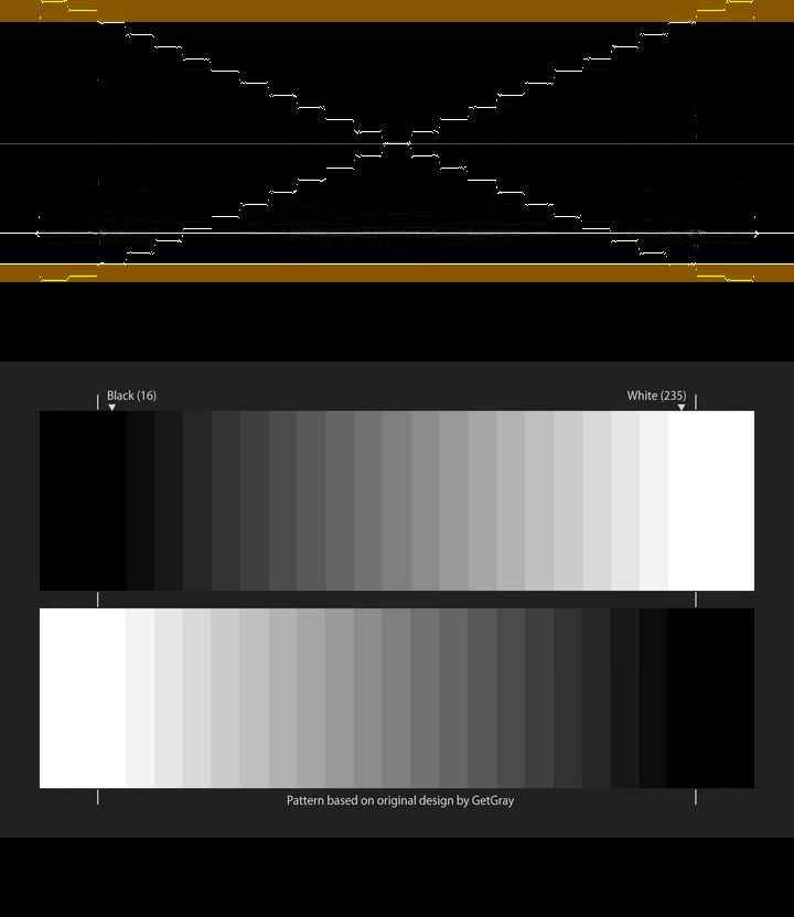

  8. Good exercise, yes. Here is an example with Y (0....255), with waveform (luma values) shown on top.
    The YUV video has been decoded using the standard Rec.601 (TV) matrix, therefore you can't distinguish the bars Y<16 and Y>235 as these became RGB(0,0,0) or RGB(255,255,255) respectively, see 1st screenshot.
    If it had been decoded (viewed) using the PC.601 matrix one would see the superblacks and superwhite bars (2nd screenshot). Now Y and RGB are mapped 1:1 means Y 235 becomes RGB (235,235,235) and Y 16 becomes RGB(16,16,16) etc.
    What your TV actually does and how it treats YUV data depends on its renderer. Usually it uses "studio equations (aka studio matrix)" acc. ITU recommendations. So it may show (some of) the superblacks and superwhites, but these are normally intended as leeway for over-/undershoots and other imperfections. That's why staying in the 16....235 luma range is good practice - at least for the final distribution. This is shown with the last screenshot. Now one will see all bars using the standard Rec.601 matrix.
    Finally, what you eventually see on TV also depends on its brightnesss and contrast settings.

  9. Originally Posted by Sharc View Post

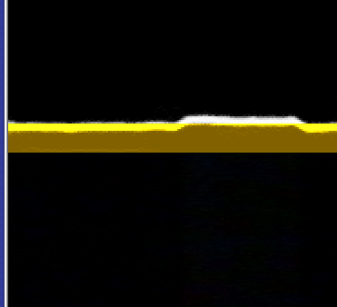

    I managed to adjust values to generate attached capture (VirtuaDub) for my own testing. My capture is displayed using "Rec.601 (TV) matrix" I assume

  11. Originally Posted by Rolletus View Post
    Yes. You can't distinguish the 2 superblacks and 2 superwhite bars because the YUV->RGB conversion using the standard Rec.601 matrix has mapped (shifted, clipped, crushed) these to RGB (0,0,0) and (255,255,255) respectively.

  13. Here's an example using the dark frames as a mask to darken the stripe away.
    src = LWLibavVideoSource("example-1.avi", cache=false, prefer_hw=2)
    #Average all the frames together to make an average frame
    src
    Merge(SelectEven(), SelectOdd())
    ColorYUV(off_y=-12).ColorYUV(gain_y=2800)
    bmask = last
    # make a black frame
    black = BlankClip(src).ColorYUV(off_y=-255)
    # darken the original video using bmask to control how much
    Overlay(src, black, mask=bmask)
    # before and after, side by side
    StackHorizontal(src, last)
    # brighten the result so we can easily see the difference
    ColorYUV(gain_y=1000)
    [Attachment 93501 - Click to enlarge]
    Remove the last line then filter further as needed.
    No brighter frames were included so you may need to modify this for the reset of the video.

  17. Originally Posted by jagabo View Post
    src
    bmask = last
    Thanks, You are so helpful here! I will test this and try to study those parts of the script I'm not familiar with so that I can modify it if/when needed.
