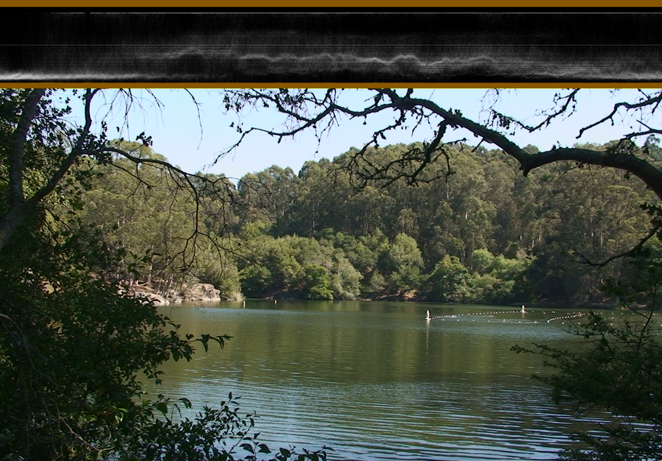

    I still have a problem with AVSPmod, While LWLibavVideoSource option worked for importing mpeg-2, it does not carry over audio, just video, Back to the drawing board.
    1. + LWLibavAUDIOSource.
    2. Top - BSSource channels, bottom - LW.LibavudioSource.
    They interpret sound differently, so there is an error in one. To be reported on the LWLibavAudioSource and BSSource github.
    Probably BSSource interprets correctly.
    The problem probably lies here:

    Channels in order from top:
    1. BSSource
    2. LWLibav
    3. ffmpeg >wav + BSSource
    4. ffmpeg >wav + LWLibav
    So I suspect that:
    a) use BSSource to open mpg
    b) use ffmpeg to convert to wav and load using BSSource or LWLibav
    c) definitely not open mpg via LWLibav
    But this would still need to be checked more thoroughly because I don't know what ffmpeg does with such errors.
