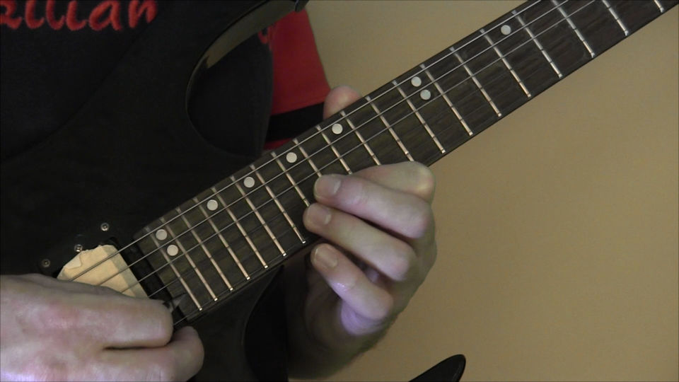

    I am trying to remove the green background from this video with Vegas, but no success. See the attached mask. You can see the problem is that Vegas considers my fingers be part of the backgorund. And this is what you can see infuelncing the outcome. I can set the balance so that the background is visible and also me, but around my hand the two overlaps and the background silhouettes are visible.
    Can you remove this more effectively with avisynth? I know the video is not optimal either. The problem is that in the room where the green wall is, if I turn on lights, there will be a shadow appearing on the wall. If I place led light source in front of me on the floor, with the LED panel facing upwards, the shadow goes but I only have 1 panel, and if I place more, it would cast another shadow anyway I think. So these are the conditons that you can see on the video where I can avoid shadows.
    Clip attached.

  2. I'm not great with mask creation, and I couldn't manage to create one based on color due to the amount of green in the pickup and frets, however it's easy enough to at least change most of the green to grey, or to change it to another color. Maybe that'll help if you're still needing to create a mask using Vegas.
    Maybe converting the green to grey will be sufficient. I don't know exactly what you want to the final output to be.
    Changing the hue of the green (no doubt not what you need, but to show you what I mean about the pickup & fret color).
    Tweak(hue=40, startHue=180, endHue=210)

  3. Go to youtube and look up how to do your lighting properly for chroma keying:
    https://www.youtube.com/results?search_query=lighting+for+green+screen
    You're going to need more than one light.
    With AviSynth you're going to need MaskHS() and maybe a brightness mask. Then Overlay() or Merge() with the mask. But you will need to fix your lighting first.

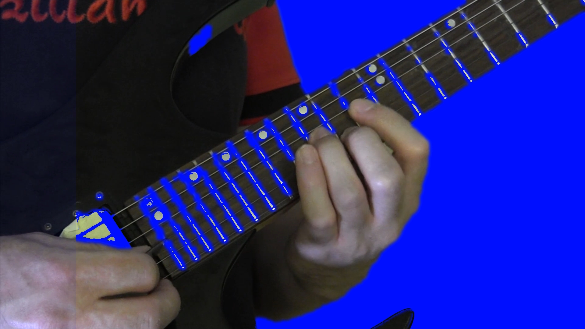

  10. Here's a crude version with VirtualDub:
    LWLibavVideoSource("Green background.mp4", cache=false, prefer_hw=2)
    bg = BlankClip(width=width, height=height, color=$0000ff) # blue for background
    cmask = MaskHS(StartHue=185, EndHue=200, MinSat=8, MaxSat=20).mt_inpand().mt_inpand().mt_expand().mt_expand().mt_expand().BinomialBlur(5).Spline36Resize(width, height) # a mask based on chroma
    bmask = MaskBrightnessRange(60, 135) # a  mask based on brightness
    gmask = Overlay(cmask, bmask, mode="multiply") # logical and of the chroma and brightness masks
    gmask = gmask.Crop(600,0,-0,-0).AddBorders(600,0,0,0) # clear out the left edge to cover the pickup
    Overlay(last, bg, mask=gmask)
    Some more tweaking should clean it up even more. It will be hard to beat the dedicated green screen filters in other programs though.

    function MaskBrightnessRange(clip v, int min, int max) # make a mask, if between min and max return 255, else 0
        minmask = mt_binarize(v, min) # above min?
        maxmask = mt_binarize(v, max, upper=true) # below max?
        Overlay(minmask, maxmask, mode="multiply") # logical and
        BilinearResize(v.width, v.height) # same size as source video
    64 bit VariableBlur for AviSynth attached.
    Thanks! The problem is that I still couldn't get it do it properly like Pixelcut. Not far though. Your version produces patches on the background side. The best I can achieve is this. This one has no patches on the background side, but between my fingers the green is still there sometimes, and blue appears on the guitar. However this is way much better than Chroma Key in many editors. And there is a zone on the left that is less saturated, why is it there?
    LWLibavVideoSource("Greenbackground.mp4", cache=false)
    cmask = MaskHS(StartHue=175, EndHue=210, MinSat=5, MaxSat=40).mt_inpand().mt_expand().mt_expand().mt_expand().BinomialBlur(5).Spline36Resize(width, height)
    bmask = MaskBrightnessRange(30, 145)
    gmask = gmask.Crop(250,0,-0,-0).AddBorders(250,0,0,0)
    [Attachment 93353 - Click to enlarge]
