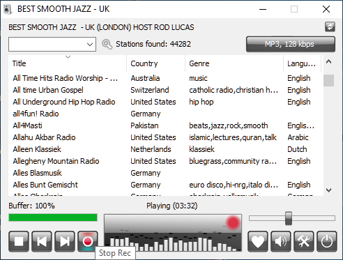

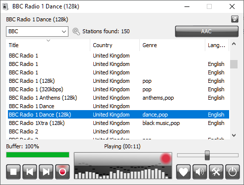

  5. Member The_Doman's Avatar
    Feb 2004
    Netherlands
    I myself use the (revived) RadioSure, really nothing beats that for internet radio on the PC.
    If your station is listed you can record the native streams directly.
    Make sure you update the radio stations database!
    RadioSure powered by Radio-Browser !
    [Attachment 93134 - Click to enlarge]
    [Attachment 93135 - Click to enlarge]

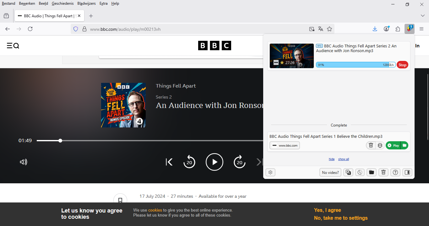

    Originally Posted by tecnofobe View Post
    Thanks Doman. I am mainly interested in recording archive material but I'll check it out.
    Aha, that is a different user case of course.
    Again, as an alternative, you could use a browser download manager or plugin to download the recordings directly?
    Not sure if this works on all BBC archive material you want but this is for example using the well known Video Download Helper plugin:
    [Attachment 93139 - Click to enlarge]
  8. Originally Posted by The_Doman View Post
    Thanks for the plugin advice. I got it and ran it with BBC Sounds audio I want but it just remaining in a 'Waiting for Media' status when I played the audio. How did you get it to display as in your screenshot? S
    Still not having luck with iMic, have tried many settings.
  9. Originally Posted by tecnofobe View Post
    It may take several seconds after pressing play (in the browser) for the audio to start playing and the plugin to detect the stream. After pressing the download button in Video Download Helper it took 40 seconds before the download began, then about 3 minutes to finish downloading a 30 minute mp3 file.
    Thanks. It worked eventually. Great plug in.
