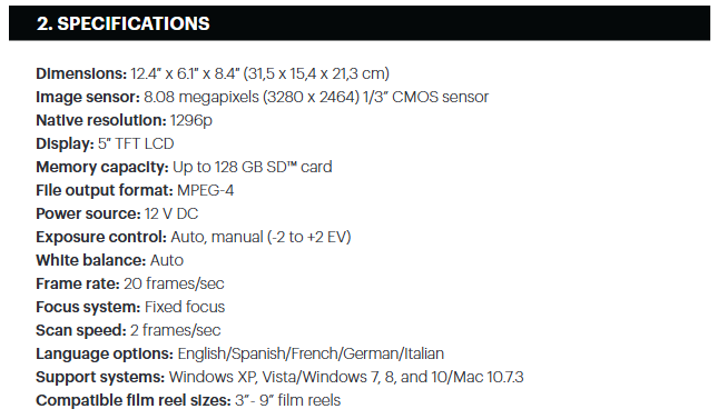

  4. Taken from the user manual (RTFM)
    -Up to 128Gb

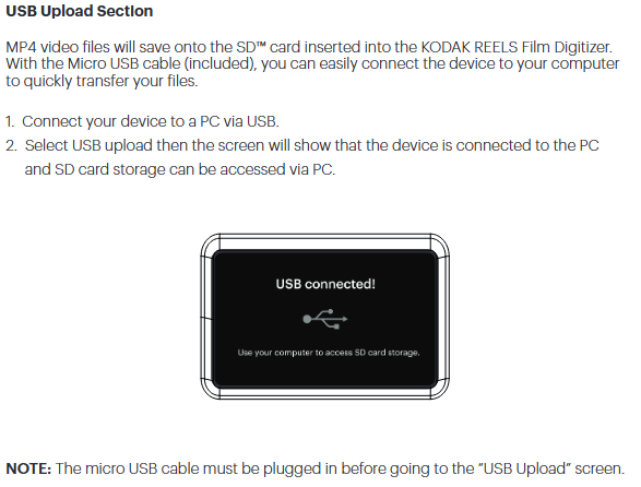

    -Transfer files to PC

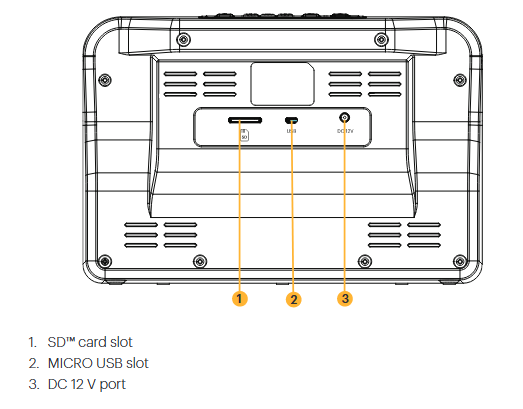

  6. First, I do not own this device.
    you can download a user manual:
    https://www.kodakphotoplus.com/products/rodreels
    [Attachment 93016 - Click to enlarge]
    You do not need a microsd card. For memory use the SD card slot (1)
    [Attachment 93017 - Click to enlarge]
    The kodak has a micro usb slot (2). This slot is to connect this device to a PC for file transfer.
    Use a cable from the micro usb slot to your PC.
