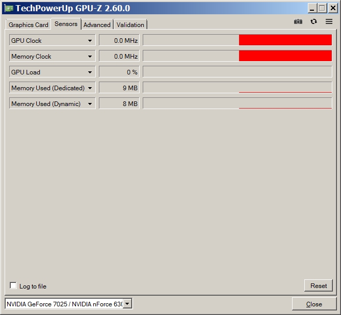

    My graphics card is : NVIDIA GeForce 7025 + nForce 630a (an onboard card).

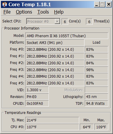

    This is a screen shot of GPU Z while ffmpeg is encoding a video. It shows no load.
    [Attachment 92702 - Click to enlarge]
    This is my CPU stats at the same time:
    [Attachment 92703 - Click to enlarge]

    Unless you are playing a video in a software that does this when converting the graphics card is not used.
    Using GPU-Z.to monitor my graphics (video) card.
    There is no GPU Load when converting with FFMPEG.
    If I use a media player like MPC-BE Then the GPU Load is 27 to 33%.
    Using Core Temp:
    Monitoring CPU use is different a conversion can be upper 80s percent & even bump 100%.
    Maybe bumping 100% could cause errors.

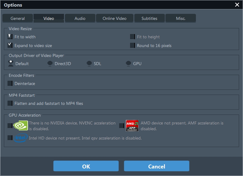

  28. AVC has an option to use GPU acceleration. I have it disabled though.
    Windows 10, MPC-BE
  29. I installed the version of AVC that works with Windows 7.
    It has a option for GPU including Nvidia but it is not available.
    Probably because I do not have the Nvidia control panel installed.
    The Nvidia show to be working in Windows Device manager
    As well as being detected by GPU-Z.
    The only time AVC showed GPU Load was when I used AVCs video player.
    It showed zero GPU Load when converting.
    [Attachment 92716 - Click to enlarge]
