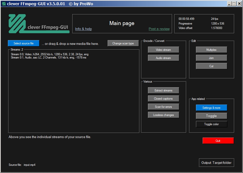

  2. Presetting: In the App related box. Select "Settings & more" button.
    Set the Target folder.
    It should also the location of the ffmpeg that Clever is using & version.

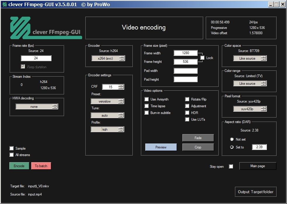

    Step 2. Select Video stream. Make the settings you want for the Encode of the Video.
    [Attachment 92600 - Click to enlarge]

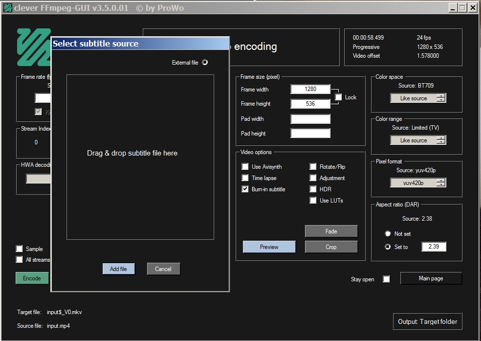

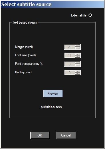

    Step 3. Check "Burn in subtitle" in the Video options box.
    Open the subtitle file in it.
    [Attachment 92601 - Click to enlarge]
    Step 4. Shows the subtitle loaded.Select OK.
    [Attachment 92602 - Click to enlarge]

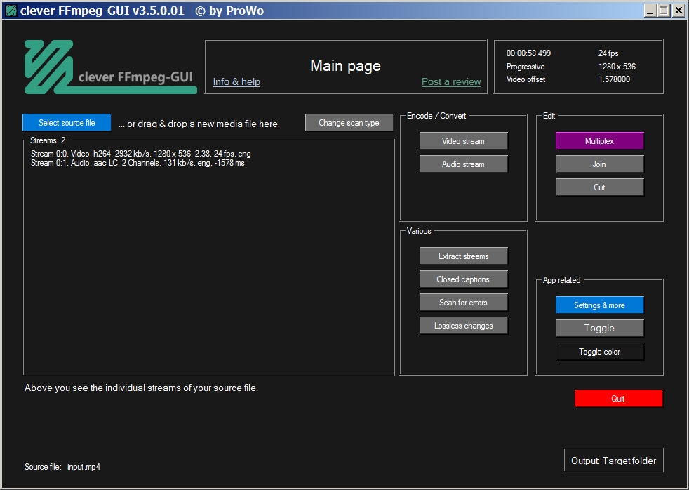

    Step 5. Select Encode. After it finishes Select Main page.
    Step 6. You can now see the purple Multiplex button.Select it.

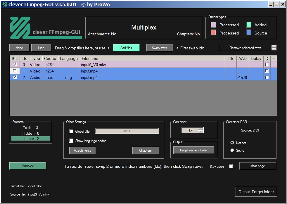

    [Attachment 92603 - Click to enlarge]
    Step 7. You should see 3 files in the window.
    [Attachment 92604 - Click to enlarge]
    Uncheck the original video file.
    Leave the New video file checked & leave the Audio file checked.
    Set the format you want in the Container box.
    Select the Multiplex button.

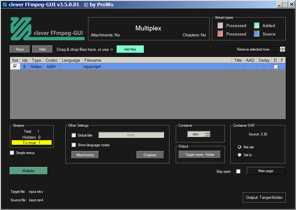

    Step 8. After the Multiplex there should only be one file in the window.
    Select Main page & close Clever.
    The new file should be in the Target folder.
    [Attachment 92605 - Click to enlarge]

  11. Originally Posted by Kracov View Post
    okay my issue is that the multiplex doesn't seem to hardcode/burn in the subtitles. I assume that's the only way to add subtitles. If it's softcode only, then Clever isn't an option for me.
    clever FFmpeg-GUI processes streams individually.
    This is because not all streams in a video necessarily need to be modified.
    Regarding your question:
    If you want to burn subtitles into the video, you’ll need to do that in the video encoding section.
    There’s a separate checkbox for that. You can use text-based subtitles (srt, vtt, etc.) or image-based subtitles (sup, sub, idx, etc.) here.
    Otherwise, subtitles are treated as a separate stream.
    You can add them to the video in the Multiplex section.
    So:
    The video stream is modified in the Encode Video section, the audio stream in the Encode Audio section, and existing subtitles in the Edit Subtitles section.
    After conversion, you’ll find all modified streams in the Multiplex section (along with all source streams).
    Here, you select which streams should be included in your final video, and then click Multiplex.
    You’ll then find your final video in your destination folder.
    Here you can check the result.
    Only the audiostream has been changed, from 6ch to stereo. (if was off by 900ms, fixed in the multiplex section).
    The videostream is yours, not changed.
