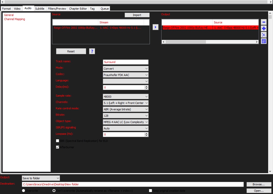

  1. So, apparently Xmedia Recode does not properly convert audio. I'm not sure what settings I should be configuring but the audio is grainy and distorted. I know it's an issue with Xmedia because these same videos convert just fine with other converters. Hopefully someone knows what to configure

    A close look at the image you posted shows the Audio as aac 0 kbps.
    To me that means there should be no audio to convert.

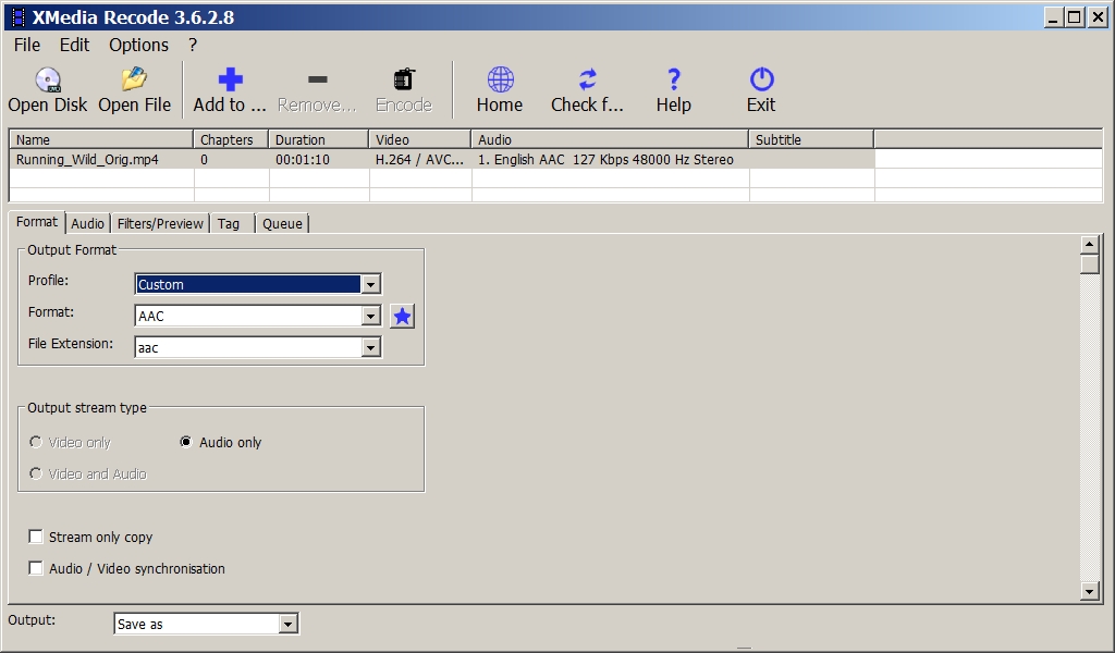

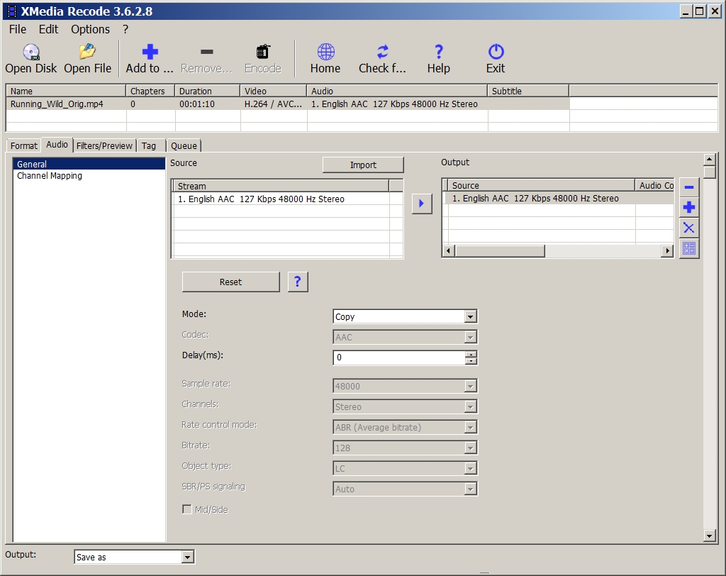

  12. Try an Audio only rip.
    This is the way I made the settings:
    [Attachment 92509 - Click to enlarge]
    [Attachment 92510 - Click to enlarge]
    Can you create a short clip & post it ?

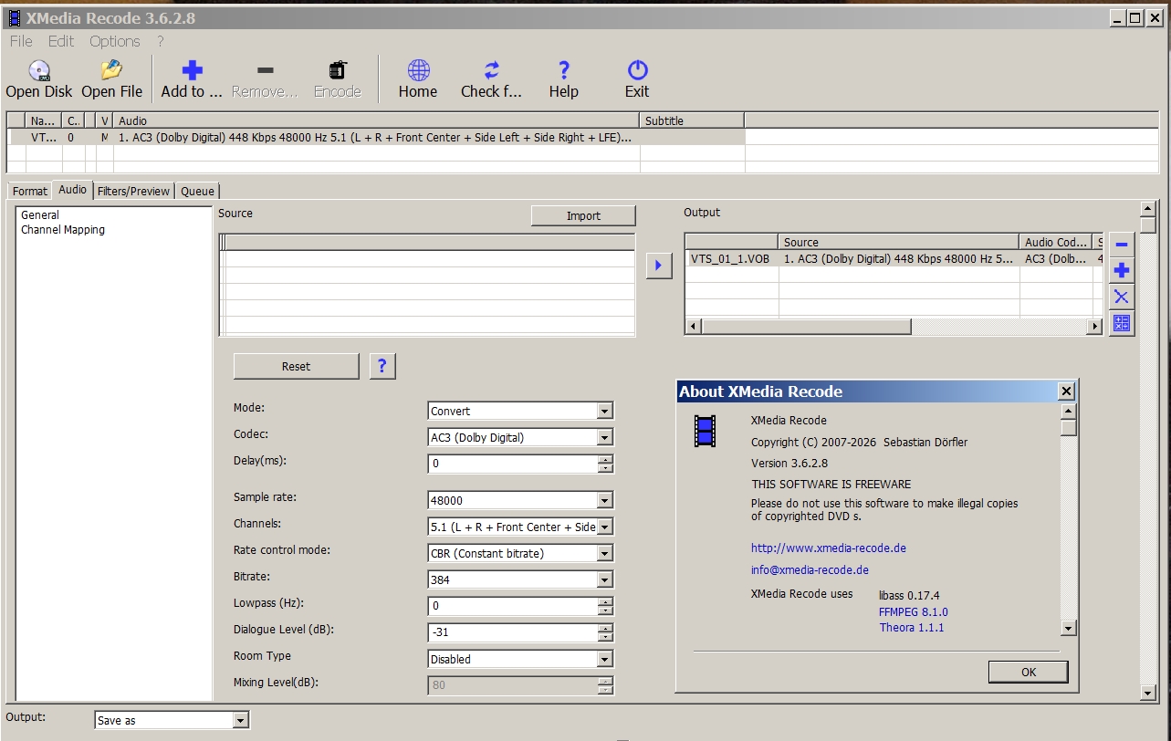

    In this case I would convert the original audio to ac/3 like this:
  23. there is no "ac3 dolby digital" in the list. I just installed the newest version.... not sure what to do
    Windows 10, MPC-BE
  24. Member
    Mar 2008
    I just downloaded the latest portable version, running on Windows 10. It's OK for me - as expected/
    Try the portable version
