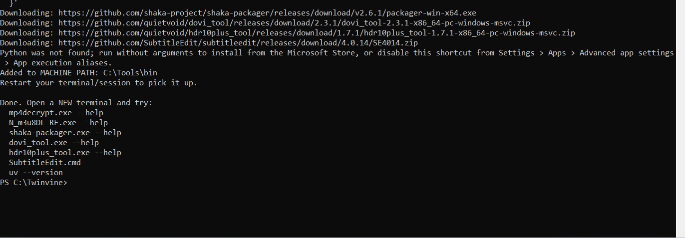

    Images of installation:
    [Attachment 92248 - Click to enlarge]
    [Attachment 92249 - Click to enlarge]

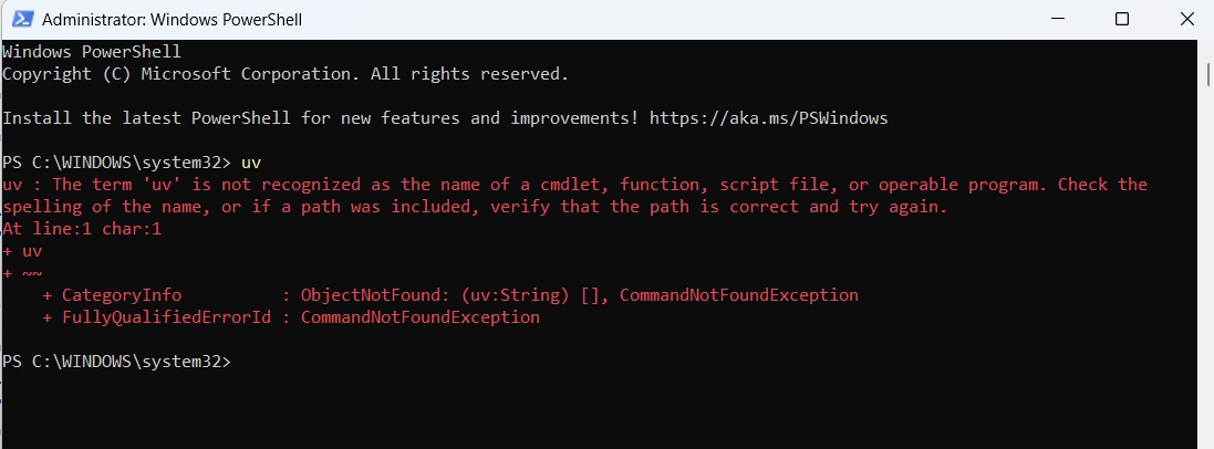

    Error Message:
    [Attachment 92250 - Click to enlarge]
    Installation went fine, It did take quite a while to download and install everything.
    I will be copying over my working envied.yaml from my win 10 pc and adjusting as necessary. any help with the above would be very much appreciated.

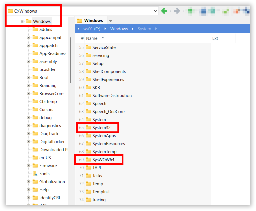

    system32... to be honest i didn't know i did... it's a 64bit laptop with 64 bit copy of win11...
  4. Originally Posted by LastResort View Post
    lol system32 is the core of all SO, 32&64 bit
    look on C:\Windows\System32
    [Attachment 92257 - Click to enlarge]

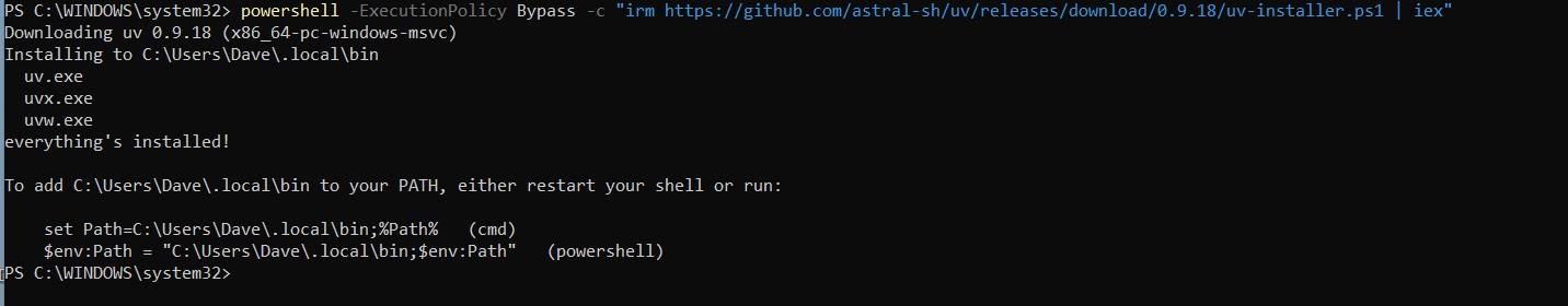

    I just love it when folks claim to have followed instructions exactly. Clearly you haven't because uv didn't install.
    The guide says:
    - Watch the installation, a number of binary files will be downloaded and installed to C:\Tool\bin. Installation will take a while. After finishing, close PowerShell and restart your machine.
    - Open Start
    - Type PowerShell
    - Type uv [return]. Expect to see a screen of help. If uv did not install from the Install-media-tools.ps1 script you will not see any response. Uv is a python package manager.
    - If uv is not installed close PowerShell and re-open as administrator, so
    - Open Start
    - Type PowerShell
    - Right-click Windows PowerShell → Run as administrator
    - Type powershell -ExecutionPolicy Bypass -c "irm https://github.com/astral-sh/uv/releases/download/0.9.18/uv-installer.ps1 | iex" [return]
    - Close PowerShell and re-start your machine.
    I've flagged up the bit you most likely missed in red. "Followed instructions to the letter"

  7. Thank you for the reply Angela..... I Have done as per your instructions but before I come back with another error, is it normal for powershell as admin to open as PS C:\WINDOWS\system32>
    I've been running powershell on my win10 pc for years, but in all honesty I've never really bothered to look at what it actually shows. I've just ran my win10 powershell as admin and it does indeed open in system32>
    lomero has planted a seed of doubt in what i'm actually doing.
    okay, I've found out that by typing in [intPtr]::size into powershell it shows either a 4 for 32bit or 8 for 64bit. both of mine are running 64bit powershell. So I'm going to go ahead with your instructions outlined above.

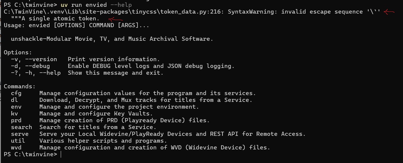

    uv run envied --help (Not sure as it might be an error, please see image below)
    [Attachment 92288 - Click to enlarge]

    1. Yes. Just change directory to TwinVine
    2. It is not an error. If you read it, it says Syntax Warning. You will not see it again unless you resync. It can be ignored.

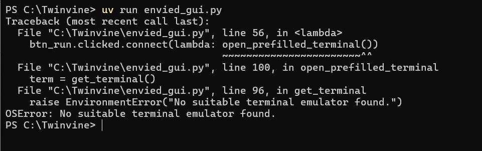

    uv run envied_gui.py first shows this: Image
    [Attachment 92308 - Click to enlarge]
    but if I choose "run envied" i get the following Image
    [Attachment 92309 - Click to enlarge]
    followed by an enormous error.
    post error.txt

    You posts are very frustrating to follow!! OK disregard 99% - which 1% should I regard??
    Did you stop reading the instructions for TwinVine? It is completely different from anything else you have ever run! You do not call python programs directly because you are using uv as a package manager; you need to ask uv to start the software. There are ONLY TWO WAYS TO USE TWINVINE.
    1. From with the TwinVine folder ' uv run vinefeeder'
    2. From with the TwinVine folder 'uv run envied' etc
    Can we learn from this? You made two gross errors. Both come down to not seeing information on the screen. May I humbly suggest you change your ways of working? If there are instruction to follow, either print them to paper and put a line through each instruction as you do it; or copy it to notepad, and delete each line after you have completed it. Either way it will be easy to see what to do next and you will not miss it. Treat it like a pilot's check list.

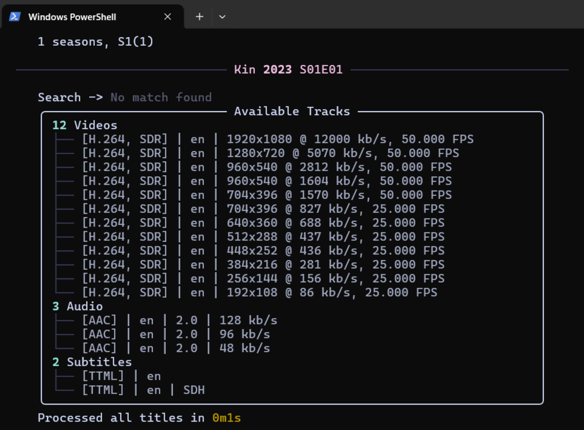

  12. TwinVine's BBC service gets 1080 for me.
    If you ask for --list it will show resolutions uv run envied dl --list iP https://www.bbc.co.uk/iplayer/episode/m001snkh/kin-series-1-episode-1
    [Attachment 92311 - Click to enlarge]
