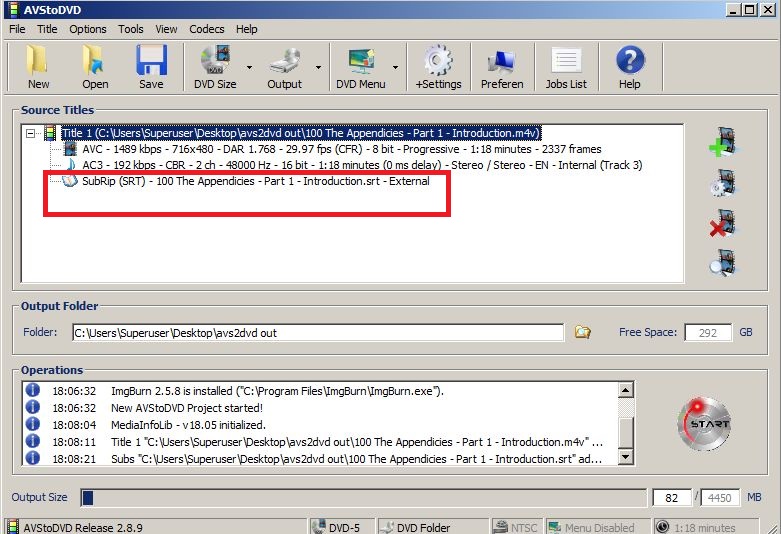

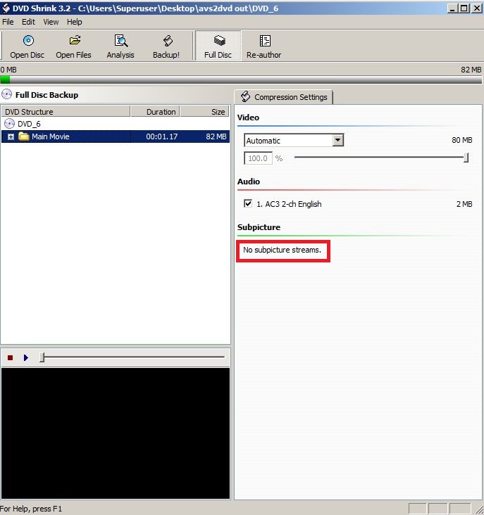

    When I use AVS2DVD to create a DVD structure using .srt subtitles, the subs aren't listed in the DVDShrink panel.
    It doesn't affect playback and if the Re-Author tool is used to cut the video, the subs are still displayed correctly.
    As I said, I never noticed before - probably because I never added srt files to AVS2DVD.

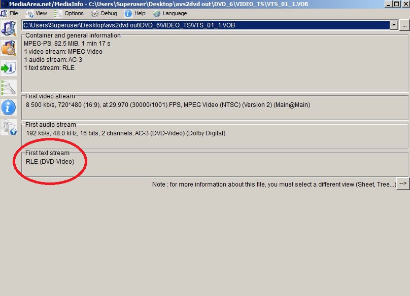

    Is there a story behind rle that I have just missed?
    [Attachment 92214 - Click to enlarge]
    [Attachment 92215 - Click to enlarge]
    [Attachment 92216 - Click to enlarge]

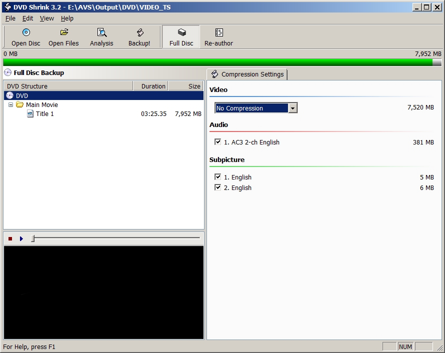

    It works OK for me with a test disk I just created in A2D

  4. @sambat, Your image #3 shows DVD Shrink 3.2 .
    Maybe the problem is your .vob is 1 minute 17 seconds.

    My results are like davexnet's.

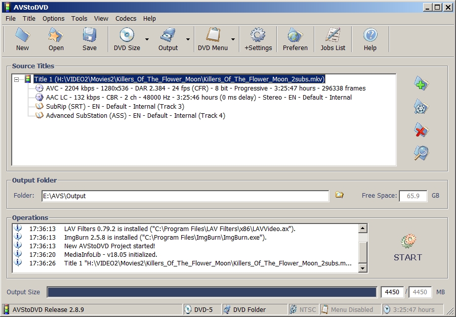

    I have 2 subtitle types for this test:
    1 .srt or subrip
    2 .ass
    [Attachment 92223 - Click to enlarge]
    This is how AVStoDVD displays the video & the subtitles it has:
    [Attachment 92224 - Click to enlarge]

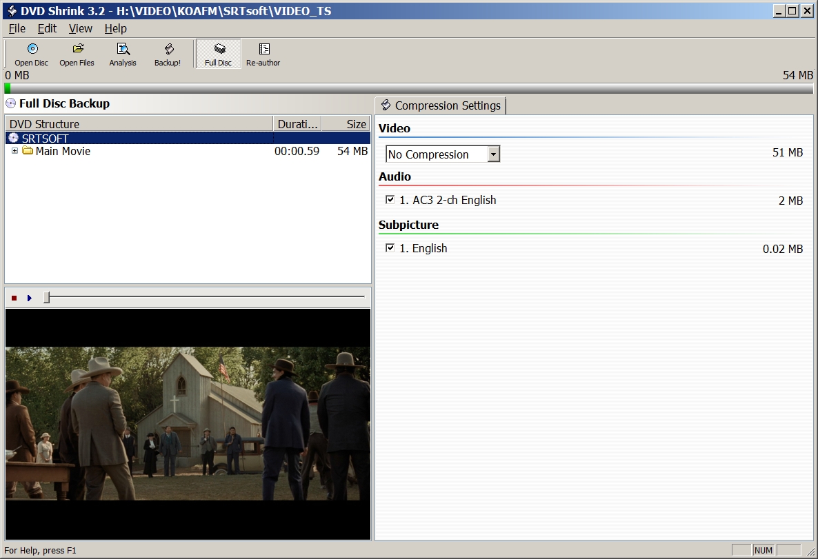

  6. I did some testing with a 59 second clip.
    I added a .srt file to the clip in AVStoDVD.
    The short DVD created by AVStoDVD has the subtitles & looks the same as sambat's MediaInfo.
    DVDShrink shows these subtitles.
    So duration should not be the problem.
