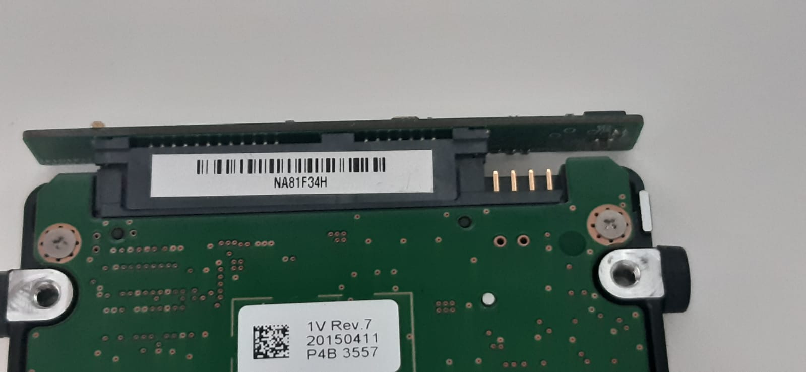

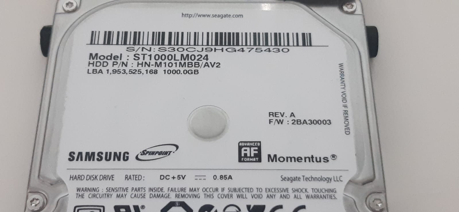

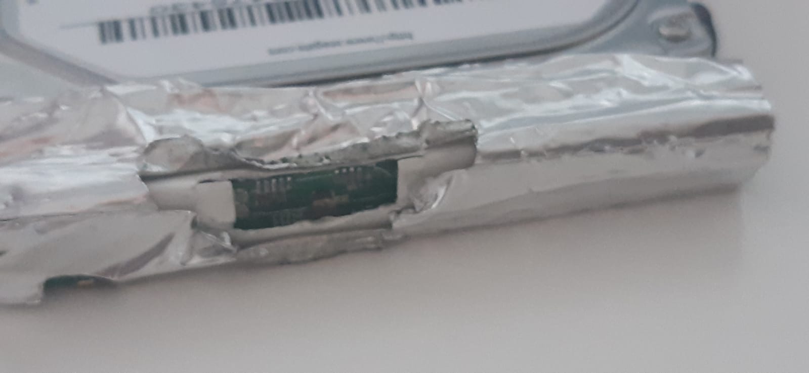

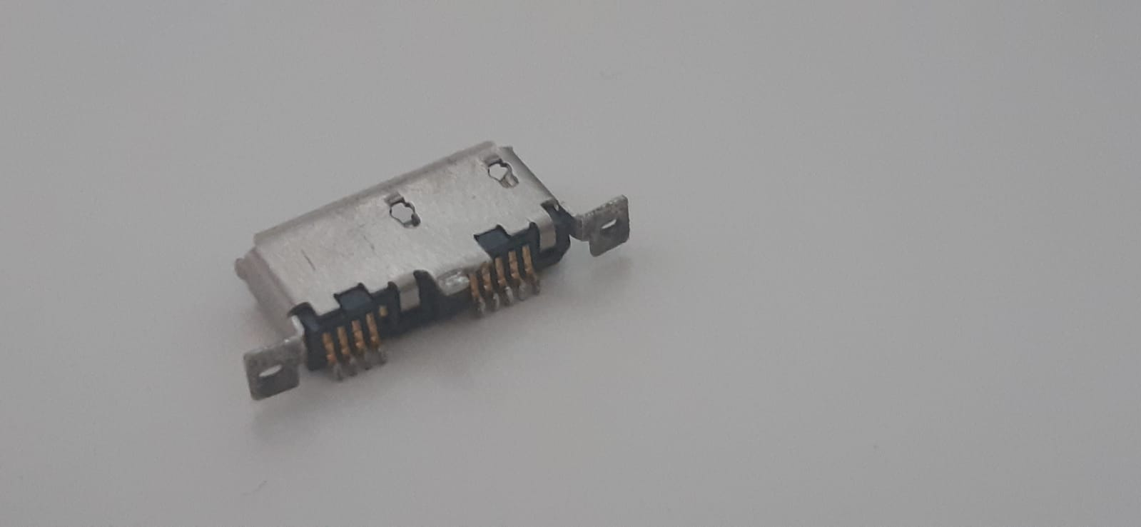

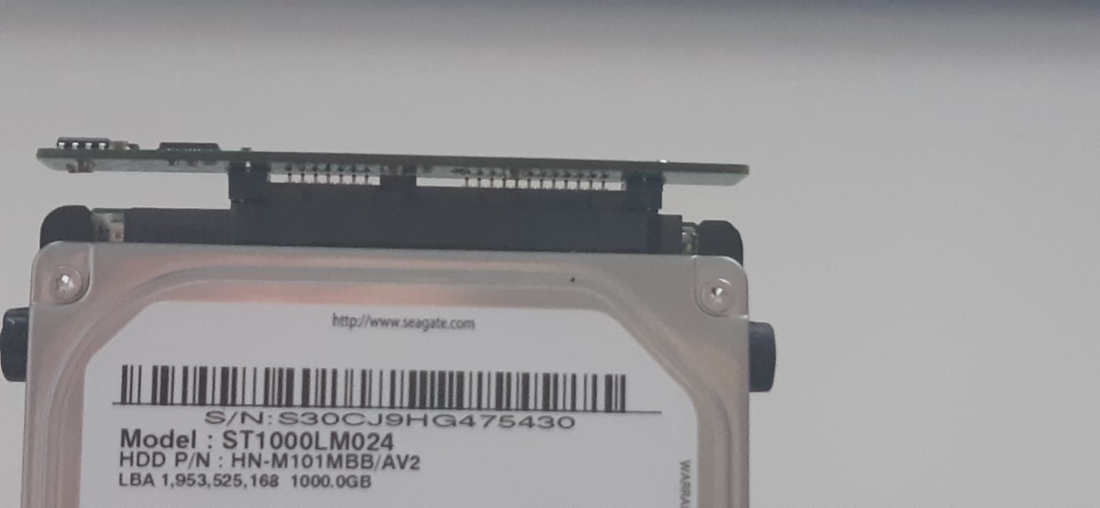

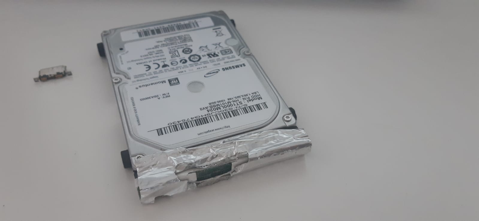

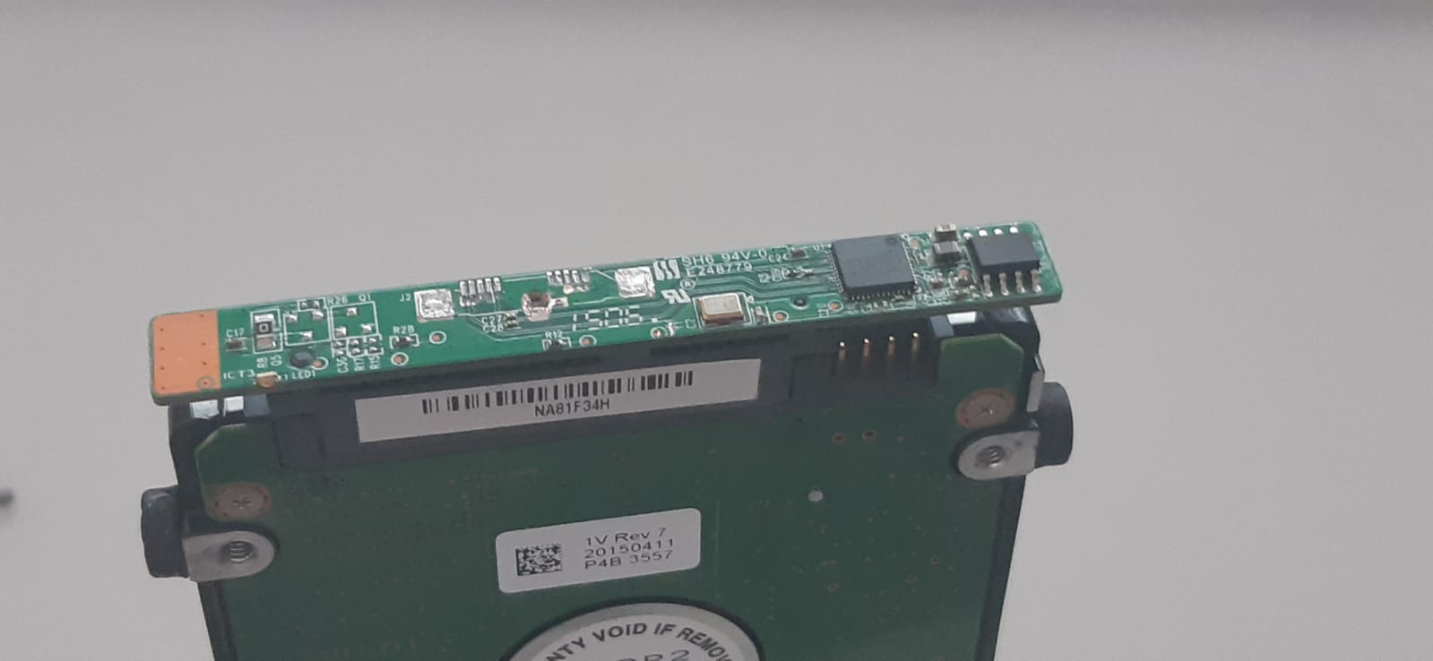

    Can you post a couple of pics, side-on, end-on, and from the top? They might someone a clue about how to get the USB bit off.

    Here are some pics
    [Attachment 92205 - Click to enlarge]
    [Attachment 92206 - Click to enlarge]
    [Attachment 92207 - Click to enlarge]
    [Attachment 92208 - Click to enlarge]
    [Attachment 92209 - Click to enlarge]
    [Attachment 92211 - Click to enlarge]
    [Attachment 92212 - Click to enlarge]

    If you haven't solved this yet, let me confirm/support Alwyn's and The_Doman's suggestions from above. I have a failed 2 TB Seagate drive with an identical designed SATA to USB adapter.
    The USB adapter WILL just pull off from the standard SATA connector on the drive allowing you to use any standard SATA power and data connection method to access the drive itself. You need only to pry gently with a small flat blade screw driver (or equivalent) at the gaps indicated by the arrows I've added to your picture. Whether the drive or data on it has been damaged is another issue, but the USB adapter WILL just pull off.

  9. Originally Posted by BW37 View Post
    BW
    I managed to detach the USB adapter from the drive. I don't know why the video I watched which showed an identical HDD to the one I have stated that the adapter couldn't be removed and the only way to fix the problem was to solder the USB adapter back on. Maybe it wasn't the same model.
    I have used an external HDD enclosure before for my old Toshiba Satellite internal HDD after the laptop was damaged and managed to swap it over to the 2.5" enclosure that I bought cheap, though both my laptop and desktop PC takes quite awhile to read the drive when connected. I took the Toshiba HDD out to test the Seagate HDD, and despite having to remove the screws on the sides to get it to fit into the enclosure, it connected and I was able to view the files on it. I bought an identical enclosure from a local mobile/PC repair shop today as I couldn't be bothered waiting for one to be delivered online. Think I've been ripped off there considering there are loads online for a few quid.
    Do I need to keep the silver/metal sheet on that was on the circuit board side or does it not need it?. The HDD from my old Toshiba laptop hasn't got this on, and neither does my older, faulty Iomega external HDD have this.

    As for the aluminum sheet, I'd try to keep it if you can though it might not matter. I assume it is for some kind of EM shielding. Make sure you keep the paper insulating sheet intact between the electronics and the aluminum sheet or you might short something out. If you trim the metal and paper together flush with the end of the drive itself (nothing attached to the SATA connector) you should be fine.
    It is not needed.
    I have here (too) many spare 2,5" drives with USB adapter/cases, on none of those i have/use extra shielding.
    It only risks a possible shortcut if applied incorrectly.
