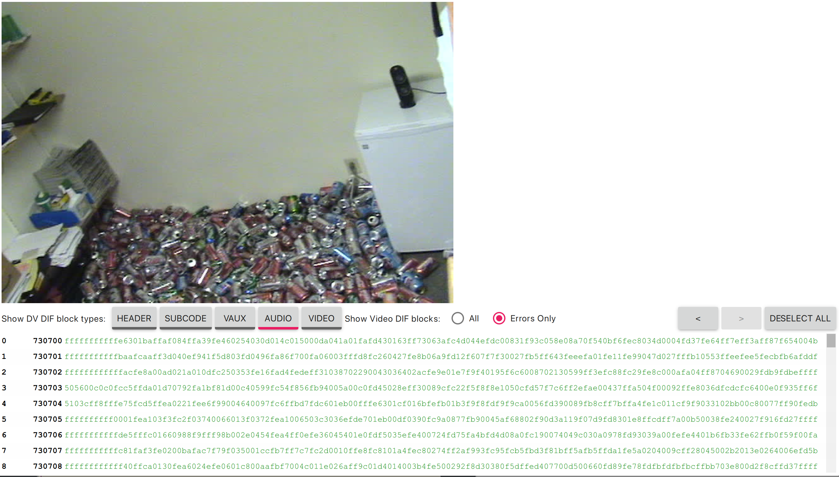

  9. I did play around with DV rescue a bit - it can tell you about both audio and video errors in a DV file and might have some ways to correct them. You'd be surprised how many errors a short DV clip can have. I had a random 34 second clip that I transferred 20 years ago from a DV tape and there were DVrescue says there are no video errors, but there are 89 lines (blocks?) of audio errors, all seemingly sequentially, see attached screenshot. Also of note, these 89 lines must not represent much, because the "percentage" of lines with errors for the entire clip is reported to be 0.00%
    [Attachment 92070 - Click to enlarge]
    Also a little strange that frame 0 has a different set of timecode from the rest despite this being a single clip.
    I don't fully understand what I'm looking at with DVrescue, but it might reveal something to those who use it more often that could be helpful.
    Lastly, some other Googling shows if you happen to have audio sample rate incorrect between the playback and capturing device (32 vs 48khz), that'll usually cause audio drift. Problem is that not all modern capturing apps will let you specify the audio sampling rate. DVrescue I image will though.
