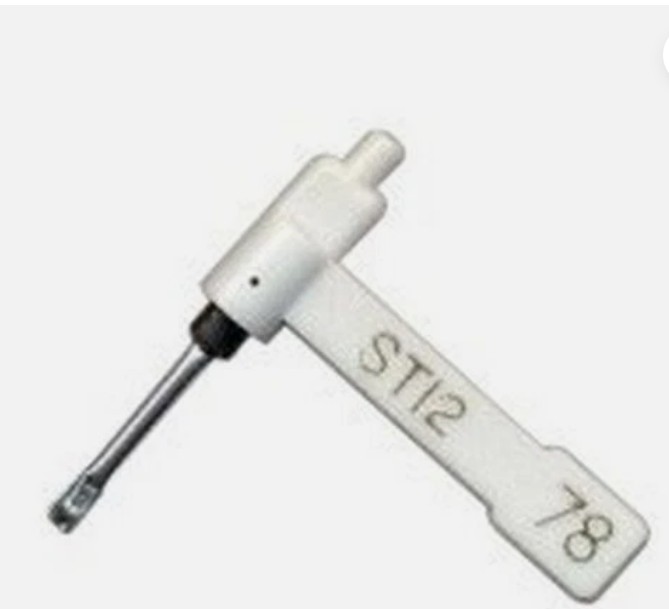

    Picture of a very common dual stylus on record players back in the 50's 60's 70's when many people still had old 78 discs in their collections. Flipping from 78 to LP and vv was very quick and easy. This sort of knowledge is not as common as it used to be.

  16. Originally Posted by timtape View Post
    I had several record players back then that had this type of stylus.Back then I just called them needles.

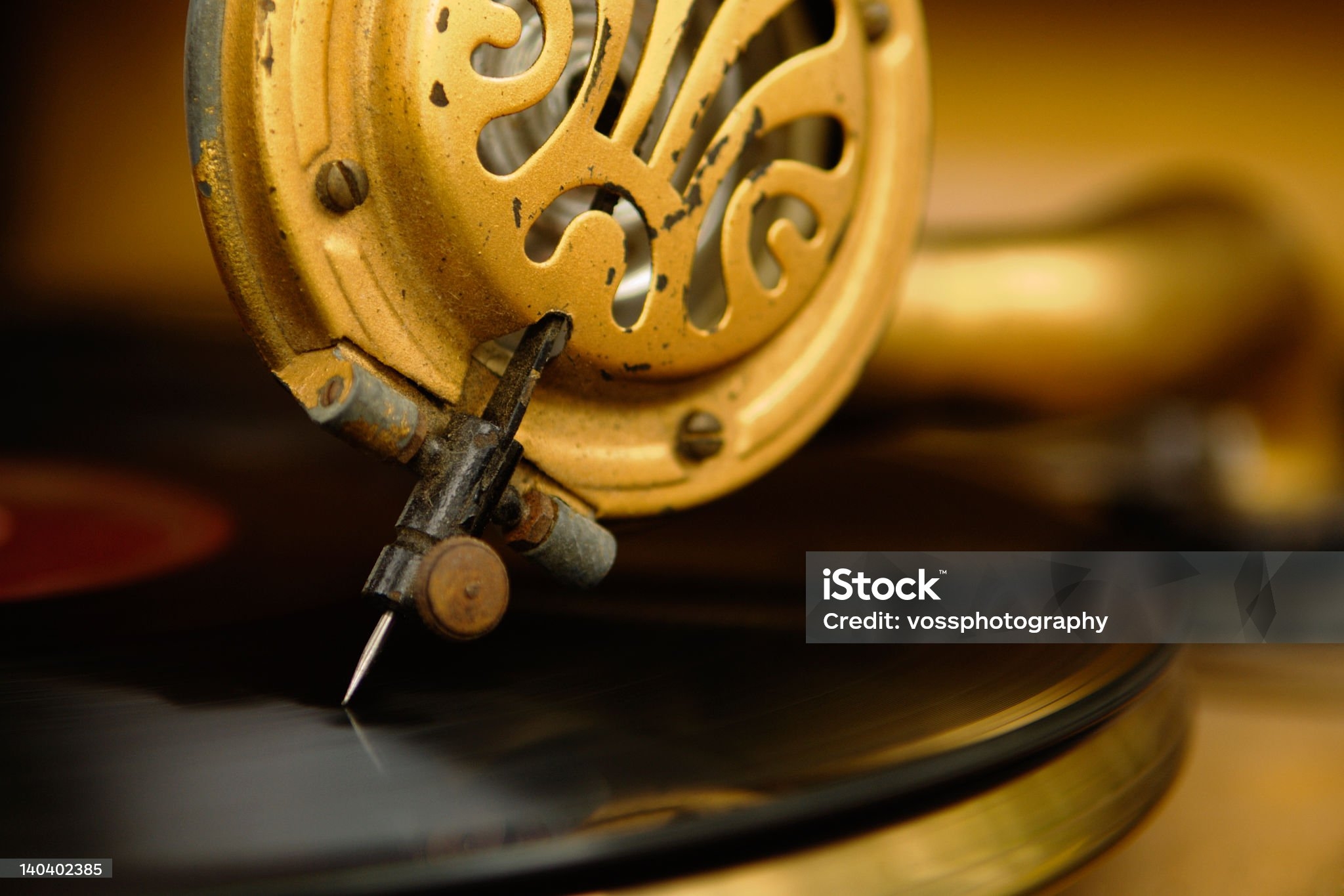

    I never had a Victrola that was a cousin of mine that had it.
    A Victrola was what the old 78s were meant to be played on. At least originally.They looked like this:
    [Attachment 92042 - Click to enlarge]
