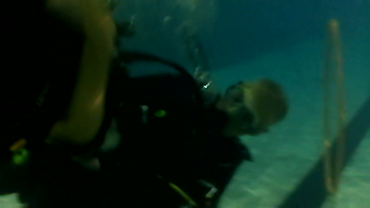

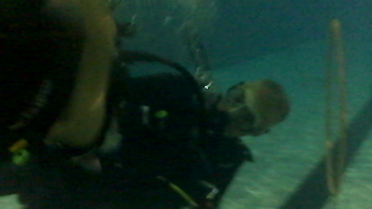

  2. Hopefully someone experienced in restoration will chime in, but why did you resize to 360p then back to 720p? That alone results in a significant loss of detail and sharpness. Or perhaps it's intentional, to smooth out the blockiness?
    The outcome is definitely smoother but darker and blurrier.
    [Attachment 91869 - Click to enlarge]
    [Attachment 91870 - Click to enlarge]
    Somewhat decent regards (that's all I have left – was expecting a shipment of premium fair trade organic best regards earlier this month but it got stalled because of the Strait of Hormuz crisis ).
