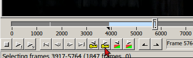

  3. VirtualDub2 can edit. It apparently has the ability to encode around the cut points but I've never used it for that so I don't know how well it works. To edit and save without re-encoding (if you're only cutting on keyframes) you need to have the appropriate VFW codec installed, otherwise VirtualDub2 will open and decode the video with ffmpeg so you'll have raw uncompressed video instead. You should be able to use the keyframe buttons on the navigation bar to find the start and end points you want to edit out, marking them as you go, then use the Edite/Delete menu to remove those sections. Once you've removed the sections you don't want, select "Direct Stream Copy" under the Video menu and save it as a new file (File/Save Video).
    At least that's the theory. I haven't used it for editing in a fair while myself.

    I use VirtualDub2 to find the frame numbers for the edit points using the keyframe buttons on the navigation bar (as without re-encoding around the cut points you can only split on keyframes). Then it's just a matter of entering the frame numbers under the Output tab after selecting Split mode: "By parts based on frame/field numbers". You can enter as many sections to keep as you wish this way:
    0-4578,6499-67342,73456-74878
    Once MKVToolNix has split out those sections you can then use it to append them as a single file.
    Of course while MKVToolNix can open many container types, it helps if you want the output to be in an MKV container.
