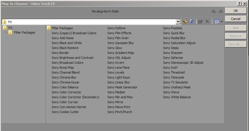

  6. Video effects..
    I have Sony Vegas Pro 11, a pretty old version for sure..
    Here is the default plug in video effects which you can add in to the effects chain.
    [Attachment 91861 - Click to enlarge]
    While it doesn't have VTR effects, it does have tools which can achieve degradation to the point of VHS or lower quality. Not in that menu is additional tools which can simulate jitter and flutter..
    Newer versions of Vegas will have more effects options.. At one time older versions one could download additional effects filters. Not sure if that is available any more..
    But there is a lot info on how to DIY VTR video simulation without having a direct VTR effects plugin..
    See the link..
    https://www.dogpile.com/serp?q=video+tape+effects+filter+for+vegas+pro&sc=OeDX693GDCPV10

    As far as Vegas filters, You may have to try a combination of filters to soften/mundge the video. But in one of the posts I made, there is a link to a search which has a lot of tutorials on how to achieve the vintage analog video look in Vegas without a direct VHS filter.. The greatest and easiest way though is to render out the edited video as SD quality, basically DVD resolution or less.. Vegas offers a lot of preset resolutions for rendering, those resolutions presets are for the highest quality.. To get lower resolution you will have to create a CUSTOM preset, at a lower resolution and even can lower the bit rate.
    Thanks! Ah yes i see your link sorry, that's gonna come handy. I've tried yesterday to use Vegas (good thing i know premiere and after effect already) and it's quite good tbh! I wish it was freeware, it would beat anything else if it was. I found how to apply some vhs effects and play with resolutions and bitrate.
