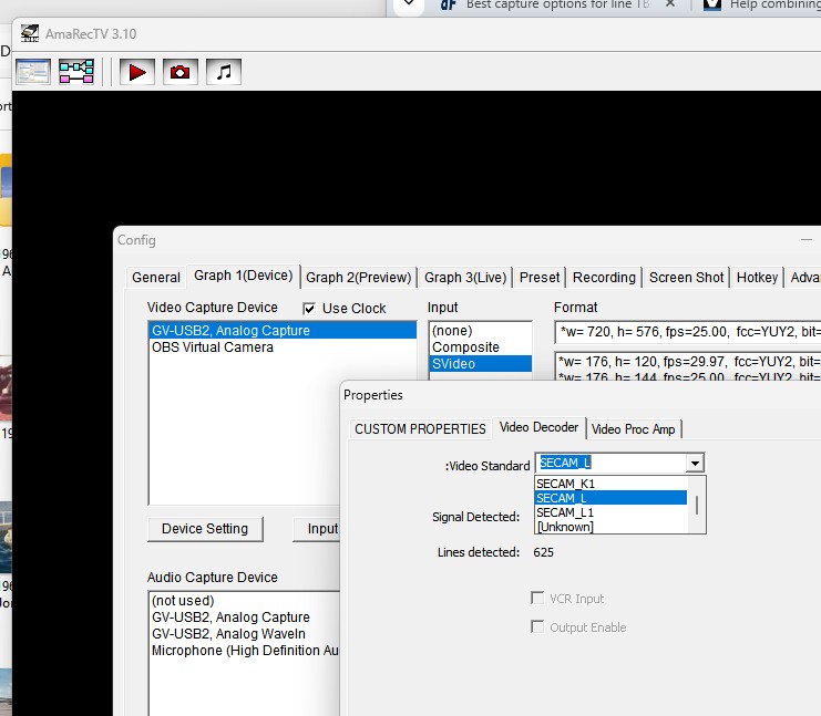

    May 2005
    Australia-PAL Land
    The GV-USB2 can input SECAM L, according to the driver. I have no access to SECAM tapes so I can't verify, one way or the other.
    [Attachment 92071 - Click to enlarge]
