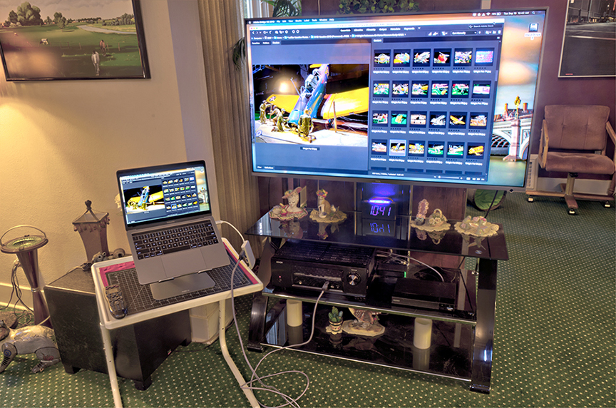

    I use my MacBook Pro to present and display photos and music for presentations on our home TV (TCL) and (Denon) Reciever.
    Here is the set-up...
    TCL Monitor (HDMI 1) to Denon Reciever....... Plug in MacBook Pro to Denon Reciever into the GAME (4) HDMI.

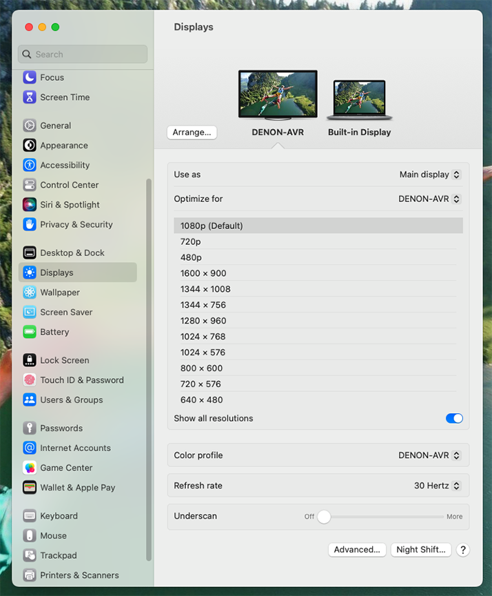

    what resolution do you have your macbook pro set at ?? - Using HDMI Input "Game" on Your Denon Receiver
    You can connect your MacBook Pro to your Denon receiver using the HDMI Input labeled "Game" (port 4). This works fine for both audio and video output, as long as your MacBook Pro is set to the correct resolution.
    For M1/M2/M3/M4 MacBook Pros: Use a USB-C to HDMI adapter (e.g., Anker, Belkin) or a high-speed HDMI cable if your model supports direct HDMI output.
    Set the resolution to 1080p or 720p on your Mac if you get a "Mode Not Supported" error. Go to System Settings > Displays > Scaled and select 1920x1080 (1080p) or 1280x720 (720p).

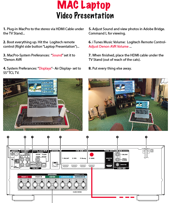

    When we have a group of people over this is a great way to present our photos and play music via iTunes on our MacBook Pro through our home speakers.

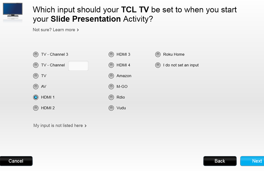

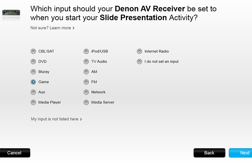

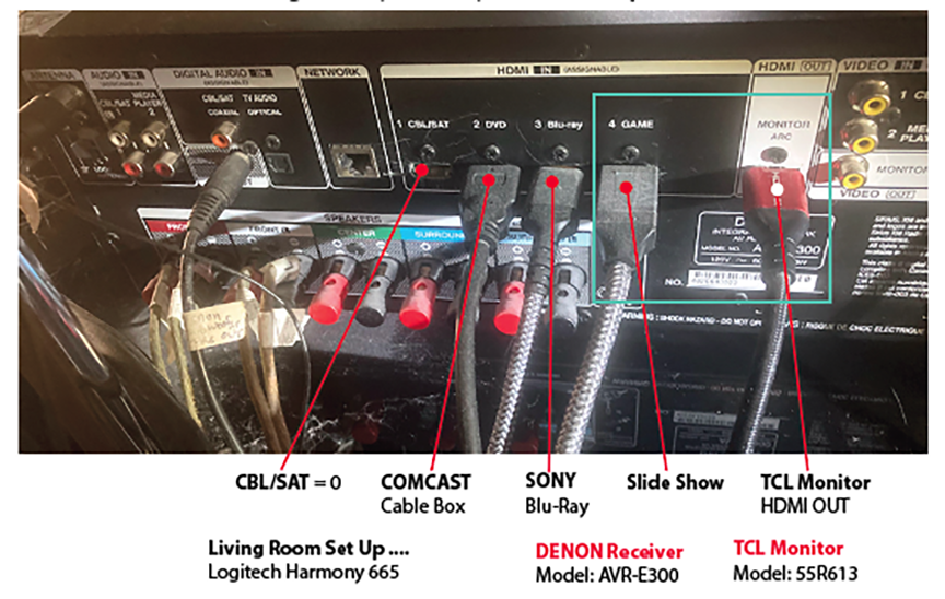

    1. The MacBook Pro is plugged into our Denon Receiver via an HDMI cable to the "Game" HDMI 4 on the back of the Denon. The TCL 55" TV is plugged into the Denon via... HDMI 1 on the TV and into the TCL Monitor HDMI OUT. (Image 1 above) This set up worked great for years.

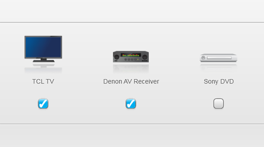

    2. I control the TV and the Denon Receiver with a Logitech 665 programmable remote. (Images 3, 4, 5 above) Showing the settings in MyHarmony app.
    3. MacBook Pro Laptop: I play the iTunes for the music. In the MAC System Preferences: I go to "Sound"... Then select Denon Receiver.... and start iTunes The music is coming through fine via our Home Entertainment Speakers now.

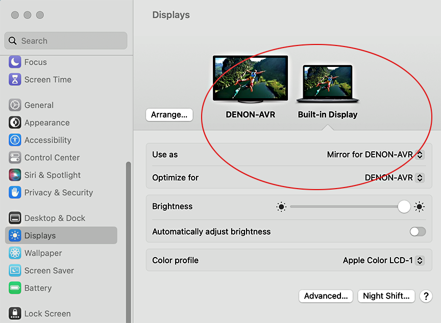

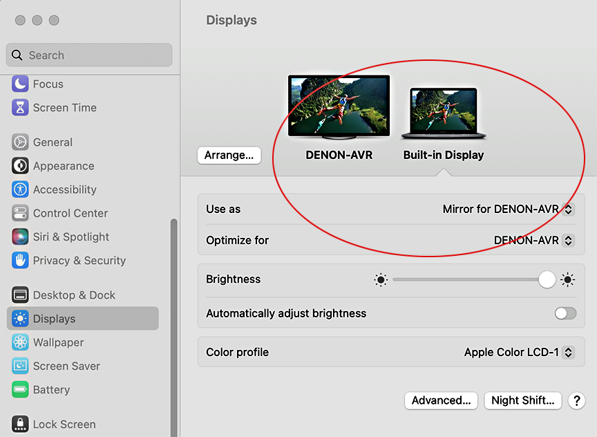

    4. (Screen Shot 7) Now, notice the Laptop "Built-In Display".....Then, notice the Denon-AVR this is the route from the Denon (HDMI GAME 4) to the HDMI 1 TCL TV. This is where I went to on the older OS to do this. So it is recognizing the larger home TV but no Video signal is coming through.
    So, I am getting Audio Output through my home speakers via iTunes from the Laptop BUT, NO VIEDO signal to the TV. Display settings: It is not recognizing the TCL TV as (55"TCL TV) as before.

    I guess my question now is..... MacBook Pro Lap Top - Ventura...... Where do I look to change the screen resolution? I would assume System Preferences. I did not see anything like that in the "Display" settings. Screen shot #7 Below
    Please advise....
    Reesche
