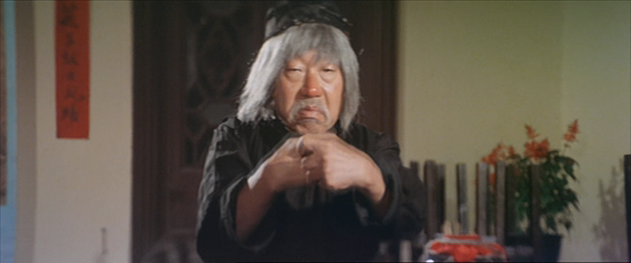

  8. My speculation about the aspect ratio:
    Assuming the original was released as 16:9 PAL SVCD its PAR (PixelAspectRatio) would be 59/27. Converting the cropped 704x576 .vob to square pixels would make it 704x264 => DAR=2.67.
    Frames around #1450 show a football in the top right corner which looks pretty circular with this assumption (Cinerama and Cinemascope movies were up to 2.66:1 btw.).
    [Attachment 91508 - Click to enlarge]

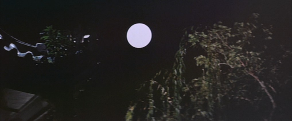

    @Sharc, So i have changed to 704x264 as suggested. Below is a frame from same DVD of the moon in the sky with 704x264. Would you say it looks okay?
    [Attachment 91509 - Click to enlarge]
  10. ^^^^ The moon looks horizontally stretched. What would the DAR become if you resize it to circular shape?
    Do you watch the 704x264 in square pixels (using Vdub for example), or does the player stretch it anamorphic acc. DVD PAR 16/15?

    Assuming that moon is round, it's 2.39:1.
    2.2:1
    [Attachment 91512 - Click to enlarge]
    2.39:1
    [Attachment 91513 - Click to enlarge]
    2.55:1
    [Attachment 91514 - Click to enlarge]
    2.66:1
    [Attachment 91515 - Click to enlarge]

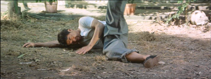

    I've done a export using my script and there seems to be some frame blending issue ( interlace maybe) not sure what it is.
    Here is a screenshot:
    [Attachment 91518 - Click to enlarge]
    Here is short sample of script export file too:
    https://www.swisstransfer.com/d/c2093a4f-fc2c-4ace-abf2-252c98d48f0f
    Can this be fixed ?
