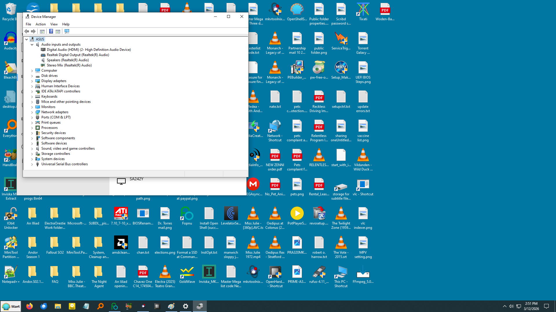

  1. The screen shot shows what is in my audio profile in Windows 10.
    The peculiar problem on this PC, ASUS A320 MK with onboard audio is that just one stream out of all content when selected will not play.
    It's just a city council meeting supplied by the media service which processes their meetings. I can go into the other room where I have an older MSI 760gm and the audio will play. It seems very local to just this ASUS A320. Are there realtek updates available that will _simplify_ all the hi rez settings which the screenshot shows ?

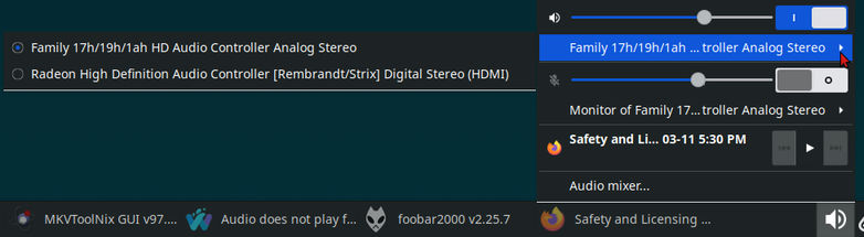

    If other types of audio play okay in a media player on that PC, then maybe it's a issue with your browser, although I can't imagine what it'd be. There doesn't seem to anything out of the ordinary in your Device Manager screenshot so I doubt it's an issue with drivers. I'm on Linux so it's no doubt a bit different to a Windows configuration, but if you can see what's happening from the volume icon in the system tray in a similar manner (I can't remember as I've not use recent versions of Windows much), have a look to see if the audio is playing and where it's going. And check to make sure the audio isn't muted or turned all the way down in the video player window. That's caught me out a few times because a player will often remember it's previous volume setting, at least when playing video from the same website.
    [Attachment 91498 - Click to enlarge]

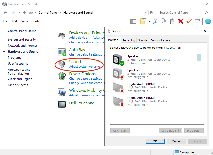

    Netherlands
    Best to use the old/classic sound configuration tool from the control-panel to check/configure what sound output is enabled.
    Google: Windows old classic sound options
    [Attachment 91500 - Click to enlarge]

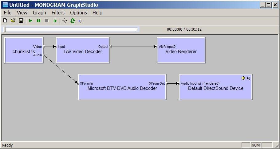

    I downloaded the Chunklist.ts file and it played the audio just fine. I opened it in GraphStudioNext and it shows in my Window 10 that it is using the Microsoft DTV-DVD Audio Decoder to handle the audio. Could it be a corrupt decoder problem on that one PC rather than a audio driver problem?
    Have you tried running SFC /scannow at the command prompt (run as Administrator)? If not, give it a try. If it is a corrupt file in Windows, then SFC /scannow should repair it. Be sure to reboot the PC after if SFC says it found any issues, and then try playing the file. If it doesn't show any problems, then that is one more thing that you can scratch off the potential cause list.

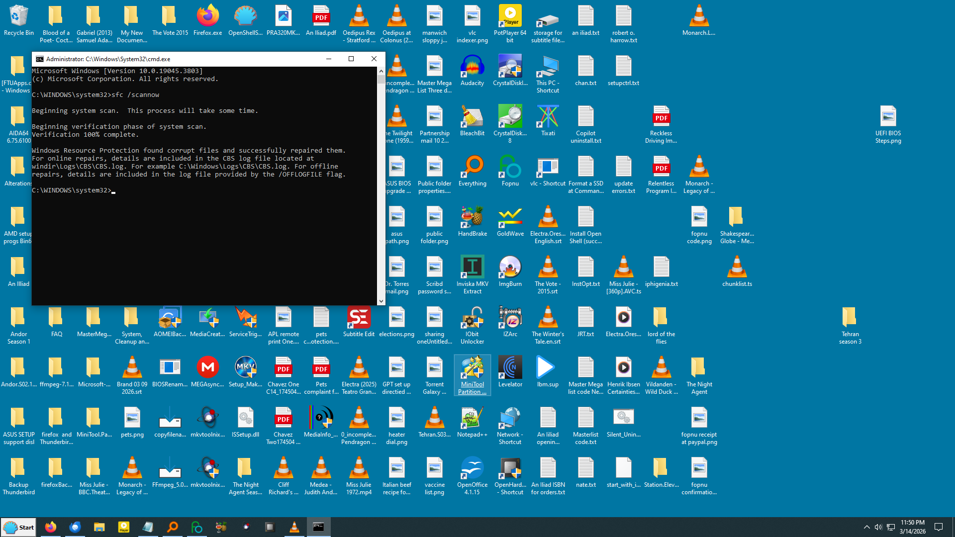

  15. SFC found errors as in the screen shot, but no change.
    I'm letting this go. Please end it.

  16. @ davexnet, How did you get the chunklist.ts ?
    I tried the chunklist.ts in Graph Studio.
    No problem playing the audio.
    This is what it shows: Close to what Gramps posted.
    [Attachment 91522 - Click to enlarge]

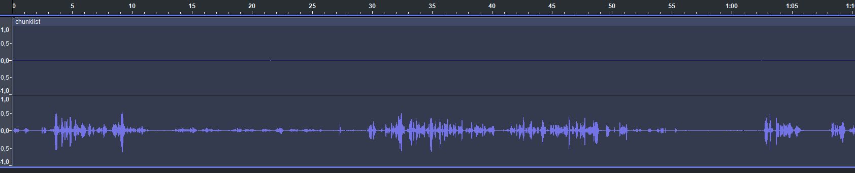

  17. MPC-BE with internal Filters plays the ts file with Audio, but despite it is 2.0 I only hear Audio from the right speaker.
  18. Originally Posted by flashandpan007 View Post
    Of course, the left channel is empty.
    [Attachment 91523 - Click to enlarge]
    To the OP:
    Maybe you accidentally turned off the right channel.

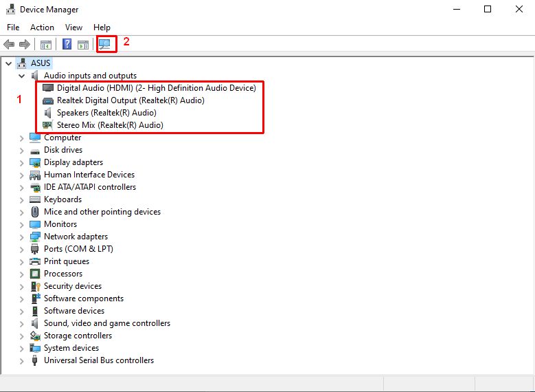

    The easiest way to reset your audio settings is as follows:
    Right-click each entry in 1) and select Uninstall.
    Once all entries have been uninstalled, click the icon in 2).
    All necessary drivers will be reinstalled automatically.
    [Attachment 91524 - Click to enlarge]

  21. Originally Posted by ProWo View Post
    On this can I just use disable everything in audio device manager then try the reset on the number two item on the list?
    I did start the uninstall as you said and saw that they disappeared from the list. Restarting got the missing ones back and I don't want to through something I can't reverse.
