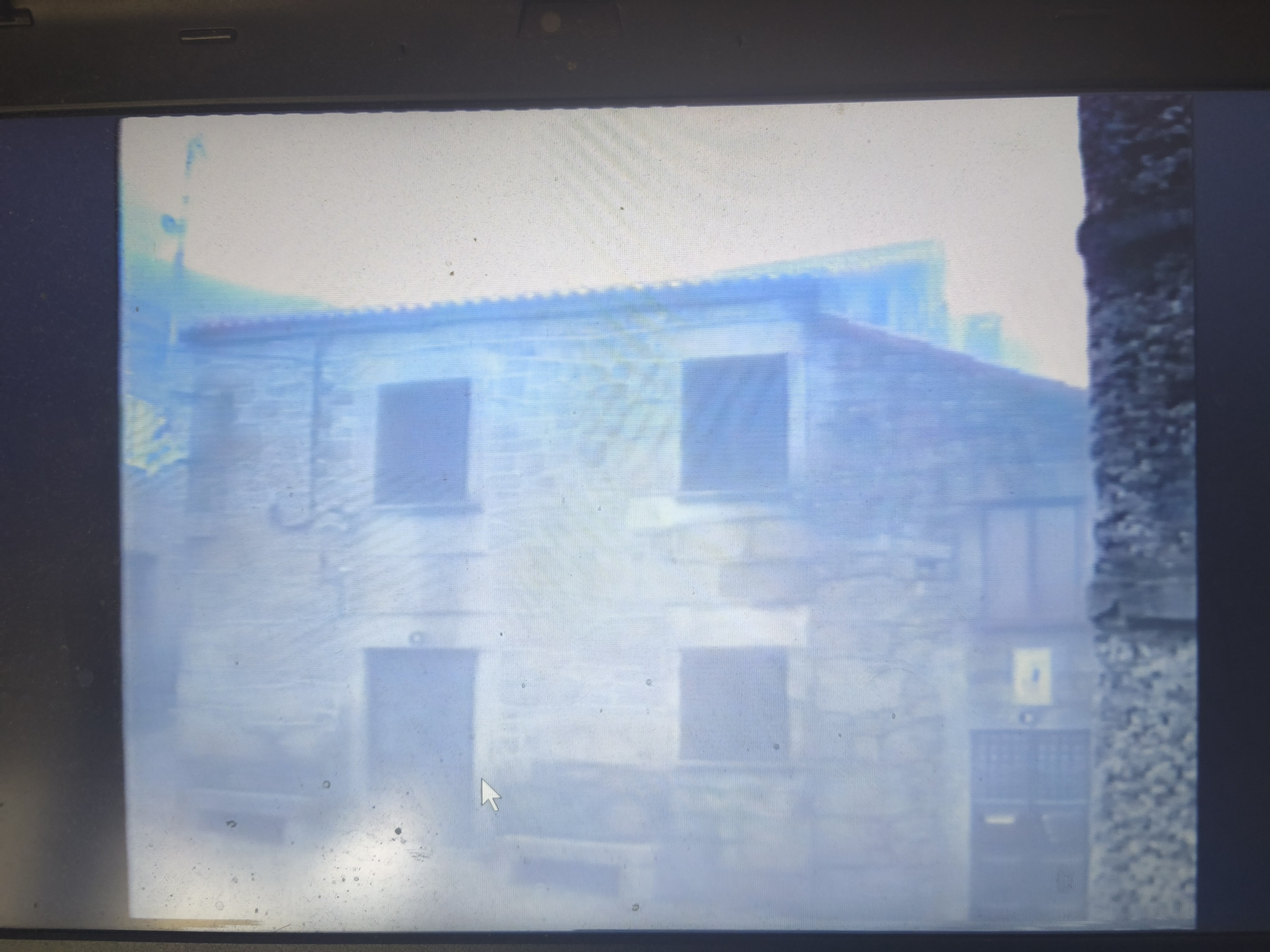

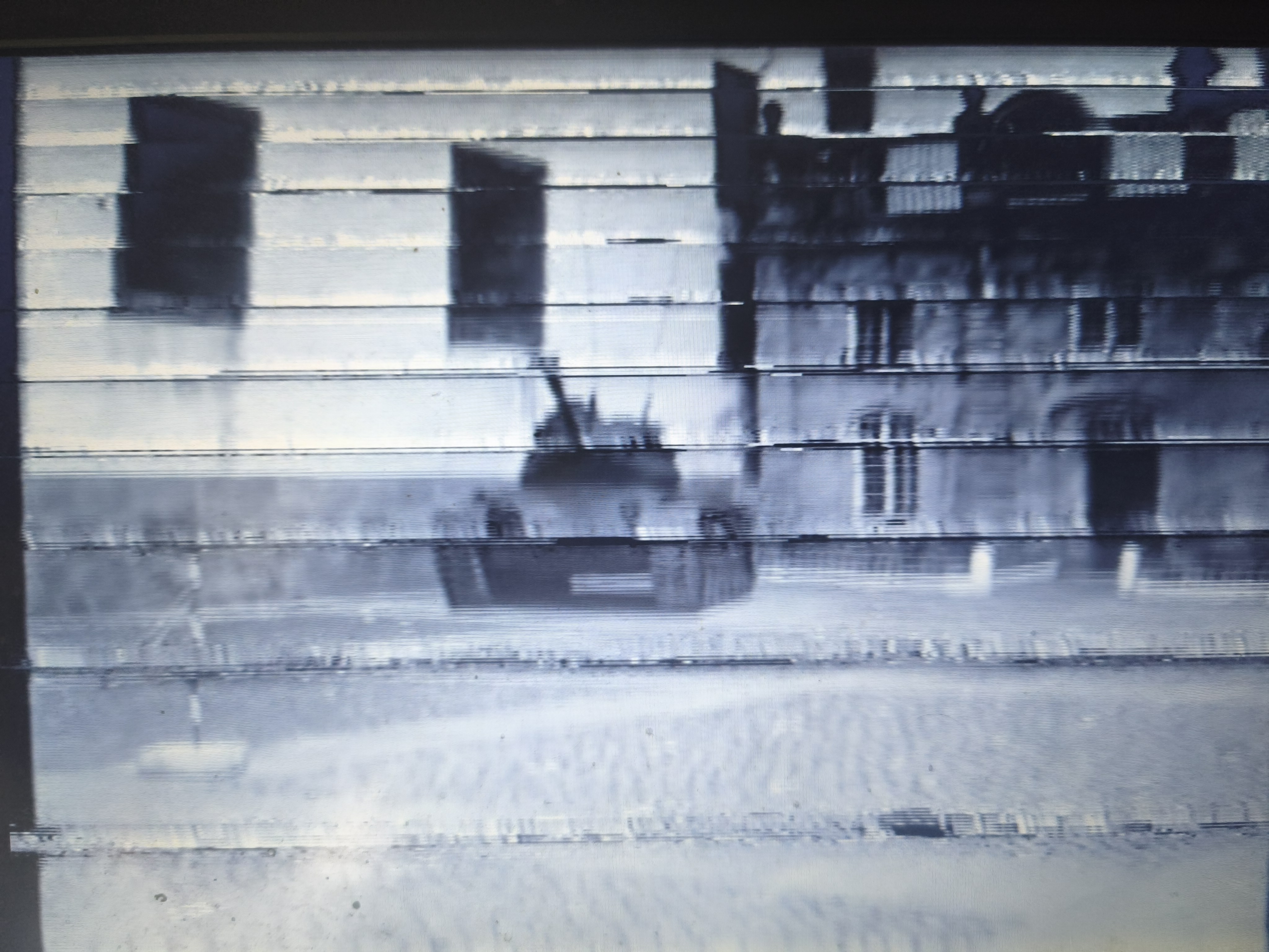

    2) "horizontal jailbars issue"
    JVC HR-S5800E (SVHS VCR)
    Plays well regular VHS SP and LP recordings without issues (LP not so well).
    Have horizontal jailbars playing both VHSC SP and LP recordings; it seems the tape is playing at a diferent speed.
    picture VHSC.SP.JVC
    [Attachment 91567 - Click to enlarge]
    picture VHSC.LP.JVC
    [Attachment 91568 - Click to enlarge]
    It even seems to me that this VCR dont have noise in the LP recordings that are appearing in the LG VCR (LP recordings issue).

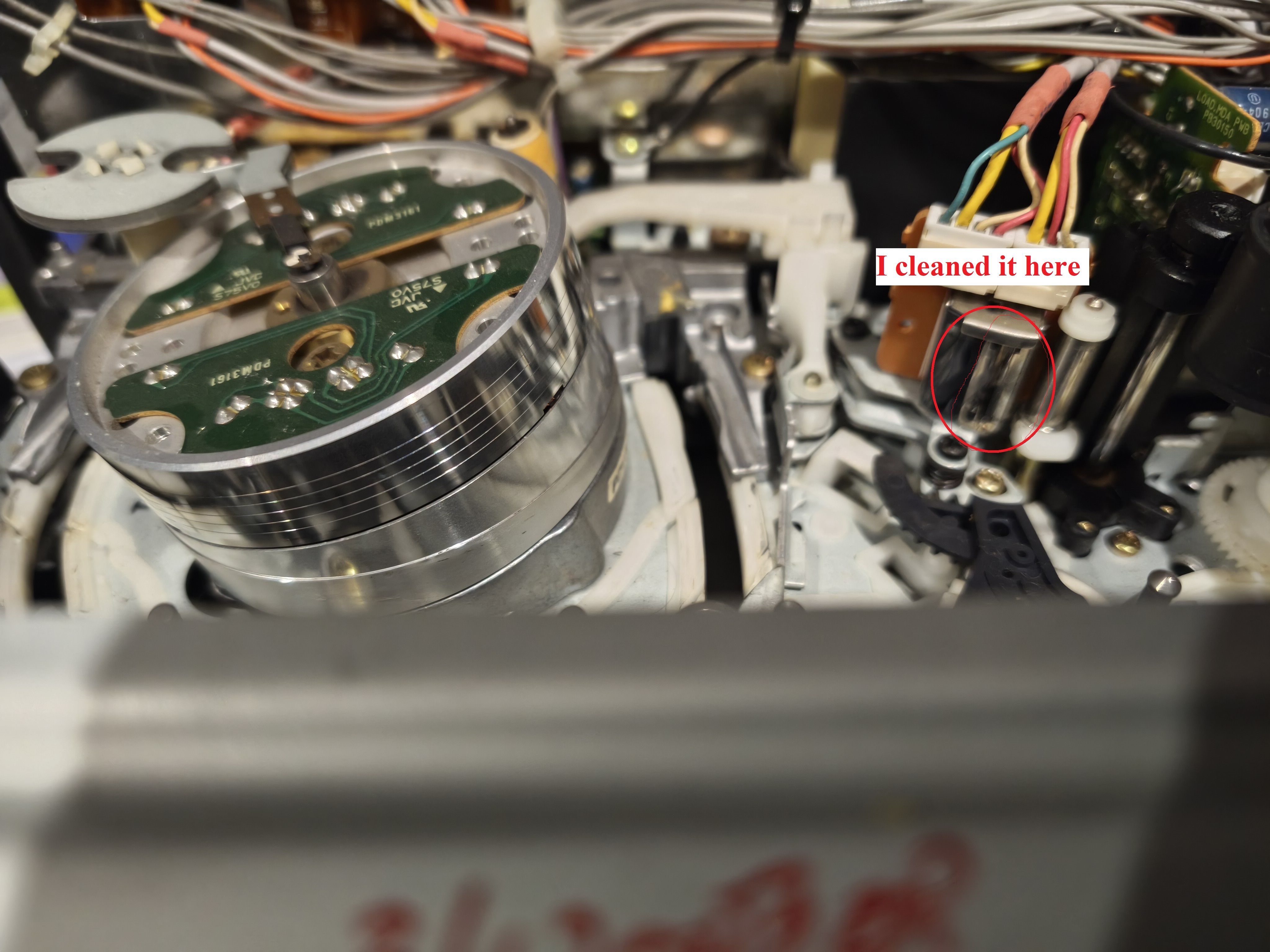

  5. Clean the audio/control head (at the right side of the drum) with a qtip + alcohol IPA. The control track read infos for speed detection (SP/LP) maybe it's just that as you say it was working before
  6. Hi again,
    I cleaned it in the spot indicated in the image and no luck.
    [Attachment 91586 - Click to enlarge]
    Meanwhile, i found a regular SVHS tape recorded in VHS LP mode, and sometimes it plays well, other times it gives an image like that of VHSC tapes !!!!
    Did I clean it incorrectly, or is there a problem with the control audio/head?
    Thank you.
    Mar 2008
    The control head is right at the bottom; you should be able to see it if you look close.

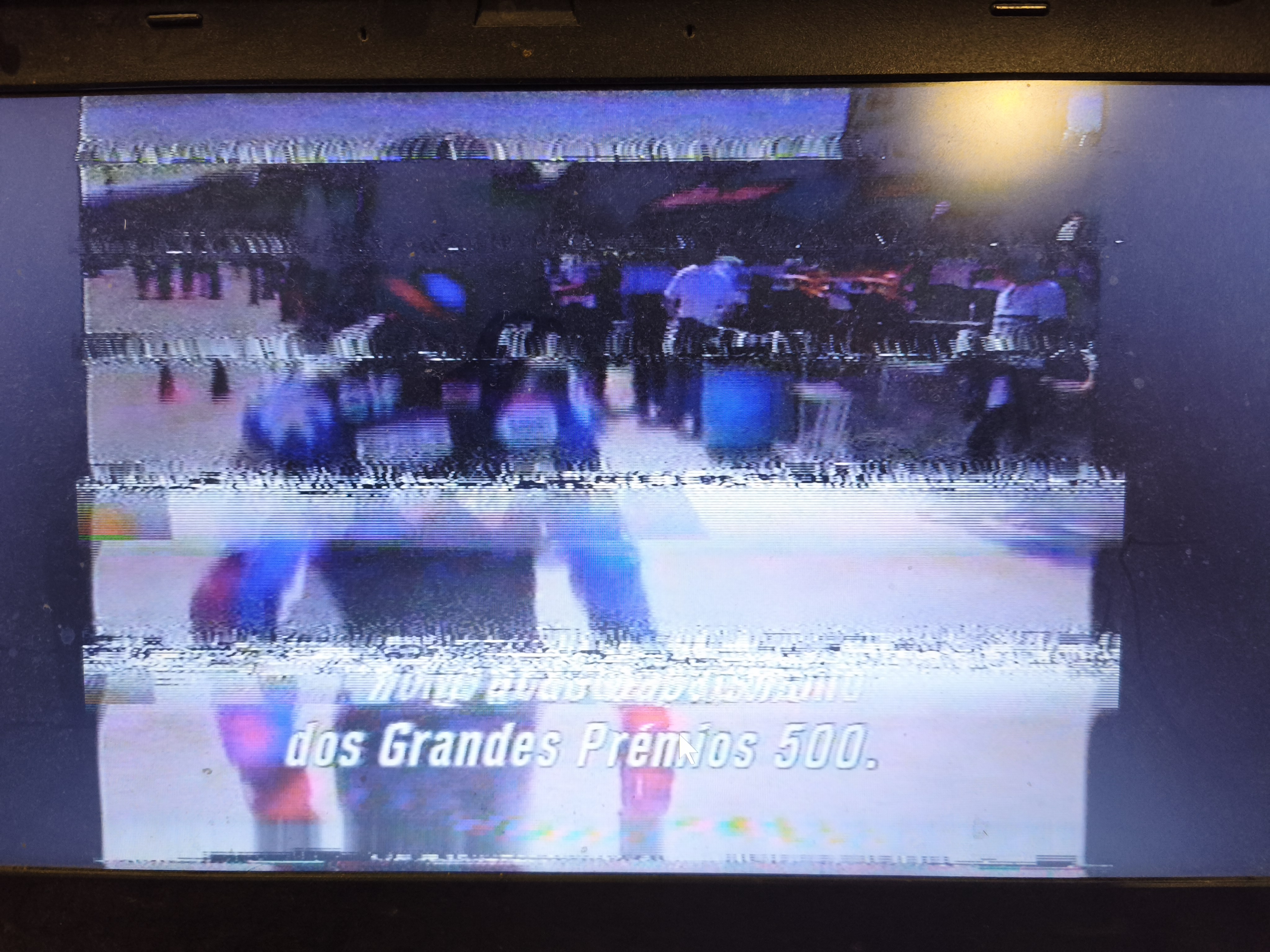

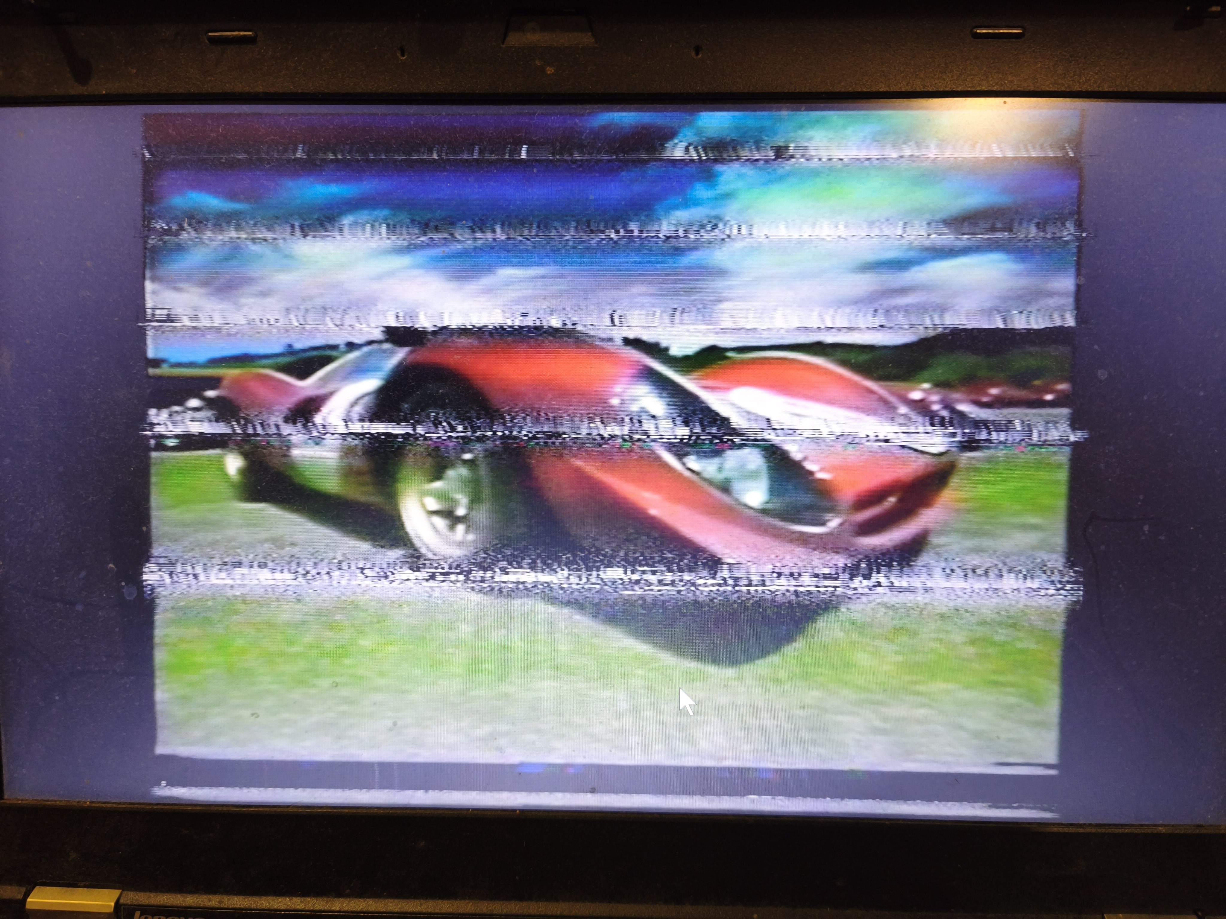

    [Attachment 91658 - Click to enlarge]
    [Attachment 91659 - Click to enlarge]
    They played ok on LG VCR.
    However, my regular VHS home recordings are playing ok on JVC VCR.
    So i think this is nothing to do with the tapes, this is a JVC VCR issue.
    I already used a head cleaner tape without success.
    [Attachment 91660 - Click to enlarge]
    What i can do now ?
    Thanks.

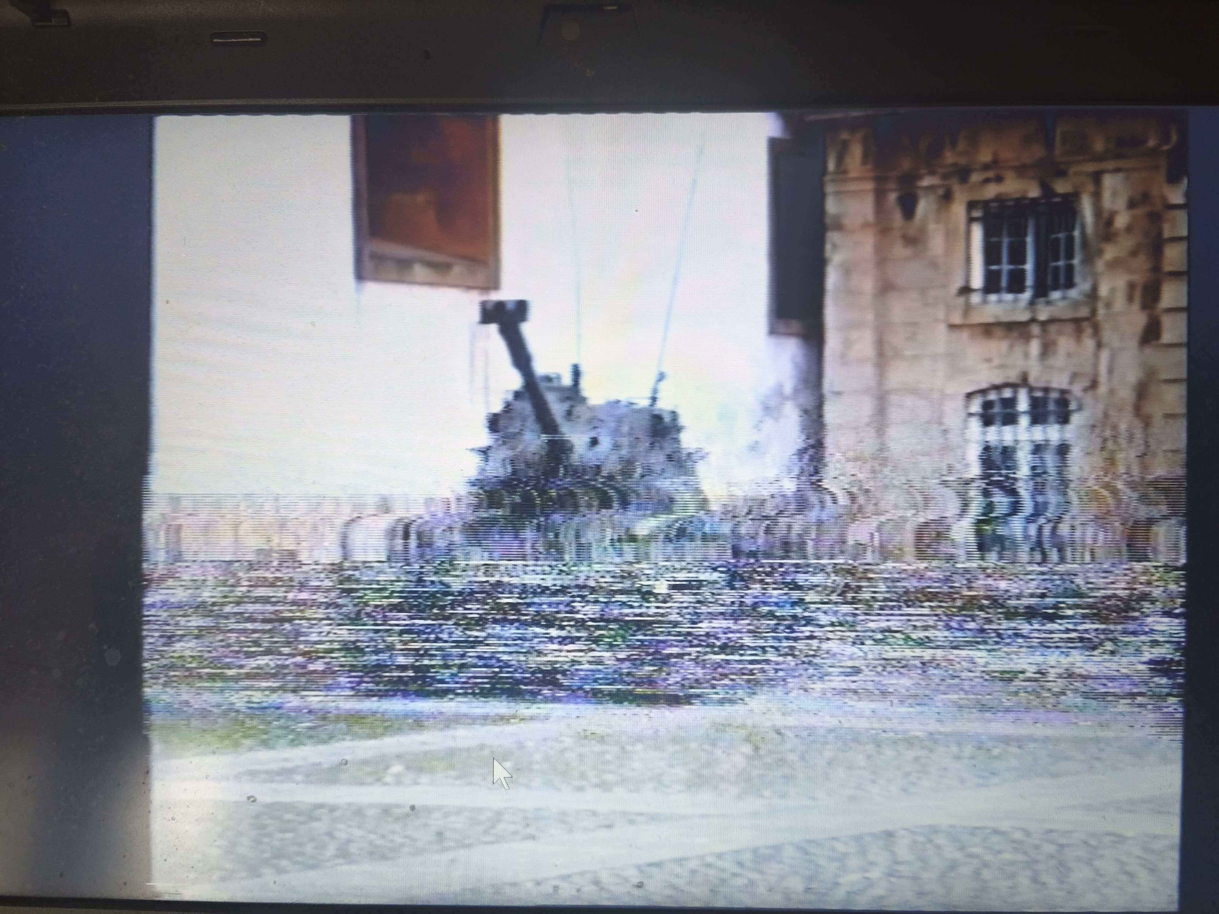

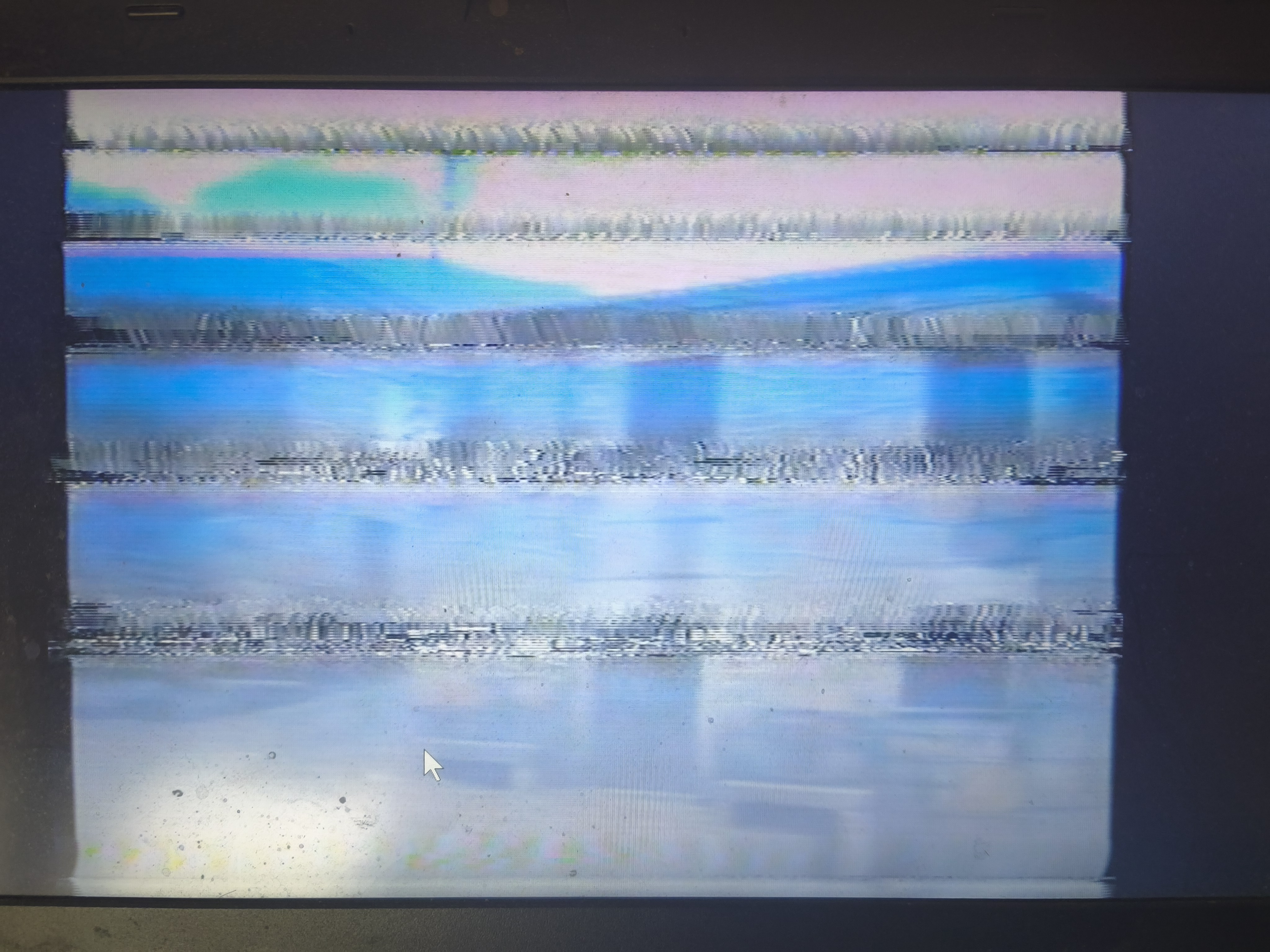

  15. Hi,
    I can't find the camera manual, but I'm almost certain that both the JVC camera and the JVC VCR only have SP and LP as recording modes (no buttons for SLP/EP).
    In any case, I think the problem now is with the JVC VCR, because even regular VHS tapes have noise bars that I can't remove with the tracking buttons.
    [Attachment 91679 - Click to enlarge]
    The same regular VHS tapes are playing well on LG VCR.
    It's possible I might also have problems with the VHS-C tapes, but first I need to solve the issue in JVC VCR meanwhile I found.
    Any help ?
    Jun 2024
    Perth, Western Australia
    Thanks for the upload. So to clarify, this is the JVC VCR playing regular SP tapes which play fine on the LG? The playback speed seems correct, but then it should be because SP is the easiest of all for a VCR to play. Yes the JVC video playback seems to be the problem. Not sure what caused it.
