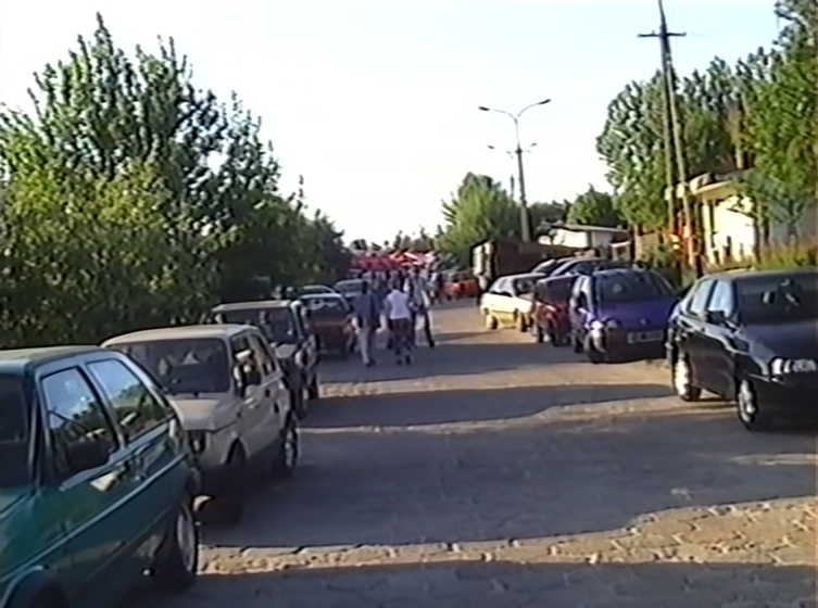

    I'm starting this thread because I want to post VCR screenshots and compare them.
    Maybe someone will find them useful, maybe someone will join in.
    All my screenshots are quick ones – from the HDMI output of a Panasonic DVD recorder, after deinterlacing.
    At first glance: Philips (or JVC) vs. Sony.
    https://imgsli.com/NDUyMzgz
    In addition, the sound from the JVC is more muffled than from the Sony (linear mono).
  2. I do like the idea of VCR comparison threads, but the downside is that everyone will be working with different source material, so it makes them harder to directly compare. Purists will say what you really need is short video clips rather than screenshots, but I think screenshots can still be useful at determining "big picture" differences.
    I always thought it'd be best to put out a sort of sample DVD that anyone could burn and use to make source tapes. Given that the source for that is digital, we know what certain scenes or patterns are "supposed" to look like. A VCR could then record the DVD player output onto tape via S-Video and then you'd proceed to capture its own recorded playback. VCRs should be able to play back their own recordings quite well as there really should never be tracking issues, so it won't tell you as much about timebase errors and other issues you might come across on old tapes. You will get some slight variation in how DVD players output things, but it should be a relatively minor differences I'd think.
  3. ^^^ this.
    And it is just another demo of a JVC blurring/softening the picture, even loosing details. For example see the structure of the wooden panels of the wall.

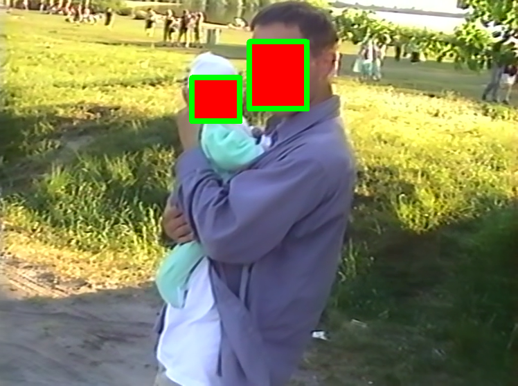

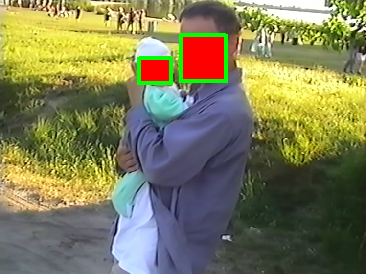

    This image is what finally motivated me to start this thread, even though I've already posted photos of how the taller JVC models are... not cool. The difference is quite drastic. Interestingly, the lower the JVC model, the more detailed the image. From my models, J672>S6850>S7600/7700.
  5. I also agree that the JVC in this example is significantly more blurry - I'd guess with it being that blurry that the picture mode is set to "soft" or something. I don't think I've seen any of my JVC machines be that blurry, so I don't know if that is a good representation or not.

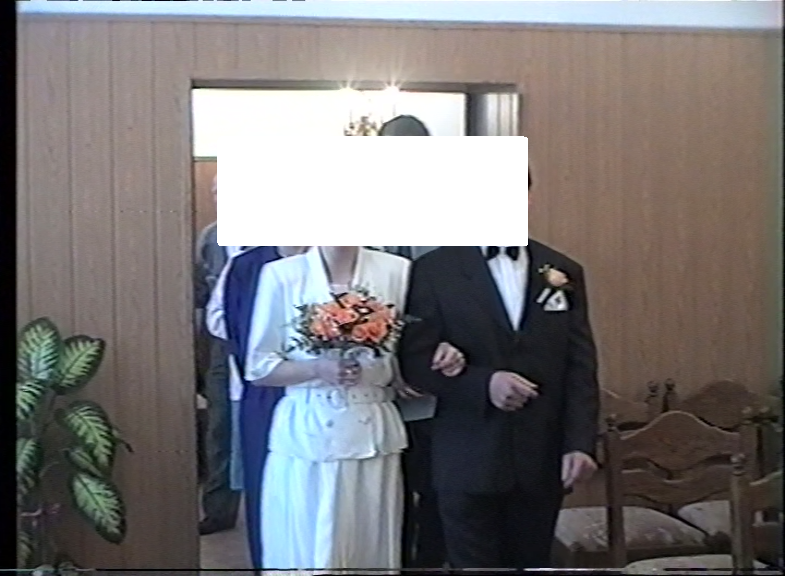

    All JVC screenshots are in Edit mode (or Distinct if they're Philips). Same with Sony.
    It wasn't visible in the previous post, but the Sony tends to blown whites. But I'd need an analog capture to investigate further. Despite that, there's still more details on the Sony.
    (Edit: This time the JVC was also connected via composite)

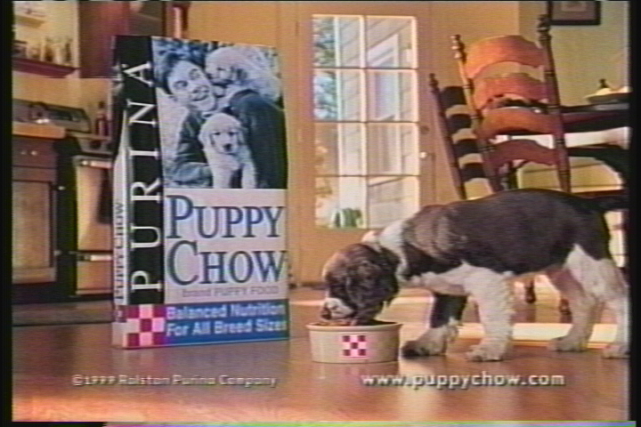

    Condition matters at this point of time, it is almost impossible to do apples to apples comparison if you don't have two machines fresh out of the box. Important information is missing with the comparison, the type of connections used for the VCRs.
    JVC - SVideo / short 0,5m top-shelf Tech+Link cable
    Sony - composite with a random and cheap RCA<->SCART that cost me 2.5 euros in Auchan

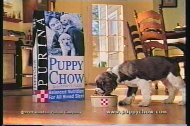

    Yeah there are a lot of variables here at play. But still everybody has different VCRs in different conditions so it feels like you can't exactly make any definitive answers.
    Like in the context of SP Mode tapes, the VCRs I used here offer no big difference in quality, only a small difference in hue and frame positioning.
    First is my JVC SR-VS30U. Second is my Panasonic AG-1980. Cypress CDM-640 was used as an external TBC and a Pinnacle 510 was used as the capture card. Only proc amp adjustment for the TBC was reducing the saturation by -3 (by default it is oversaturated) and for the capture card it was increasing the brightness by +10 and contrast by -18 to capture within the card's legal limits.
    Now LP/EP mode is when the 1980 is better than my JVCs, the quality is better (because the JVCs produce a much softer image with those tape speeds) there is less head switching noise and in the context of mono audio for all modes, the 1980 is better than the JVCs.
    HiFi audio is when the differences I'd say are small enough to where they can be easily matched in post.
    But this all relates to my specific equipment anyway, I've heard the 1980 are generally better at handling LP/EP and mono audio tapes than the JVCs. But imo when you get to SP Mode + HiFi audio is when there is really no clear winner, gets all subjective.

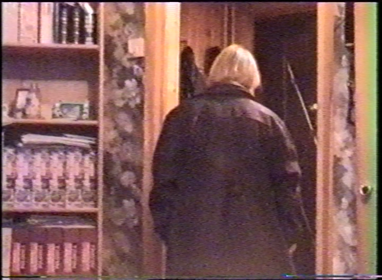

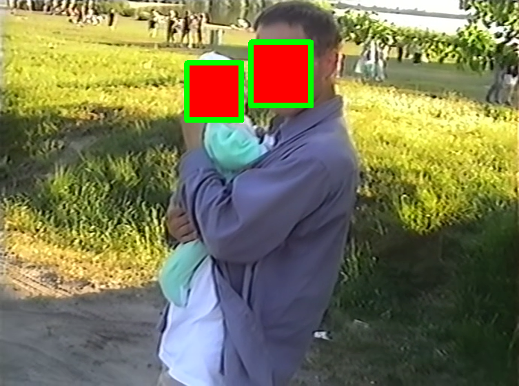

    Some comparison screenshots from JVC, LG and SONY.
    As I always say, it's better to compare what's underneath the noise than the noise itself -- screenshots after (almost) identical processing
    a) screenshots after deinterlacing+denoising (sigma=3, except for the Sony, where I used sigma=4 due to higher noise) + lsfplus.
    [Attachment 91536 - Click to enlarge]
    [Attachment 91537 - Click to enlarge]
    [Attachment 91538 - Click to enlarge]
    [Attachment 91539 - Click to enlarge]
    [Attachment 91540 - Click to enlarge]
    [Attachment 91541 - Click to enlarge]
    b1) JVC showed its strength on a heavily noisy video, where it denoised it quite well.
    [Attachment 91542 - Click to enlarge]
    [Attachment 91543 - Click to enlarge]
    b2) but after denoising (Neat video: JVC strength=40%, Sony strength=80%) it turned out like this:
    [Attachment 91545 - Click to enlarge]
    [Attachment 91546 - Click to enlarge]
    (at least I got here with the right frames )
